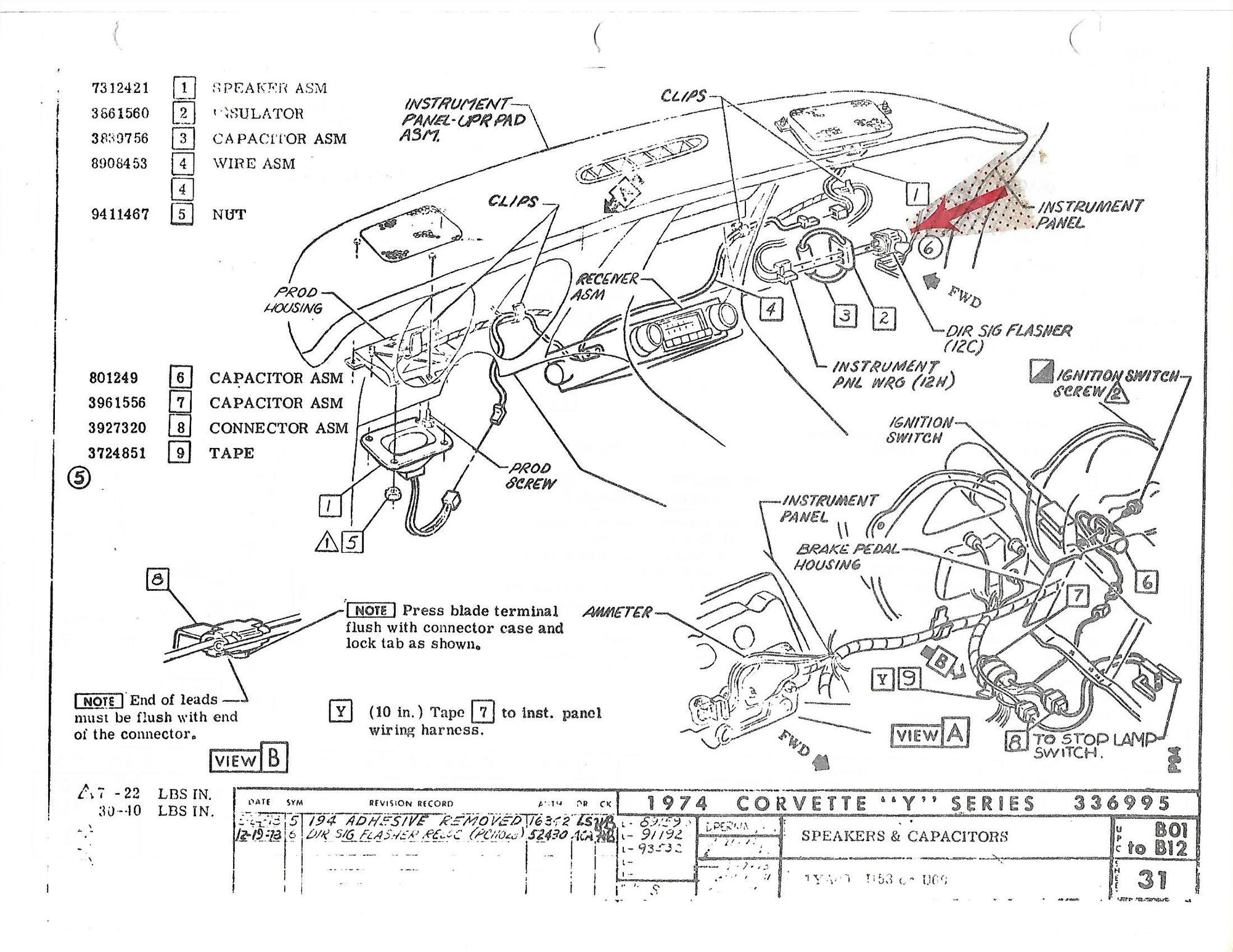

Here's the turn signal flasher:
The flasher in the fuse box is the emergency flasher.

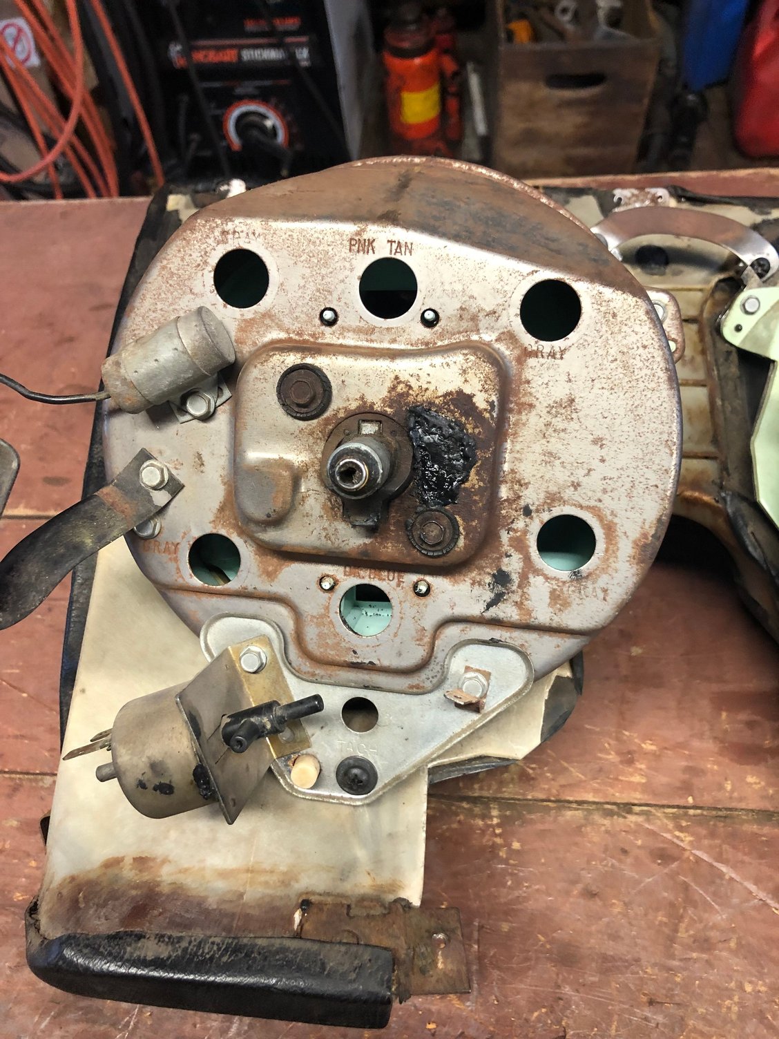

Found a turn signal plug on the upper kick panel on the passenger side put a flasher in there still no turn signals only now with the tail lights on if I put the right hand turn signal on the right hand tail light goes out. Any thoughts?

I would swap out all the lamps (bulbs) for the taillights and forward turn signals...... then test. Yes all the lamps whose function is for braking, turnsignaling, and regular tailamps lightup..... cheap and a lot less hassle before beginning troubleshooting if there are faulty lamps involved.

How do you post a picture on here? I don’t see any way to do it.
OK found a way to post a picture here it is

Yep. Those components are what I said they were.
