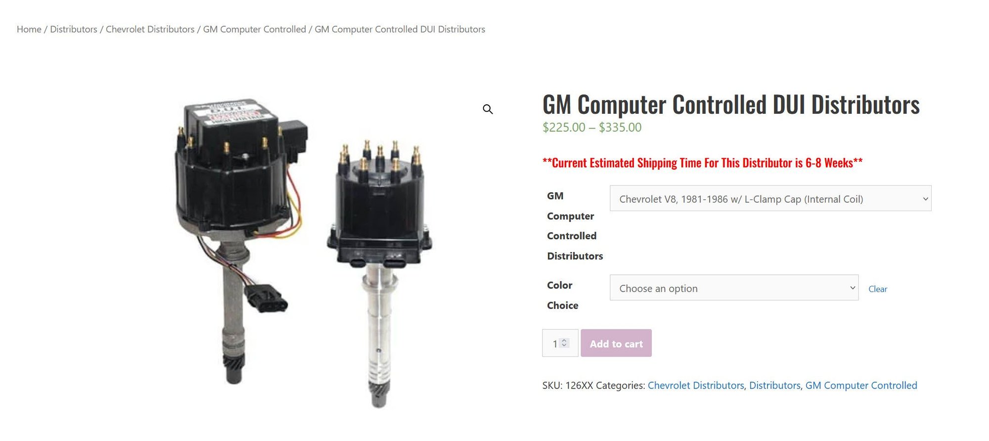

If you are going to replace the distributor which may be causing your issue for sure. Go with a good one. Here is a good choice and it isn't too expensive. GL DUI Dizzy
You want the one on the left "L clamp" Shop around to see if you can find it a little cheaper. I run this same distributor in my 82, works great.
Thank you for the recommendation! I will keep that in mind if/when I go distributor shopping in the future.
