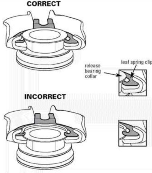

Here's a cutaway pic from the factory manual showing the correct orientation of the clip to the ball stud.
Hopefully this will help.
Also a pic from this forum of end view of fork to throwout bearing.

Thanks so much. I was able to get the clip back in the proper position, so only time will tell! Really appreciate the help!
