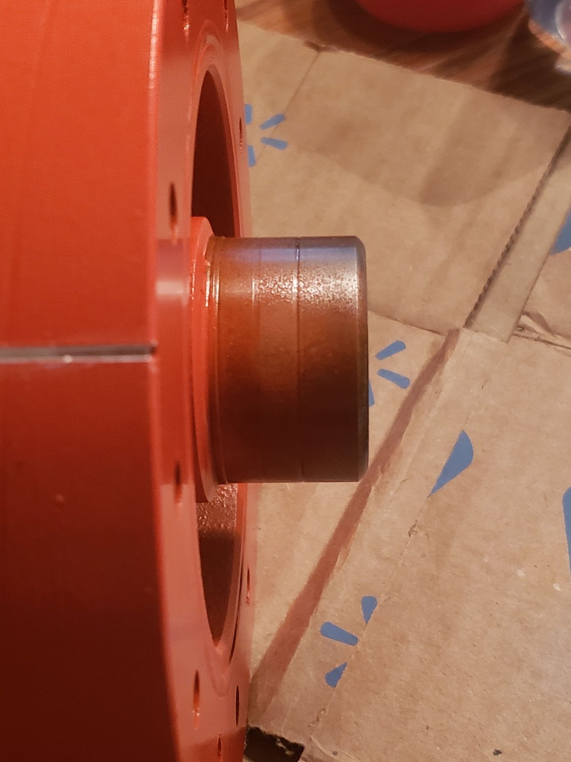

Found at least 1 leak, snout of balancer is grooved. I have a repair sleeve so assuming the zero line is still correct, no problem.
As inexpensive as balancers I would not press a sleeve on it......if it is old enough to have grooves in it then the rubber damper ring is probably petrified, and ready to spin.

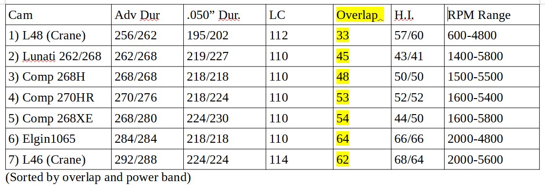

A lot of cams have been mentioned in this thread.
And they are all very good choices, depending....
I thought it might be useful to compare them all, as they cover the full gamut from a stock L48 up to L82/L46 HR street performance.
Very likely everyone will have a different favorite, due to their different preferences.
This is the absolute minimum amount of information that I would want to know if I were going to pick a cam.
Or even if he is going to talk to an expert and have a basic understanding of some of the trade-offs involved.
This is the way we did it in my engine builder & best friends speed shop for 40 years.
Here is the same chart but resorted by gentleness of cam lobe (H.I.)
Terms:
Overlap calculated from adv duration and LC: http://www.wallaceracing.com/overlap-calc.php
Hydraulic Intensity; Difference in Advertised vs .050” duration
Advertised Duration: typically at .004” lift, but not for old GM specs, L48 & L46 Specs from Crane “equivalents” cams
Method of determining basic engine range is to use .050” duration numbers: Advertised duration numbers have more effect on overlap and scavenging effects than breathing
Overlap either increases or limits breathing by the scavenging effect. More overlap increases scavenging, typically works better at high rpm, can increase volumetric efficiency, lowers vacuum and TQ at low rpm by increasing low speed reversion
Hydraulic Intensity is Lobe Steepness or Aggressiveness, or Cam Profile Intensity. At any Given .050” duration, less advertised duration increases both TQ and HP by decreasing the advertised duration. Sounds backwards, but it traps more gases in the cylinder. It increases V.E. and reduces overlap, and increases idle vac. And low rpm behavior. But these shorter H.I cams have steeper ramps or cam lobes, and the steeper they are, the more break-in and longevity problems they have, unless rollers are used. The old school long lived flat tappets from GM approach 70* H.I. and have very gentle and long living cam lobes, and get by with softer springs. Most solid rollers are 40* H.I. and that is how they gain extra power, by throwing the valve open/shut quickly. Short H.I. cam profiles also need much stiffer valve springs.
Suggested RPM Range is as suggested by Mfg.

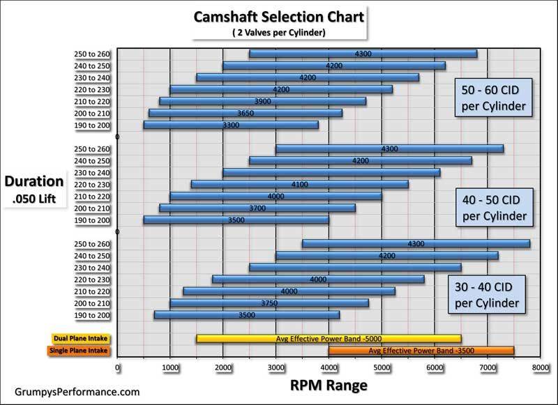

Cam selection Recommendations:
Step 1- Duration Chart
This chart from Grumpy Jenkins Performance makes it easy to select a cam’s .050” duration based on what your rpm boundaries you prefer, and also considers your engine size. The lower end is where the reversion is great and the engine begins it’s power curve. The upper end is peak HP rpm. And this varies significantly by engine size. This will typically match mfgrs recommendations, but they almost always assume a 350cu in engine size for a SBC. With the proliferation of stroker motors these days I find this chart very handy to check.

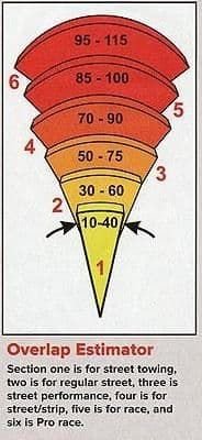

Step 2 - Overlap chart
This chart helps you rough recommendations for overlap based on intended use.
Once you pick the rpm range (duration) you want, you can vary the overlap to balance your desired high rpm scavenging and low rpm reversion preferences. Both adv duration and lobe center effect this one.

Looking at it this way the L79 had 224/224 dur @ .050"
The LT-1 was just slightly bigger at 229/237*
And the 302 DZ / 63 Fuelie cam was 237/237*
Old Jan 17, 2024 | 11:21 AM
  #37
leigh1322's Avatar
leigh1322
Old Pro Solo Guy
Posts: 8,095
Likes: 4,449
From: Marlton NJ
GM only made two basic cams in this range:
  • The 300HP L48 / 929 cam at 195 dur
  • And the pair of 221/224 dur L46/L82 cams, the 151 and the 962. Pretty close to being the same cam. The 350HP cam. So 50+ HP stronger.
I would never run anything on a stock L48 short block as big as the L46/L82 cams.
They need a little more CR ratio to work well, those cams would bleed off some cyl pressure from the already low 71+ L48s, and would be "soggy" down low.
That is where the aftermarket came up with their in-between 218 cam, the original 268H, and manipulated the rest of the valve events to help trap cylinder pressure and increase TQ/power on the low 8.2 CR ratio engines. It works so well it is like adding a point of CR.
It works better on an L48 than the L82 cam. Like Jebby worded it: "It just works"
The mentioned 270HR cam has very similar specs, just in a HR format.
These are two extremely good choices for an L48 upgrade.
Do not run one of these two cams on an 11:1 CR engine. It's too much. We tried it, ....once. It only stayed in 4 days.

I went with the xe270hr because it was one of the few cams in my list that actually helped me keep a healthy DCR if I remember right without detonation risk. Maybe I had something wrong?
Since I had 10 to 1 compression already (and iron heads at the time) and want to be able to stick with 91.. I have 1.6RR which is why the numbers are effected below. I know its very hard to see the white text fields. Sorry. Anyway I found this free desktop dyno tool to be good for comparison regardless of how optimistic the numbers are since they are still based off the math. My buddy is running my old lunati cam in his 64 impalas 327 now... It had only about 1800 miles on it but still looked new as far as the lobes. YMMV I always used zinc back then as well as the springs lunati recommended.
