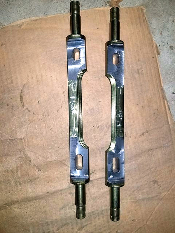

I machined my A-Arm slots longer to be able to get around 6 degree of castor. They also sell the offset AA cross bars. I've just used the poly bushing for years and you are right the air chisel ruins them.
The hole is longer and removing the red area material gives you more thread for the shims. I run about 6 caster, Zero toe, and .56 neg camber for my 295 width front racing tires

You are a talented machinist . I am not.
The offset bushing, properly installed in the control arm will hopefully help get more than the 3 degrees I have now.
You touched on something I was considering. Longer studs. My friend recommended longer hardened wheel studs. Question: Does anyone know of a racing wheel stub that would be longer and a direct replacement and longer than stock??
