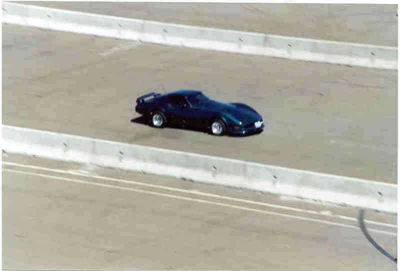

My advice is to get online and find out what old race cars are for sale. I've seen real just roller fully caged C-3 vettes with log books of racing history for $5 - 15 K. My friend years ago found a real Gt1 72 vette raced through the 70's with a blown 496 ci. that had been parked next to a barn for 25 years.
There are so many cars out there that are fun, fast , and cheap. I spent a lot to race my vette and when I collected debris on the track and took out my front end it really soured me for the last time. My buddy owns a nationals SCCA winning 72 240 Z E class that has set some class track records around the USA. He competes in historic racing and SCCA.
It's not cheap to roll cage a vette. Then I have a $15 motor, $5k tranny, 5k rear end assembly, $5k in brakes. and then add sets of wheels I was buying sets of 8 slicks at a time because they only last a couple of hours on the track each set. The fiber seats, belts and fire system and I ran a 4 quart accusump system to keep oil pressure in the turns even with the best 8 quart road racing pan which took up the passenger side. All without a sponcer other than Tire Rack after winning a VP3 championship in SCCA. I bought a light weight 81 twin turbo front end to help get down to the 3000 lbs min class weight with driver.
My other friend picked up a C6 ZR1 for $40K and had a shop roll cage and fire system it and does the T1 racing with something like 650 hp with just a tune and long tube headers. Street legal and really fast.
Racing at temporary Trans Am road racing weekend course in Reno Nevada in the 90's
GT1 Wilwood brakes with 3 inch air ducking
