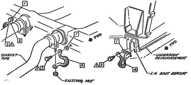

Can anybody tell me why my 69 has ground straps on the exhaust clamps?

Here is an image from the 1969 AIM showing grounds.
