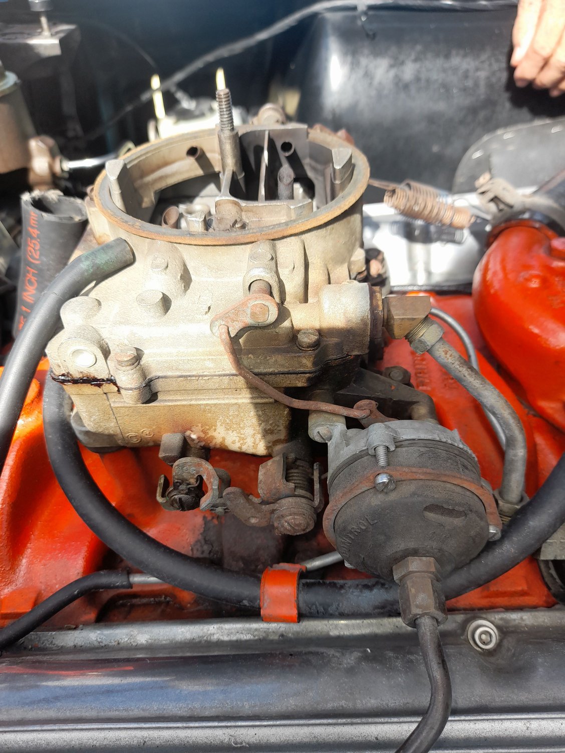

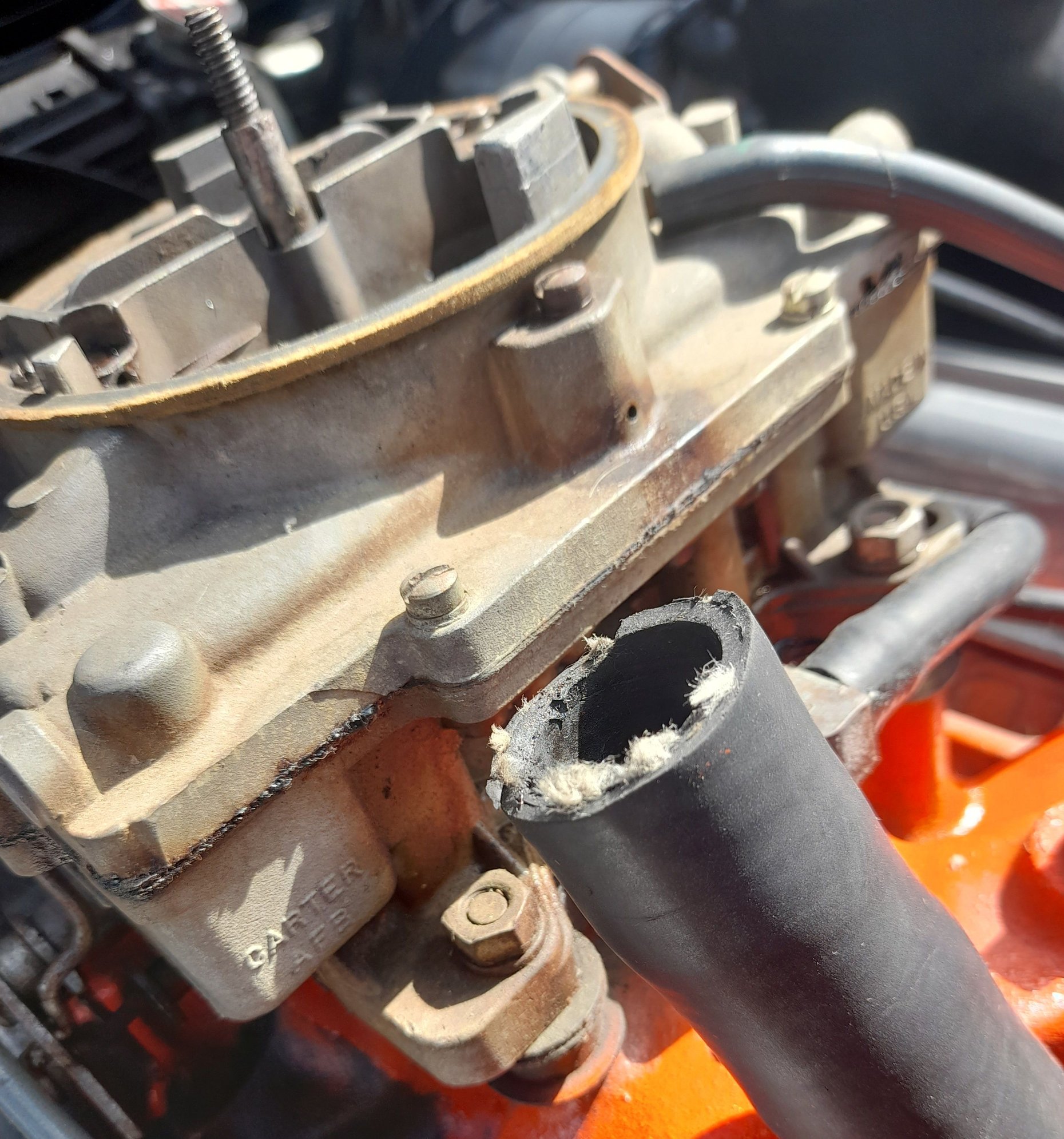

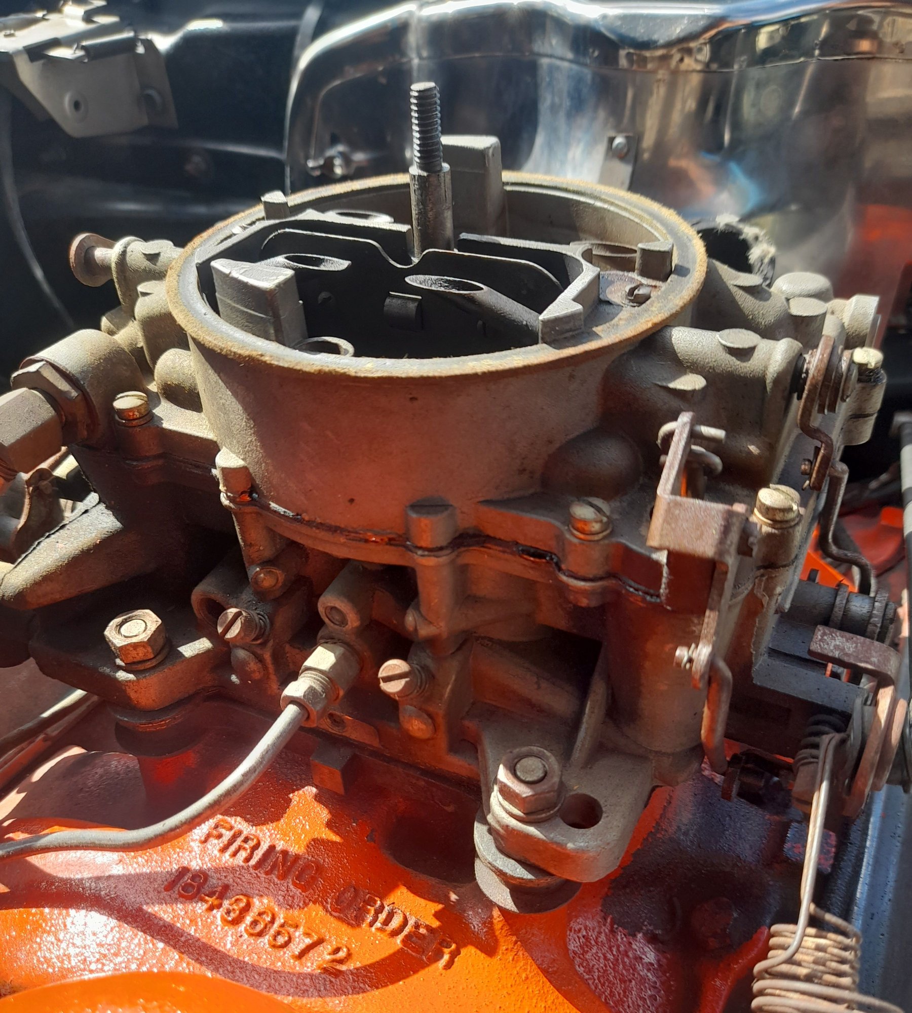

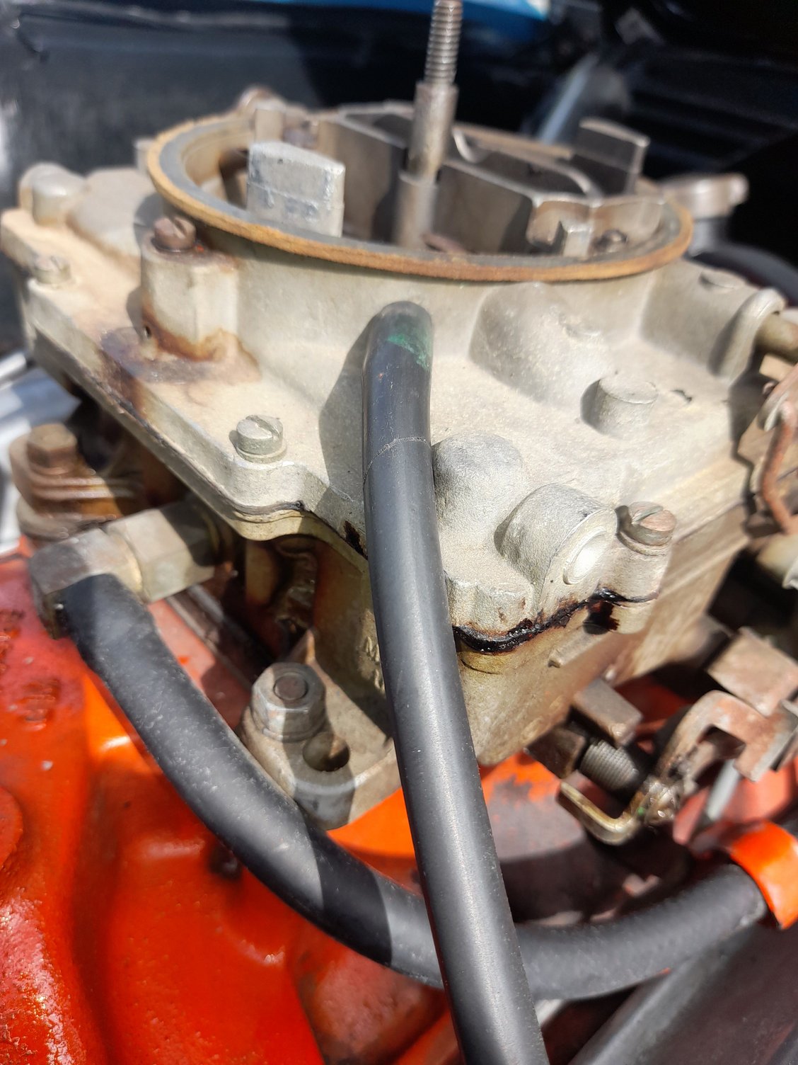

Have a few questions about this carburetor. I know this is in the wrong forum to a degree. This is on a 65 327 convertible Corvette. But I'm a C3 guy wishing to help out a member of my car club.
The car isn't NCRS. But it's close from what I can see.
​​​ Here are pic's of his Carb.
Hopefully Lars or others will know what we are looking at here. The gentleman who owns the car is getting up there in years and working on the car has gotten very difficult for him. He can still drive just fine however. The car was recently repainted, and looks fantastic. However the process from start to finish took nearly 2 years. All this sitting hasn't been kind to the carburetor and it's running but poorly.
My questions are.
1. Is this the original carburetor?
2. If not, what is it from?
3. Where to get a quality gasket/ seal, rebuild kit for it?
4. Any tips at all on getting it setup again? Float level? Anything else I should know?
Thanks much for any help. I'd really like to help the guy out.

reversion going on, black soot in carb.
timing I think.
carter afb does not compute on a gm car to me but ,,,,
I think ford and chrysler.
Sorry.
Do you know anything about manifold? any cast in numbers?
Someone with more skillz will know whats up.

I haven't touched anything yet. He said his son got it running for him after the reassembly of all the trim and carpets, etc. After paint. Then his Son moved away. I figured I would indeed check the distributor, check advance, vac can performance, setup points, dwell, timing, etc. Those things I can do in my sleep. This carburetor I know nothing about. Car is clearly running rich on start up. Thinking carb could use a good clean after sitting so long. Don't wish to order anything until I know what I'm working with.

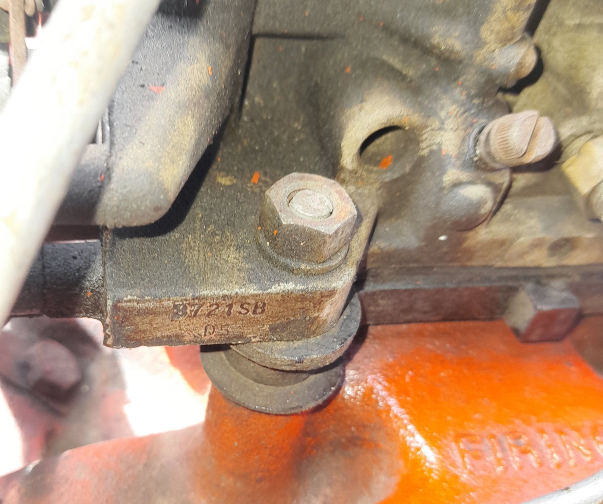

3721SB pops up as OEM for 62-65 vette, 300 HP 4 spd
link for parts & diagrams:
https://www.carburetion.com/CarbNumb...?Number=3721SB
looks very much like a current Edelbrock AVS
Found this on C2 forum
AFB 3721 KitI used a NAPA/Echlin # 2-5424A and it had everything needed ++++.
Edit: looks like the current NAPA # is CRB25424A. Just under $30 locally.
Kits seem to be readily available online. it was a very popular carb
Perhaps someone on C2 would be willing to scan the carb section of the shop manual for you?

Thanks Leigh. Yup, sounds like his car. 65 327 4 speed.
beautiful car. Now if we can get her to run as good as she looks.
