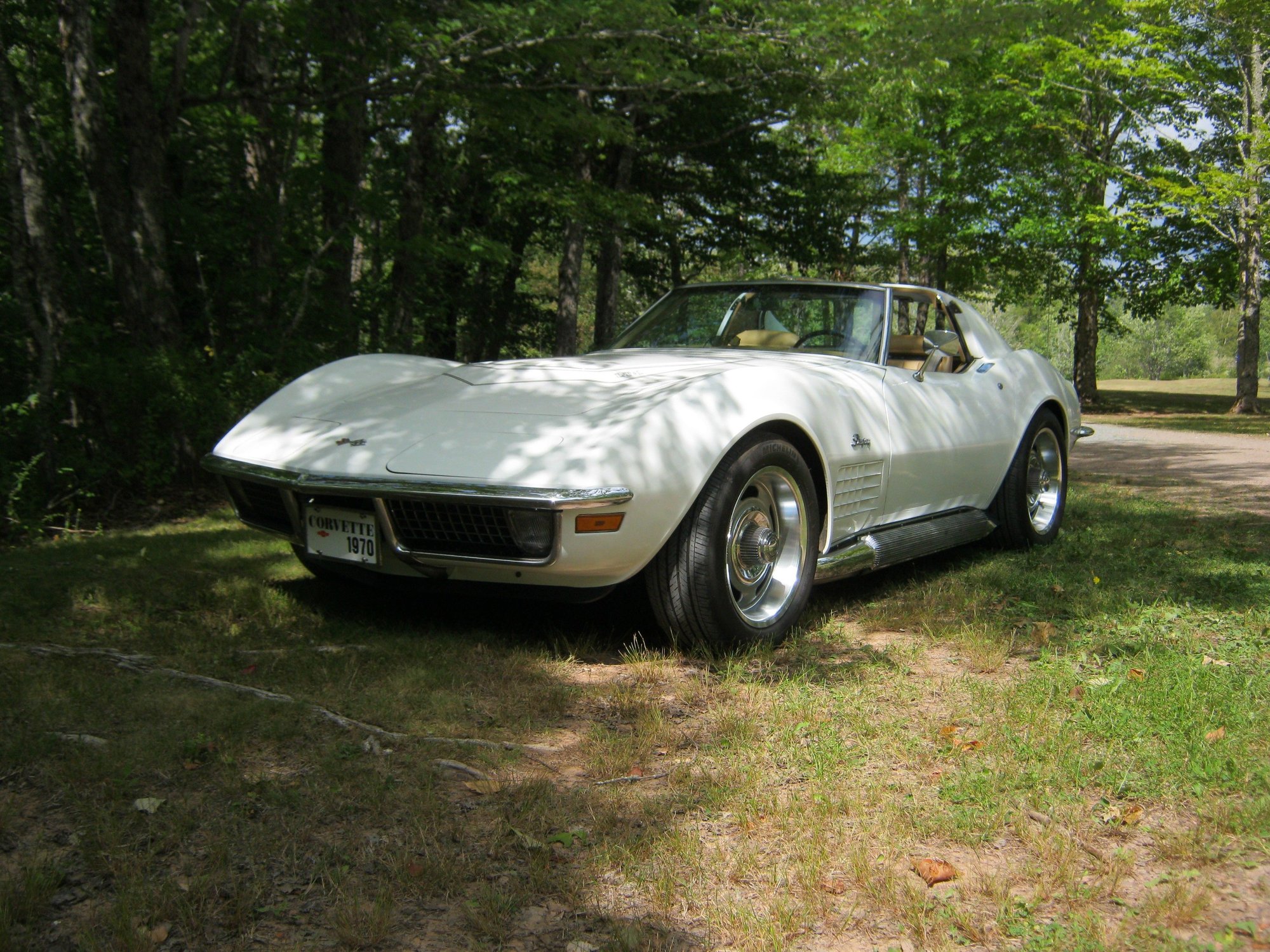

I have a 1970 with 235/50-17, on 8” wide with 4” back space wheel. The e brake is in original location and no rubbing whatsoever. I recommend Michelin Pilot Sports PS2 (N1) the tire has a tread ware rate of 220. When I changed from a BFG TA to the Michelin it was very noticeable difference in handling IMHO.
Bob

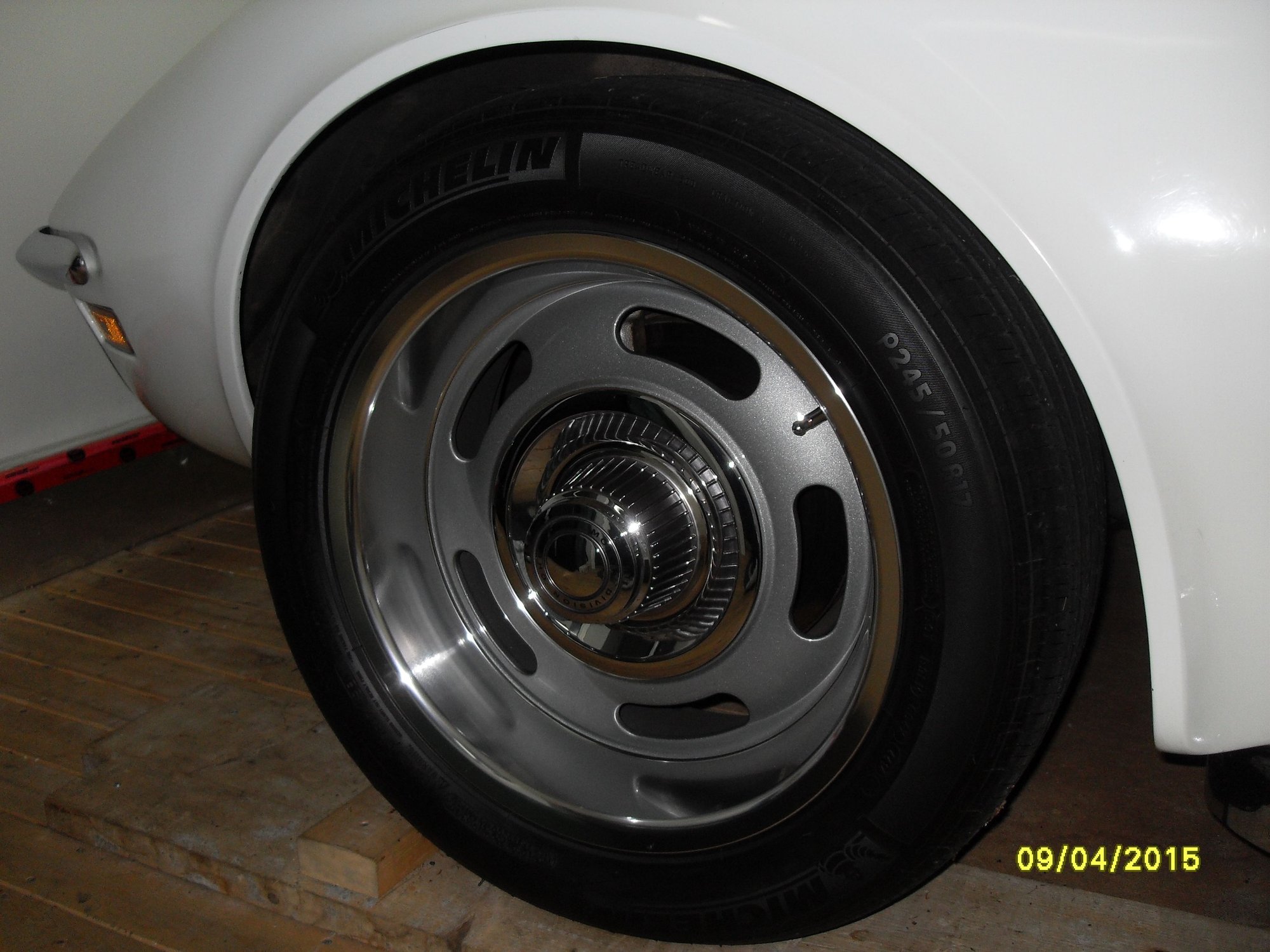

245/50-17 (Michelin) on 17 x 8 Rally Wheels, 4.5" BS, 1/2" Spacers, ARP wheel studs.
No rubs or interference.

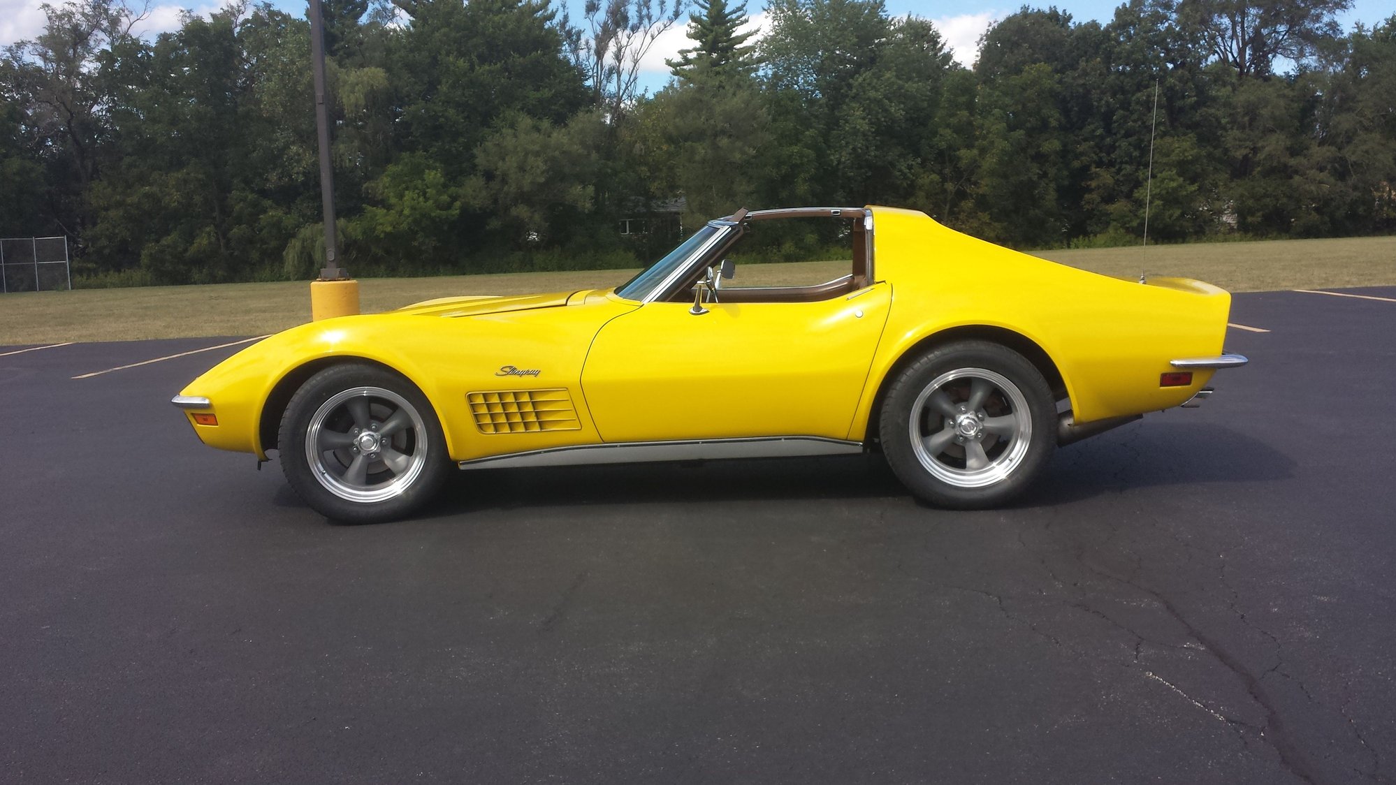

255/50/17. TT II. 17" x 8", 4.07" backspace. Slight rub at full lock therefore, I don't go full lock. Stock e-brake location. No adapters at all, directly bolted to hubs.
