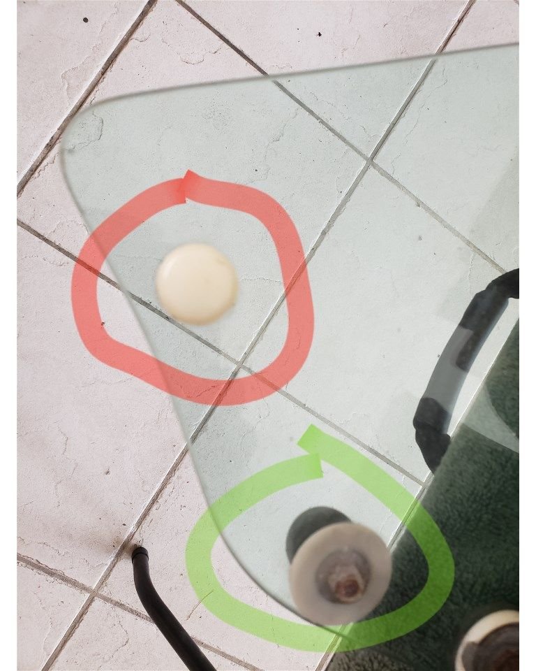

Dave, the window mechanisms and rollers can get a little convoluted if you're putting them back together from bare glass. The hole nearest the front holds a bumper (circled below in red) which does not roll, second hole is for the first actual "roller" (circled below in green), third hole is the track mount. All as shown in the schematic above.
Is there a chance that you may have the "bumper" installed in the "roller" hole? If so, it will not r
"roll". If you do have the correct roller in place and it will not roll, this is usually due to the old factory grease having hardened inside the roller. I have come across this on almost every window I've done. Give it a good soak in degreaser over night and it should loosen up.

Thanks Greg,
It appears I was sent the wrong part, which still doesn't explain the non-rolling issue. I've ordered a set from Corvette Central now, and they label it as "68-77 Door Glass Lift Track Rebuild" which includes the roller. Hopefully this new roller will roll.
My car is a '73, and maybe the first part I got was for a later year C3. Again, that still doesn't explain the non-rolling bit. It could be a manfacturing defect I suppose.

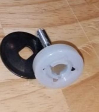

This is the roller. The white roller should spin on the metal shaft. Might be tight, but that's the spot that needs to spin. If its real tight, try spraying it with some PB Blaster.

An update: I have four rollers, two for the front (L and R) and two for the back (L and R), and of the four I found one that after some penetrating oil and exercising could be said to "roll" if I use that term loosely. The other three will rotate on their shafts given enough force, but I certainly wouldn't call them rollers. Am I experiencing the joys of aftermarket parts?
