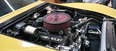

So you said you bought a 75 to save money what year is your fav and what got you into cars at such a young age , for me it was the neighbor 3 houses down he had a 65 396 425 hp and I was hooked I was only 12 years old . I have a 434 650 hp t56 6 speed

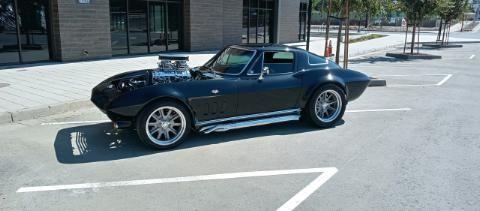

I knew you had gotten the bug from somewhere I think your heading in the right direction I would can the auto trans and do the t56 6 speed you will love it and then just do headers and a cam with a intake and enjoy a little at a time but make sure what ever you do be careful and learn as you go , this forum has a wealth of knowledge on here and most are willing to help and here'
s my other toy .
could you in detail explain to all of us how and what you have to get 650 hp out of a 434 small block? Like heads, roller cam specs, max rpm, header type....

Dart shp block scat crank and rods AFR 220 heads 10.7 to 1 compression cam is a roller comp cams 253/261 duration at 50 598/583 lift 110 lobe center team G intake it's the short one they have to fit under my hood and a Holley xp 950 and dougs header side pipes with a msd ignition 652 hp at I think it was 6500 rpm I would have to pull my dyno sheet but if you go on skip whites web site its their number 1 cam and the they added flat top piston the I went to chassis dyno and at 5000 rpm made a little over 500 at the wheels . and I have vintage ac to boot works great and no oil leaks zero nada and my crank case evac is through the exhaust .
