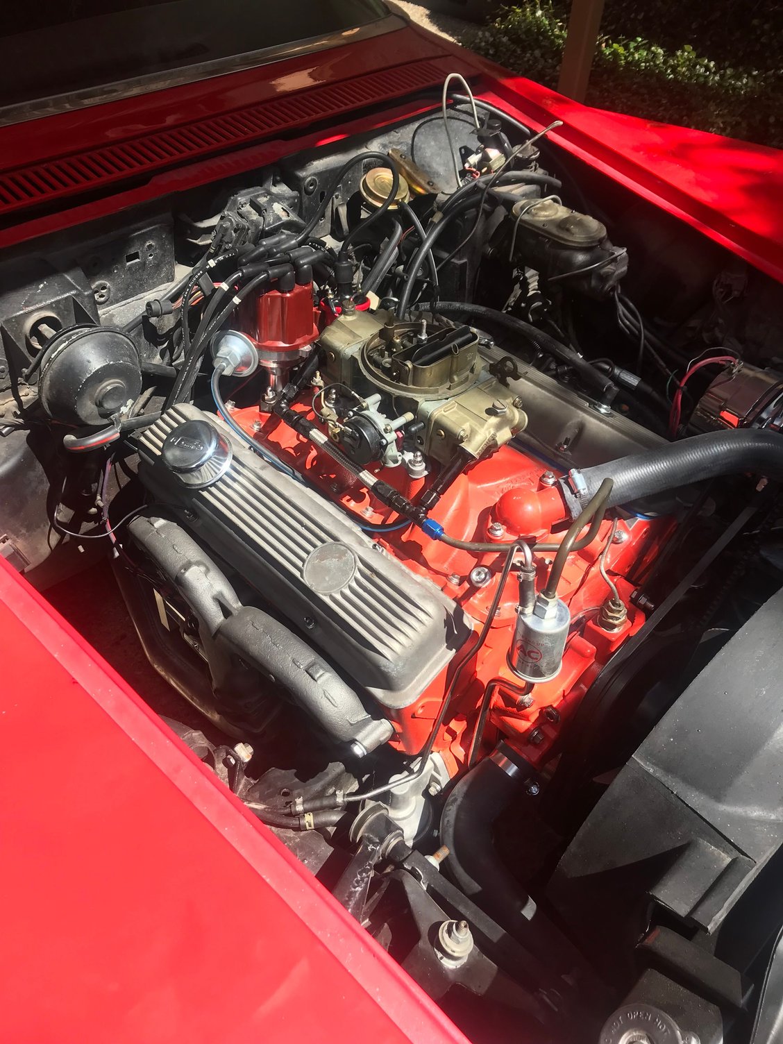

Where does the engine end of the line connect to?
427 with three deuces

Does your mechanical fuel pump have three holes? One is input from the tank, one is output to the carb, and one is the return line.

Tri-Power did not have a return line.....

Thanks for your input guys, Was reading post about Hard starting when the engine was hot. One of the Problems was vapor lock, and the fuel return line helped solve that, Noticing I have a fuel return line was looking to prevent future problem!

the 427 3x2 motors did not have return lines from the factory, so if you want to use one, probably the easiest way would be to find a suitable fuel pump with a return line port

Holley equipped cars did not get them......probably because they required more flow and are fine to run dead head......and GM saved some money......
But if you want one.....a real easy way is the GF-432 AC Delco filter for L46 350/350 application.....just cut and flare your line to it.......the 180 degree hard return line is available through Vette vendors.....it is closer to the carb too.....

They were only used on Quadrajet applications to prevent vapor lock. Holley fuel bowls are separated from main body by two gaskets, metering block and float bowl so heat transfer from main body would be less than Quadrajet design where fuel is stored in main body.

I did this as it was the same as the factory L-46 setup.......the bottom line to the pump is in fact a repo so is the return from filter to return line.......when this is constantly cycling fuel through it....it doesn't get as hot as you would think.....a little hotter than the gas in the tank.....not much.....it can be wrapped too.....the L-46 did not have a Holley so I made one that would be a look alike for Holley......no problems in our heat last year......the front bowl is actually what gets hot......more than anything......but not much you can do short of putting a ridiculous shield in front of it....but I also recommend to all Texan's with C3'd to remove the inner fender dust covers so air has another place to go.....
My L-88 Air Chamber hood on my 72' is definitely helpful.....I don't have it sealed but the air filter is up in the chamber......

My dads 69' 427/390hp has the return line. It comes out of the fuel filter and returns back to the line on the frame.
I think it is a q-jet thing why they have them.
I say that your car had to come oem with the AC Delco 2 output and one input fuel pump with the return line to the tank. Good hearing from you again!
The 68 427/390 has the return line off the "big" filter that attaches to the smog pump bracket. A lot of folks who discarded the smog pump just have the filter hanging there. The fuel pump has an inlet hose that then has a hard line going to the filter and an outlet line going to the carburetor. The vapor line makes a complete 180* turn and goes back down to the main line near the fuel pump. Some of the vendors have great pictures of the line setup (Doc Rebuild for one.)
Q-Jet cars got the return line,..Holley cars didn't. The fuel return line was used to prevent vapor lock. This return line allows the fuel to circulate in a loop to prevent vapor lock. I'm guessing that since Holleys moved more fuel, perhaps VL wasn't a problem,..but don't know.
On the other frame rail, 1970+ cars had the EVAP line than ran from the fuel tank and eventually to the carb. This line didn't carry fuel,..only fumes from venting the tank.
This filter was only used on corvettes in 1968 and 1969 (It was also used in Camaros, maybe other chevys of similar years). In 1970 and later the fuel return line came right off the fuel pump. So a 1968/69 fuel pump only has one outlet, while a 1970 and later fuel pump has 2 outlets.
