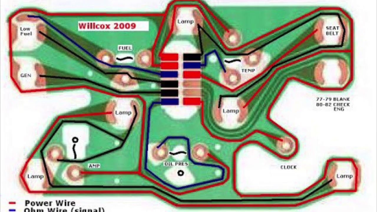

There were probably better diagrams online before Willcox Corvette went out of business. This is for the center gauge cluster circuit board, but it has a similar connector to the tach/speedo circuit board, and operates the same, with bayonet mounted lights and a glitchy connector.

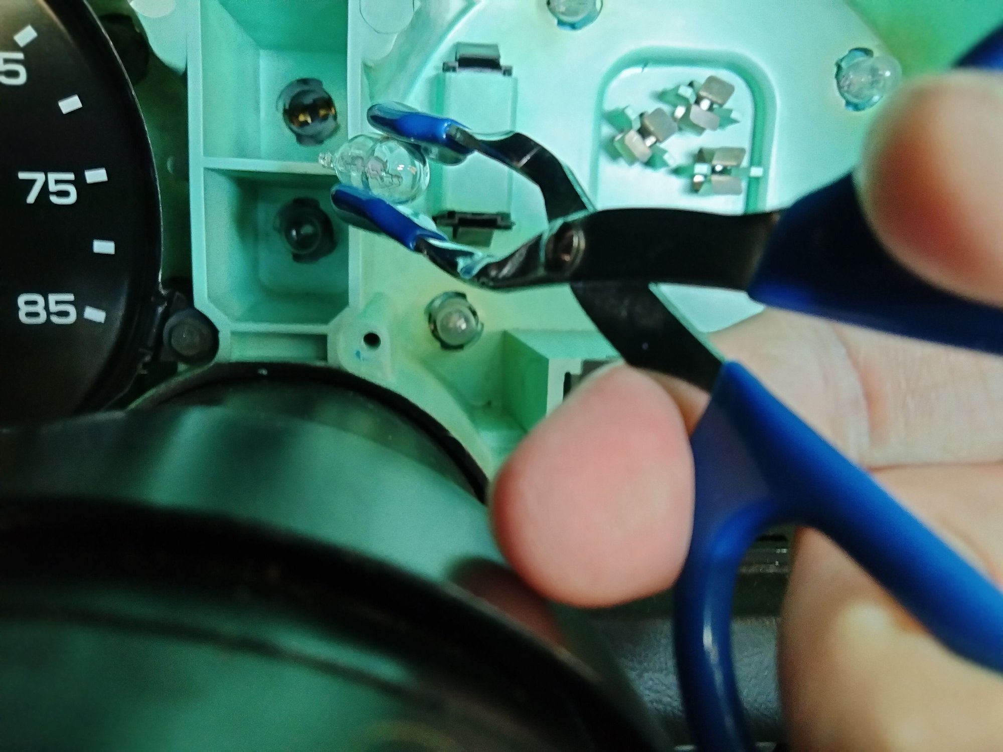

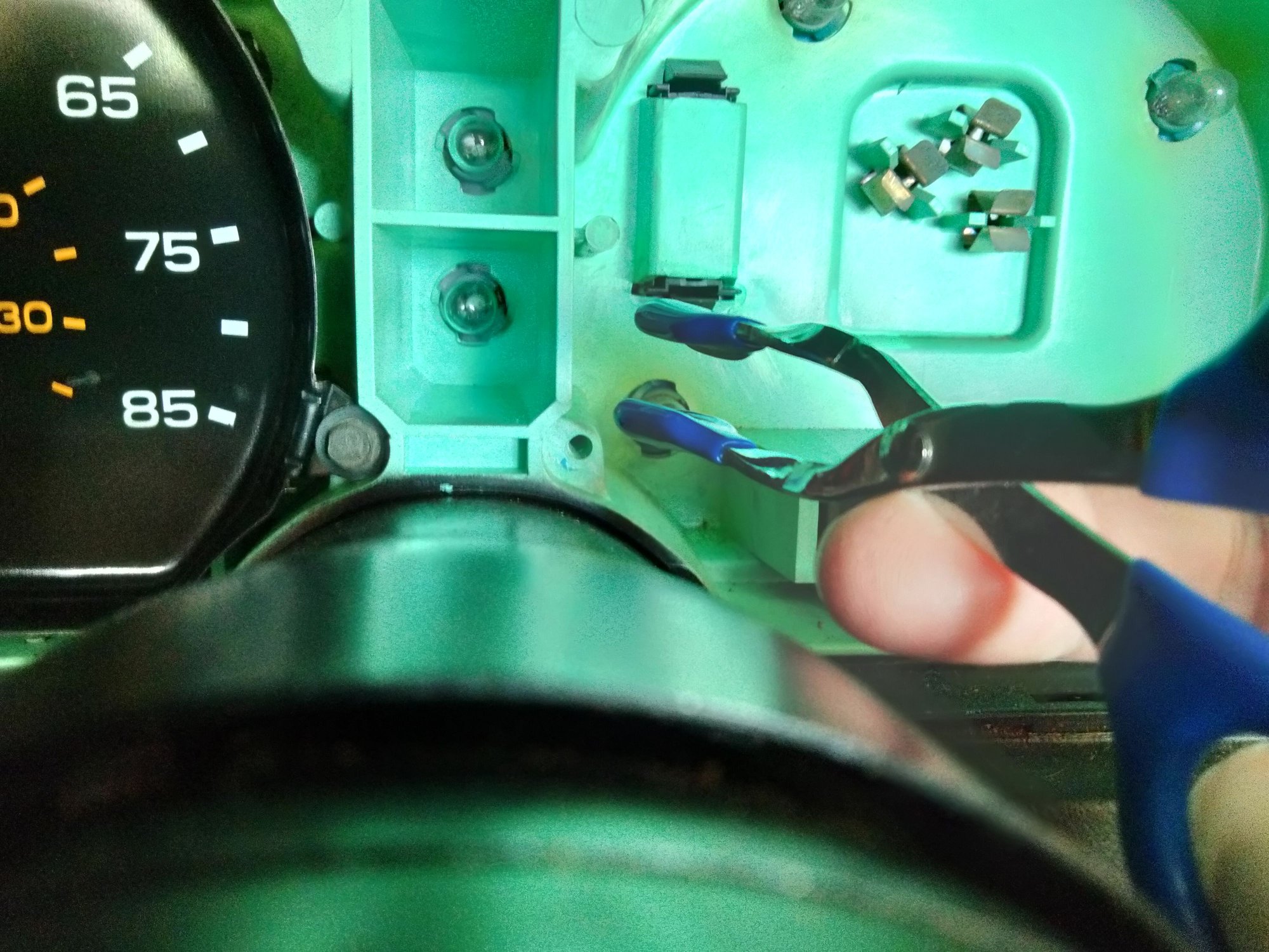

I'll try reaching the connector today. I used a bulb puller because I didn't pull the dash cluster. The bulbs pull right out of you can reach them, but the space is too tight for fingers . I read where another person used a pair of needle nosed pliers to remove and replace but I was afraid I might crush them. So, I used a bulb puller.
Old Mar 10, 2024 | 08:51 AM
Bikespace's Avatar
Bikespace
Joined: Mar 2017
Posts: 11,953
Likes: 4,509

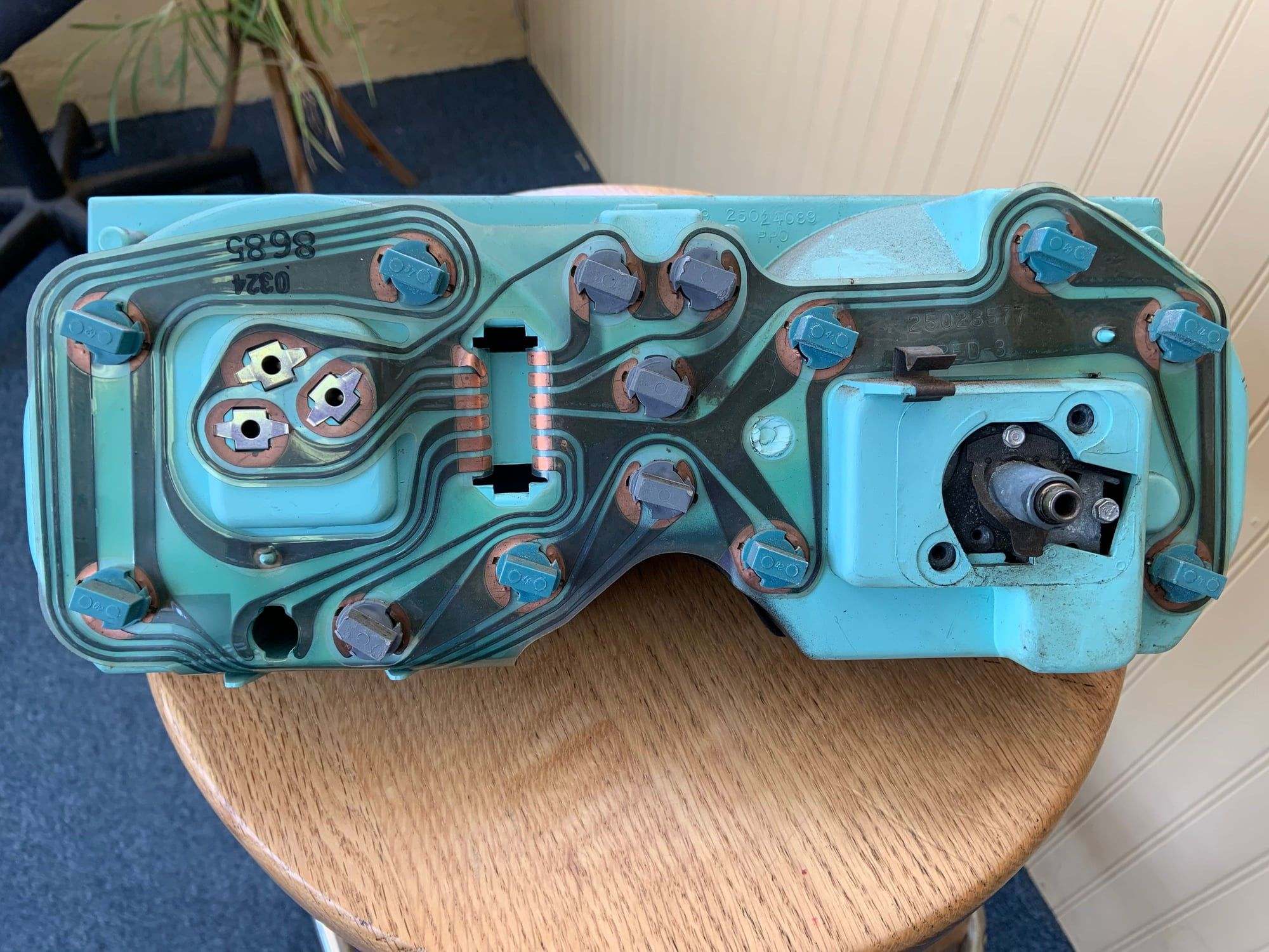

How did you reinsert them? You need to turn them 90 degrees (perhaps 120 degrees) to get them to engage with the socket, and to make contact on the circuit board. I don't see how you can do that with pliers, or a bulb puller, unless the cluster is on a bench.
Can you post a photo?
This thread shows the back of the cluster.
https://www.corvetteforum.com/forums...h-cluster.html
The photo even shows one of the possible failures, as one of the tabs on the connector is bent, possibly causing a short.

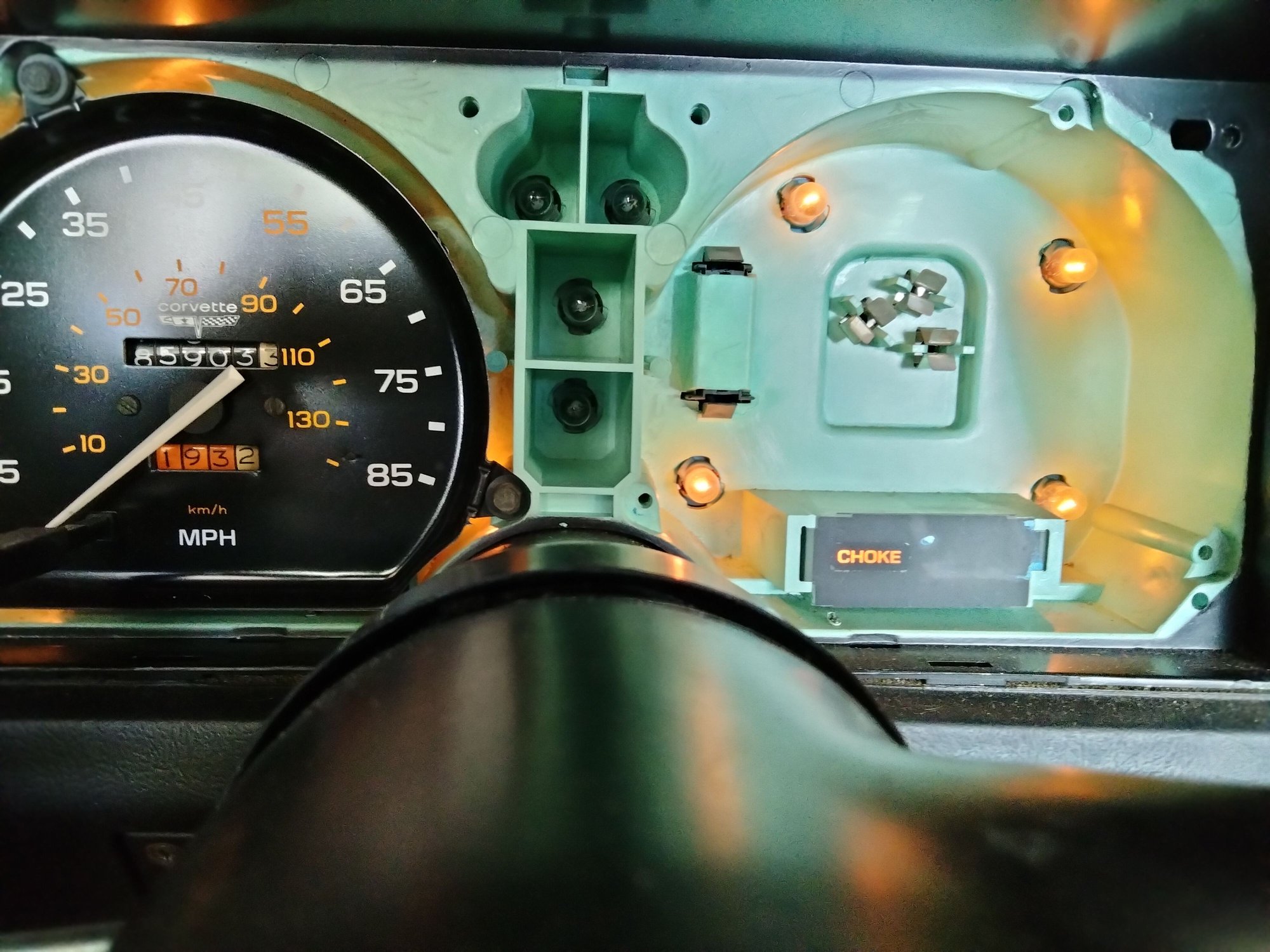

Old Mar 10, 2024 | 04:44 PM
Armchairexplorer's Avatar
Armchairexplorer
Joined: Feb 2024
Posts: 45
Here are a couple of pictures that show how I removed the bulbs and replaced them notice in the second picture that the tachometer and speedometer lights are shining but the center lights do not work.

Old Mar 10, 2024 | 05:38 PM
Bikespace's Avatar
Bikespace
Joined: Mar 2017
Posts: 11,953
Likes: 4,509
You should pick up a shop manual. I have never seen anyone replace bulbs that way. Always from the back.
There's a ring that you press while pulling the speedo cable. Easier to feel than describe. You can see the ring, and the tab at the bottom, in the photo above.
