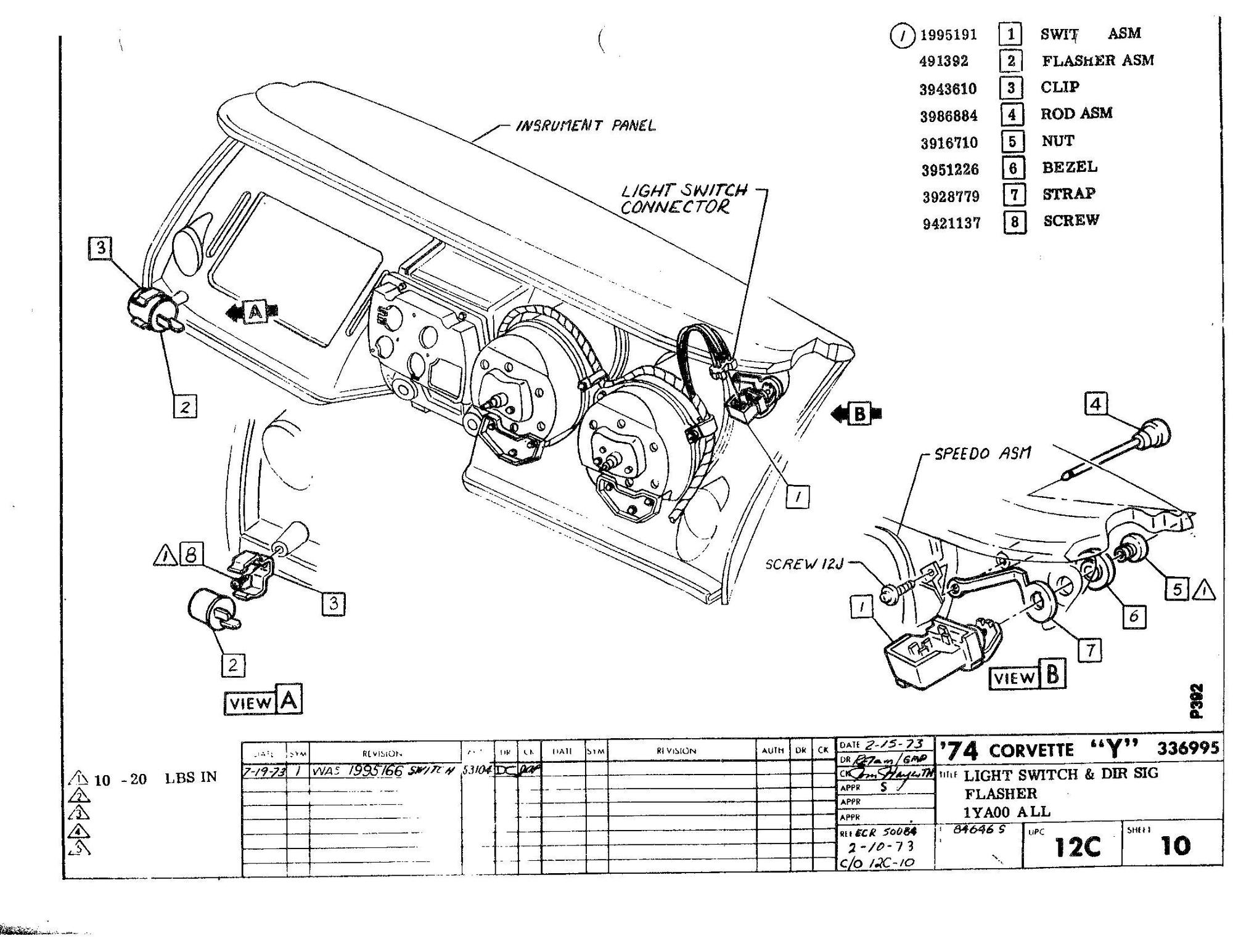

Remove the two bolts that hold the steering wheel to the bottom of the dash, let the steering column come down an inch or two, secure it with longer bolts but don't force it down or you can damage the column.
Remove the speedo and tach bezel screws and pull it out just enough to reach the headlight switch. be mindful of the duct work.

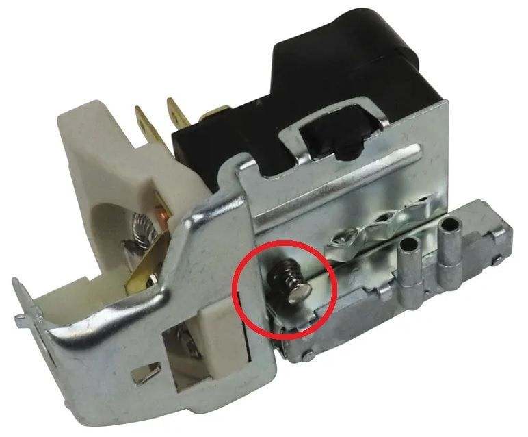

You only need to push the headlight button to remove the K ***. (#4)
Here's the button.
Now you can remove the switch.

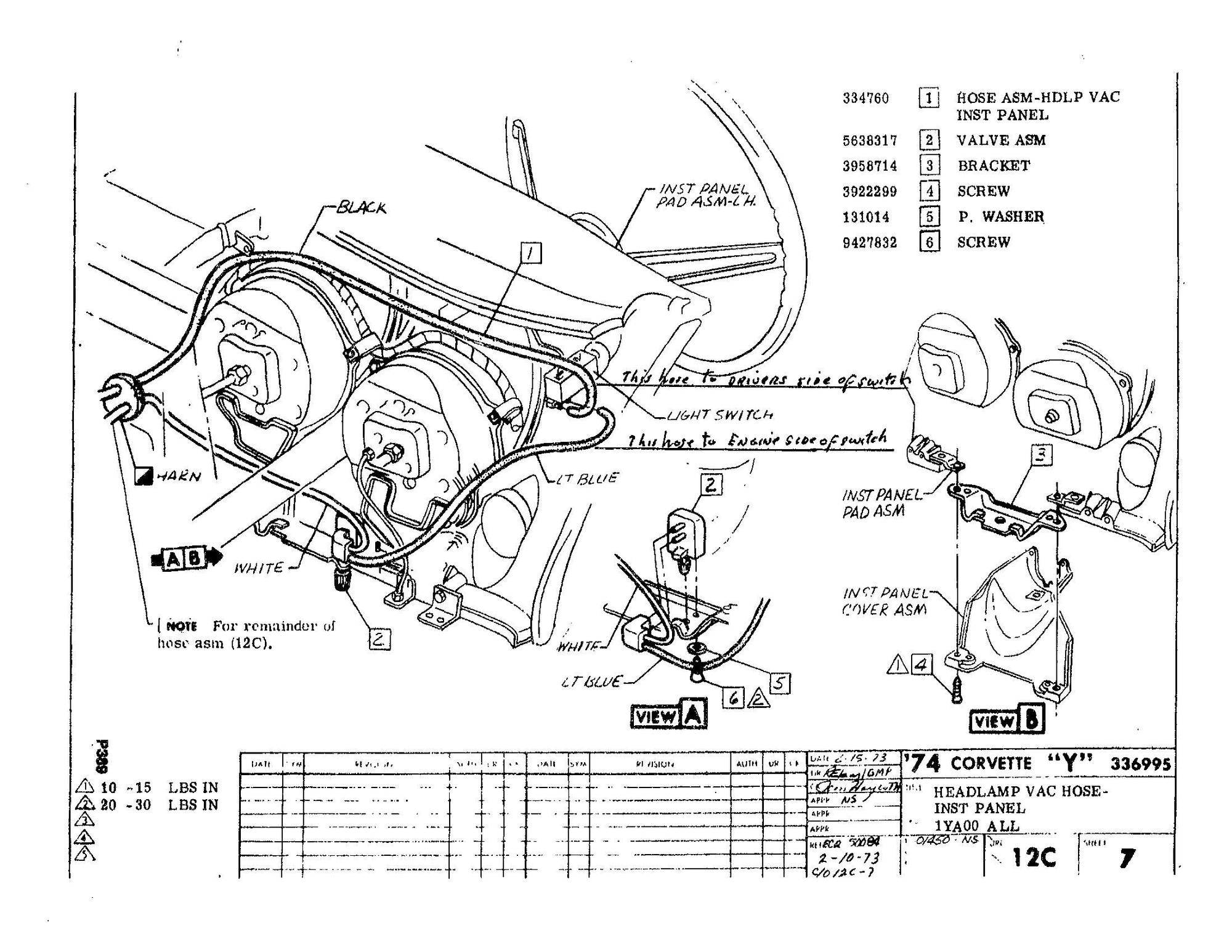

Replace the switch and connect the vacuum hoses.
Hope this helps.
