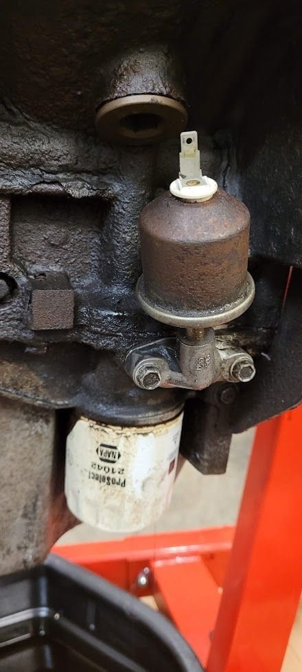

Did you check that it's plugged into the sender?
I'm not sure if it's behind the distributor (likely), or by the oil filter (less likely, but possible), but the sender looks like this (this is a test on an LS engine, your engine will not look like this).
The other option is that the flexible circuit board behind your gauges needs to be adjusted or replaced. Try wiggling it, if you can reach behind your gauge cluster.

by dist on top.
To Oil Pressure Gauge
