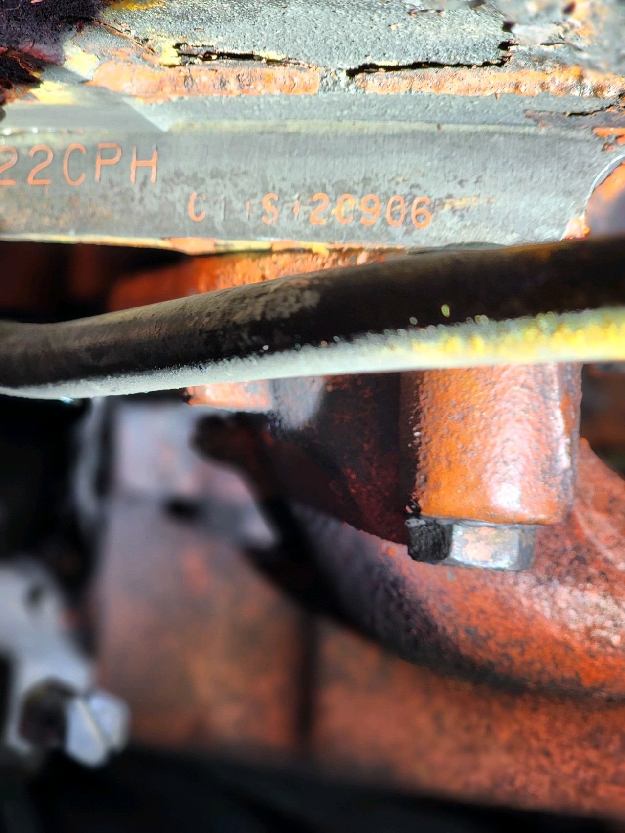

Looking at a 1971 project. The vin indicates a late 71 build sequence; 20797. The engine is the correct model CPH (454/365 manual) but the id number is 20906..... Any ideas? Thanks!

Looks like the block came out of VIN 20906.
Shoot a pic of the pad.
Understood. Just curious as to why an engine several vins from the original would be in that car?
Old Feb 10, 2024 | 04:01 PM
69L88's Avatar
69L88
Posts: 3,382
Likes: 1,801
From: Apple Valley, MN
Coincidence, I would suspect. Highly doubtful it came out of the factory that way.
