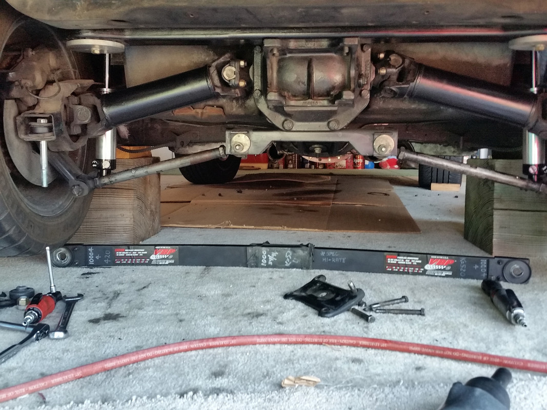

I wish that I would have had you refurbish my rear ends for me years ago when I was breaking posi housings every year or two. I saw the problem and wondered why they didn't use a bigger pin diameter. It just needed more support instead of elongating the posi pin hole and cracking the posi housing. Then I heard about Tom's and went to the stage 6 or 7 with the best yokes and richmond high nickle 4.11 and US 3.55 gears in my other spare rear end for road racing Of course the HD rear end cover.
I still feel sorry when I do a max take off always wondering if it's trailer time home. I have tom's outers and good half shafts.
Installing the 520 pound rear spring
