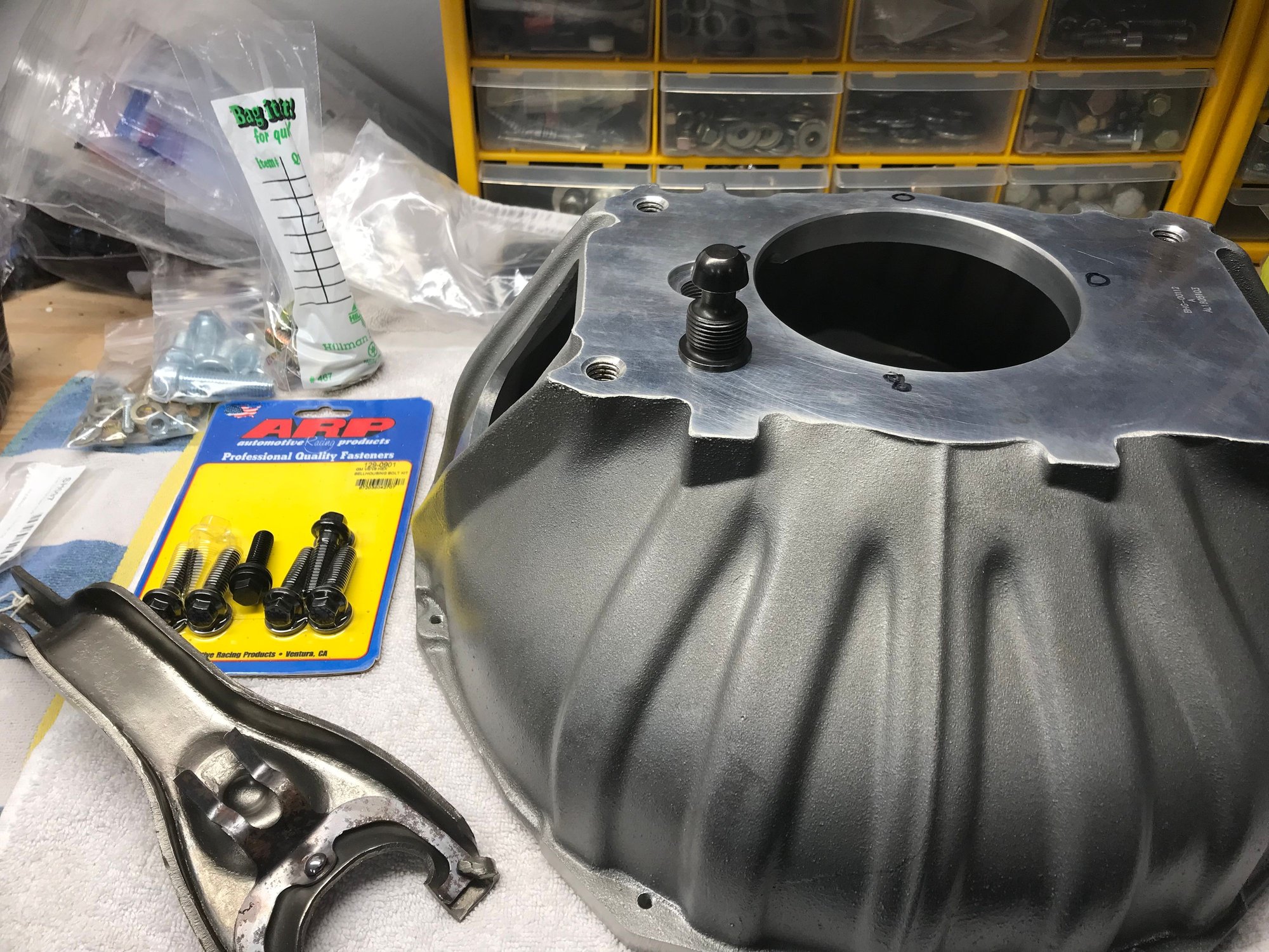

I’ve looked through all the manuals and can’t find any reference to the torque value for the ball stud in the clutch housing.
Lar’s referenced them as being “really tight” in an old thread about removing them, but there are no threads referencing what the torque spec is for installing them.
Nothing on the internet, or YouTube.
Should I just tighten it as tight as possible?
Should I add a dab of blue Locktite or should there be anti seize on the threads since the bell housing is aluminum.
Thanks in advance,
Greg

I put mine in with German torque. Goot-n-tight. Blue Loc-tite of course. Been in there for going on 20 years now.

It's a non adjustable stud that you, hopefully, won't ever take out.
So, pretty tight with a regular length ratchet. You don't want to screw up the threads on the bell housing by being over zelous.
I'd use red locktite.
Also, from my personal experience, I'd install a adjustable stud to fine tune your linkage.

I also thought about red LockTite.
I agree with you and will go with a little red.
An adjustable stud would be nice, but I’m already so far over my budget on this car and every little part is just putting me farther away from getting it completed both time wise and budget wise.
