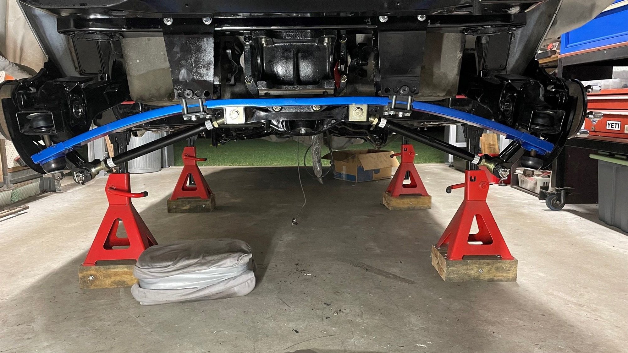

Hello All,
Some time a ago I purchased a new but never fitted dual mount VBP spring. At the time I was informed would need to get the two mounts - this was immediately forgotten.
The time has come to fit it all up, and it is now i realize I don't have the mounting brackets and I cant find where to purchase them from. Please note, I am in Australia....exchange rates and freight make purchasing very expensive....but if this needs to be done, so be it.
So.
Does anyone know where I can purchase from?
or
Does anyone have a pair they no longer require?
or, even better.
Could some one measure there own set with enough info that I can manufacture my own set.
Option 3 is my preference as I have the skills to do this easy enough, just need some ball park figures.
Thanks in Advance, Have a great day.

I do have a pair of the rear crossmember brackets with pivot blocks and pivot bolts. They are for 63-79. They are yours just pay shipping.

You may have missed my other post but I do have the brackets. You can have them just pay shipping. Pm me some shipping info and I'll try and get you a shipping price.
Tom

Old Mar 18, 2024 | 07:12 PM
MyDude's Avatar
MyDude
Joined: Dec 2022
Posts: 23
Likes: 13
Thanks for the info. Rear spring installed. Full overhaul of the back end. New rubbers, seals, bearings, diff rebuilt, tank removed and serviced, all steel repainted with 2K gloss black..... onto the next bit.
