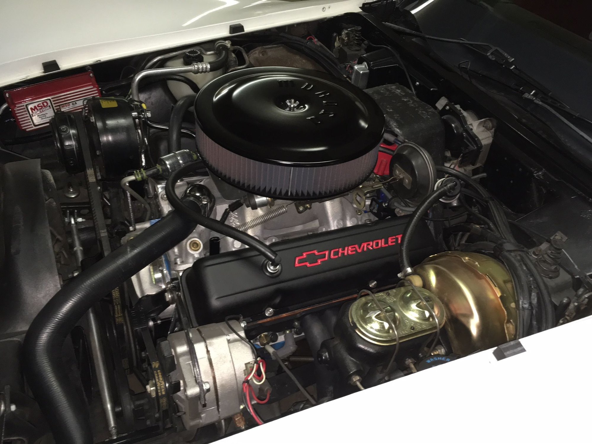

A 14 inch "Drop-Base" air cleaner is a great option.
I have the Eddy 7501 Air Gap which is taller yet. But with a 1 & 1/2" drop base and an air filter 2.750 inches tall, I had enough room to include an insulating spacer under the carb. I have 3/8" gap between wingnut and hood. With solid motor motors, there is no contact made between the two.
Some forum members have installed 2.50 tall air filters and even 2" tall units. But you must use caution not to interfere with air flow between the lid and carb.

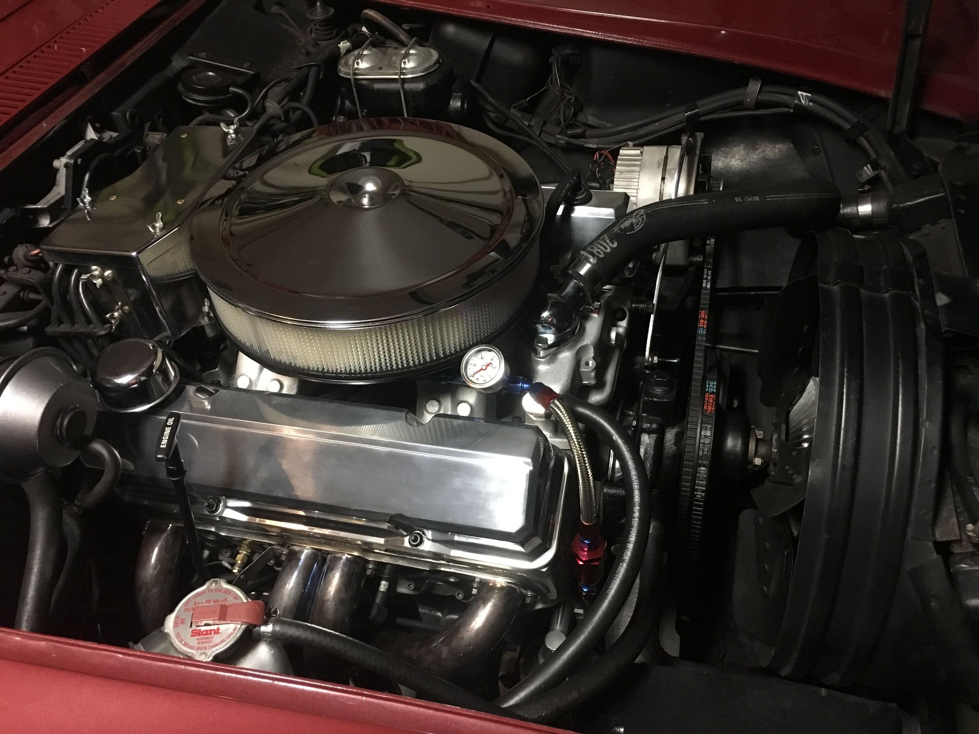

Buy the re-pop of the original LT-1 air cleaner. I run it with a RPM air gap with a three inch filter on my 70 with a flat hood.

I fought with this for years. I have an RPM Air-Gap manifold and require an insulator and heat deflection plate to control heat soak. That doesn't leave much room for an air cleaner. I finally bought an L-88 hood and put on a decent 3" air cleaner. Ultimately the best solution.

I run a. Dropped base unit with a 5. Inch tall filter with my. Baldwin motion hood.
