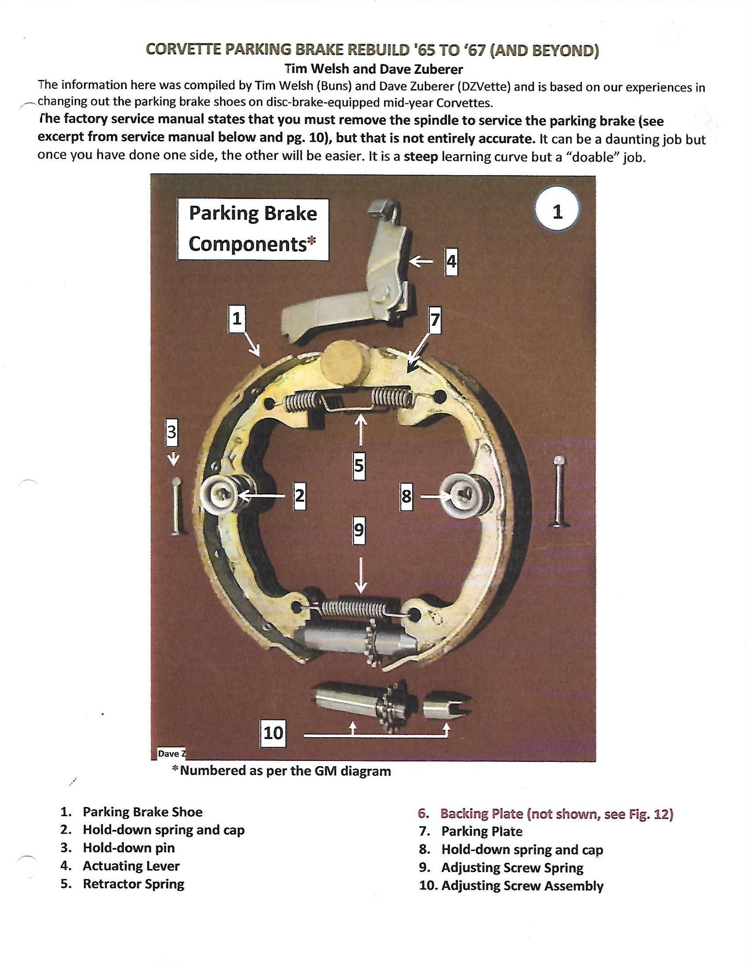

So I have been chasing a noise and have finally found the culprit. The parking shoe hold down pin/spring/cap assemblies on the driver’s control arm. The forward cap is hitting the back of the wheel studs. The rear one looks bent. Also noticed I may have a bent rear slot mag. Bummer. Check out the vids, let me know what you think,

Time for a closer look at all the parts.

Thank you for posting that pic Peterbuilt! Looks like the 2 hold down pins are different lengths and whoever rebuilt the parking brakes may have put them in the wrong spots.

DB-14 from Zip are all the parts that you might need.
All the pins should be the same size, one is easy to replace the other one is not.
