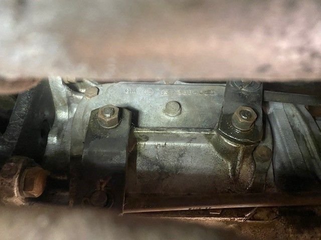

Default pictures
Here is what I have crawling under it.

Front lever is upside down.

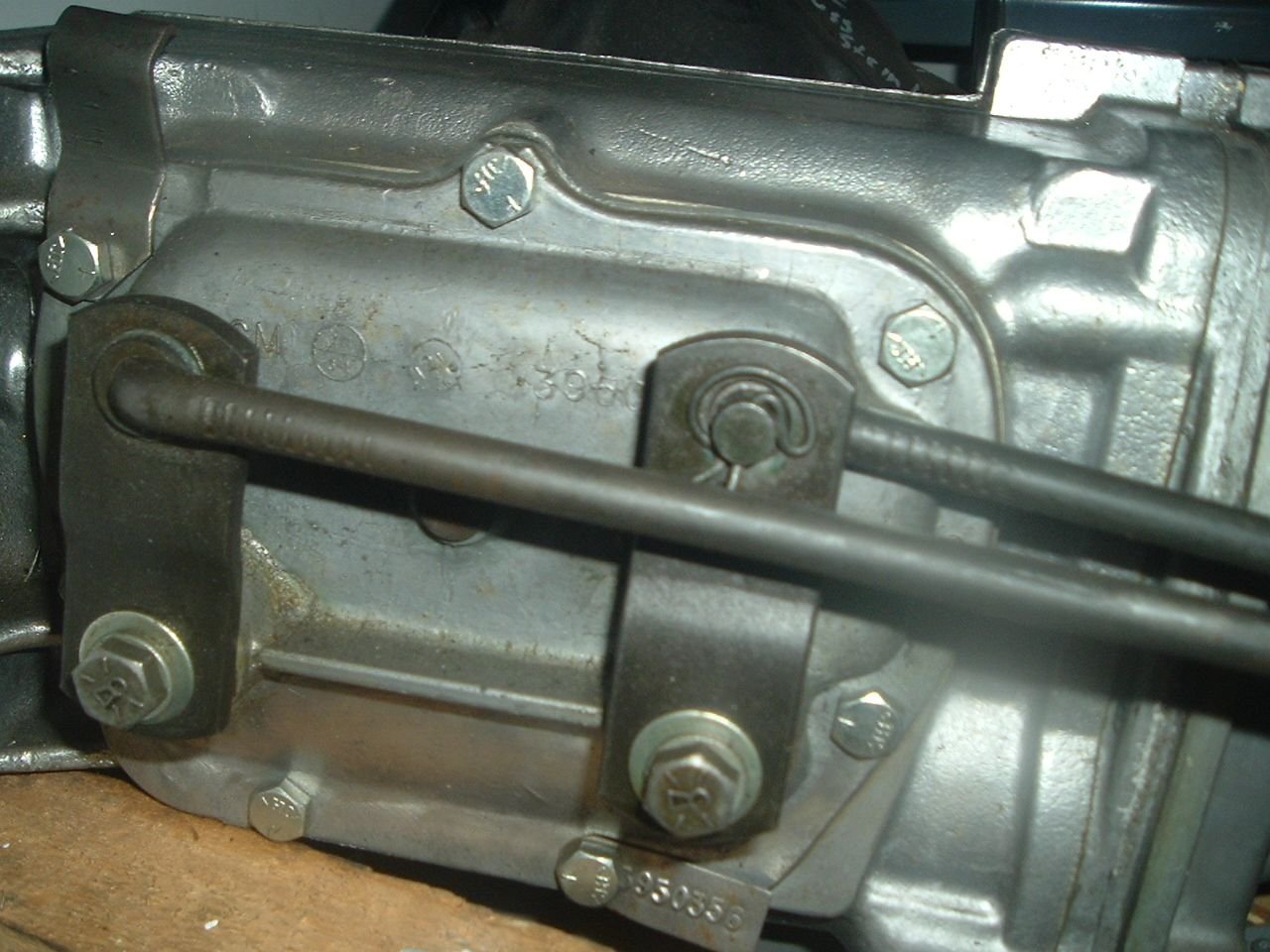

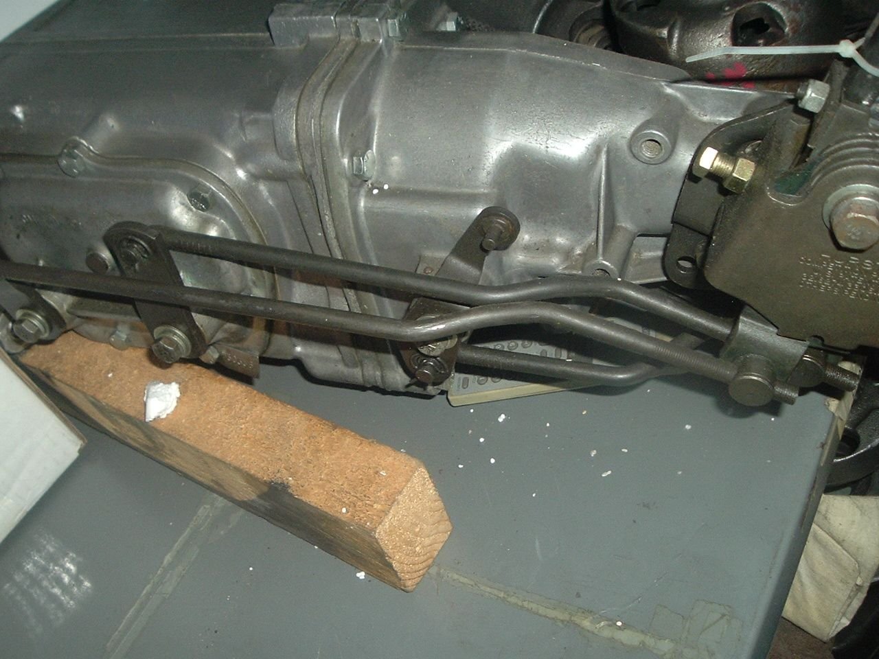

Here is the 69 Muncie I rebuilt out of my vette.
You can see the levers and linkage, yours is upside down.
That will be $475 for labor and consultation.
