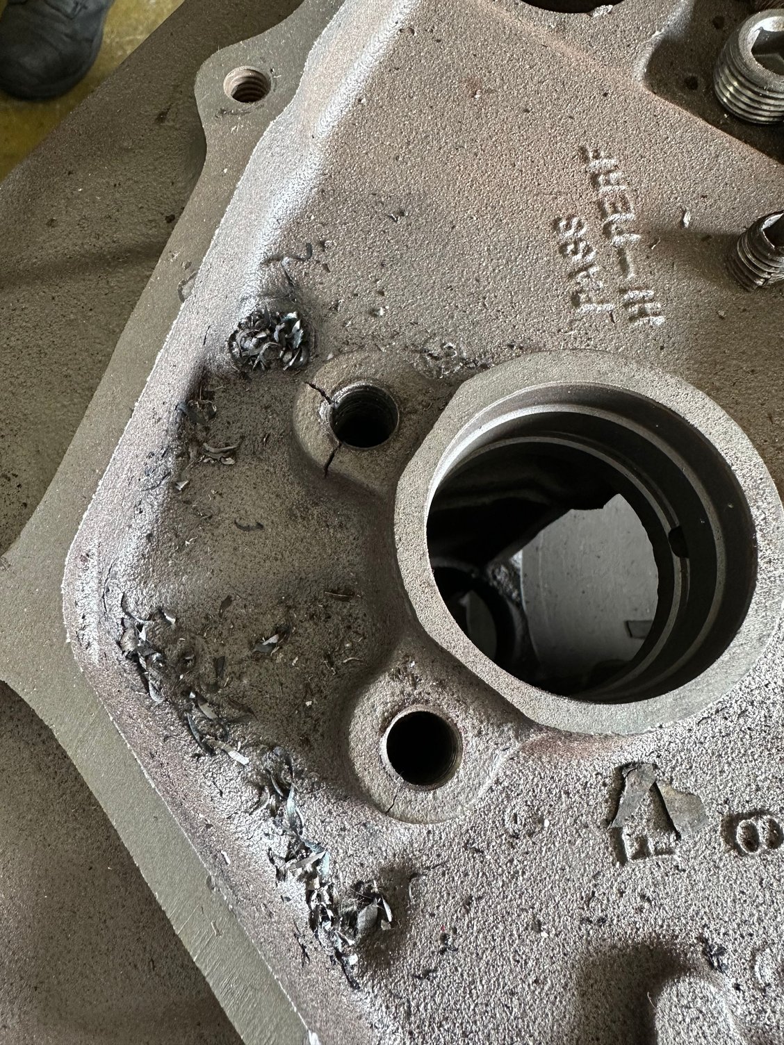

As I’ve chronicled on here, Last year I bought a project 1969 L89 coupe that needs everything done to it.
One of the first things I did was to source a casting date correct 512 427 block.
I eventually found a block from a guy in Wisconsin who deals in vintage blocks and engine building.
It was a very nice block, standard bore.
This fellow fluxed it, baked it and cleaned it. He then decked it.
He did NOT remove the galley oil plugs.
He shipped it out to me in California, and after a few months, My engine builder recommended a “master machinist” about an hour away from me to do the work on the block.
Well, 5 months go by, and still no word on the block machine work.
2 weeks ago I decided to just drop by unannounced to check on things.
The owner saw me pull into the shop and walked out to greet me (I don’t think he remembered me) and I asked him how things were going.
I explained who I was and his eyes got big and he immediately said that there was an issue with the block and takes me in to look at it.

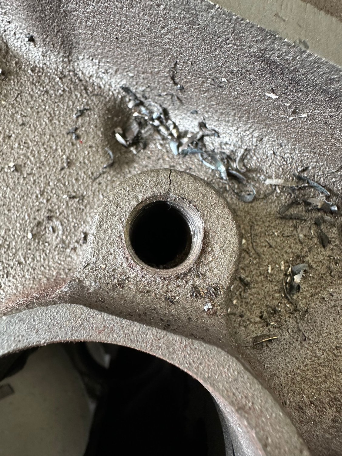

They cracked the block in 3 places trying to remove 2 plugs in the rear of the block by the cam hole.
He said he thought his welder could fix it.
I said don’t do anything till I process this whole mess.
The crazy thing is no heat or penetrate oil appeared to be used. Just brute force.
When the brute force didn’t work, the guy just drilled out the plug and used an easy out with even more force.
I got many different opinions on how to repair it ranging from JB Weld, grinding the boss down to eliminate the crack, welding with nickel rod, brazing, etc

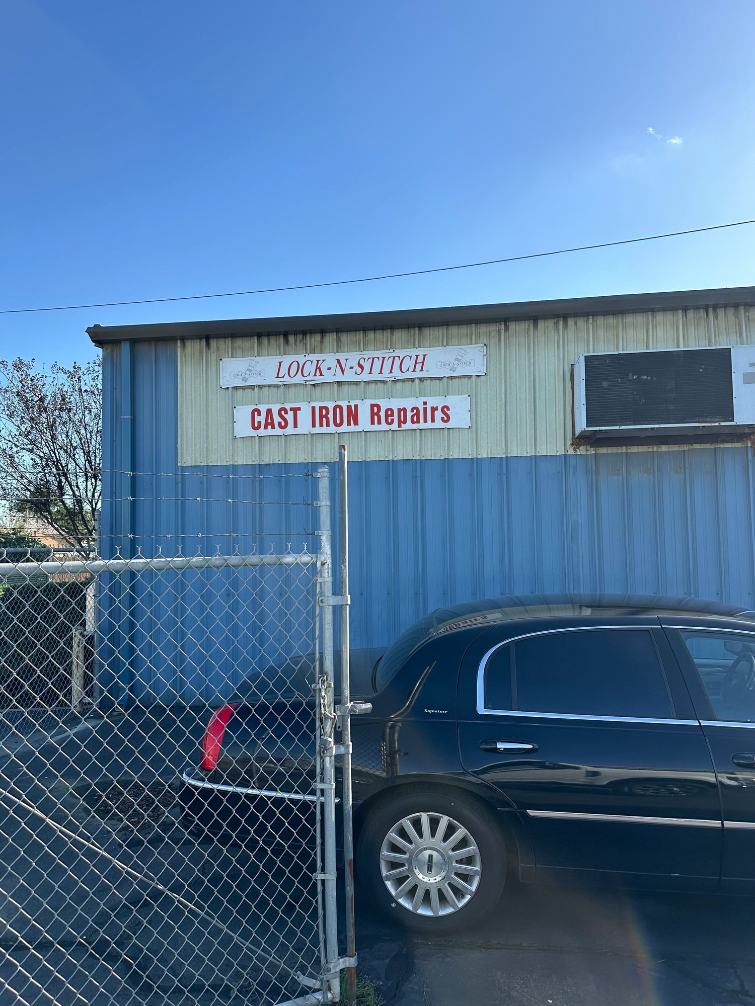

A buddy of mine who is friends with several vintage restorers all said the place to go was Lock and Stitch.
I looked this place up, made a call and emailed pics and spoke to a fellow that said it should be no problem.
The owner of LNS has over 20 patents on cast iron repair utilizing a unique heatless technique.
In addition to the heatless technique, they have the ability to braze it or weld it with a proprietary iron rod.
http://www.locknstitch.com/index.html
check out some of the repairs these guys have done. Pretty amazing stuff.
I received a tour of the place and when I tried to take pictures of the repair facility they asked me not to as some of what they do is proprietary.
After receiving the bad news, the following week I drove the hour to pick up my block and then drove another 4 hours to Turlock CA
After dropping off the block I turned around and drove another 5 hours home.
This repair will cost me between $1500-$2000.
The “Master Machinist” whose shop cracked it, blamed the guy in Wisconsin even though when he told me he had to remove the plugs, I asked if they could just stay in. He was adament about taking them out but said “not to worry they do it all the time” .Needless to say, I’m finding a new machinist.
Stay tuned, I should be getting the block back in 2-3 weeks and I’ll post up pics of the repair.

that looks like a very stupid mistake by the "master"
i have used lock n stitch, yes its a very good process. however looking at those i would have probably opted for a cheaper weld repair. that is hidden in the bellhousing so not visible, could have not even dressed the weld left as much material as you wanted for strength.
honestly looking at those, you probably could thread some plugs in with some sealant and it would never leak.

I know you wanted to throw up seeing that. Looks like they put the new guy on it, those should have been heated before even attempting. I had a similiar issue one time but was able to stop it before that happened. I was there when the machinist started to remove a cast iron plug out our a 67 435 intake. Couldnt budge it so he wanted to use a bigger breaker bar, I was nope and nope. Took it to a Machine shop and had them cut the plug out of it.
You are going to have oil pressure right there so this fix has to be good or you could lose the whole engine. I would go after the machine shop but you probably will get nothing from it. I'm still waiting for one to make a situation better from 15 years ago when they machines the numbers off a 63 block during rebuild.
