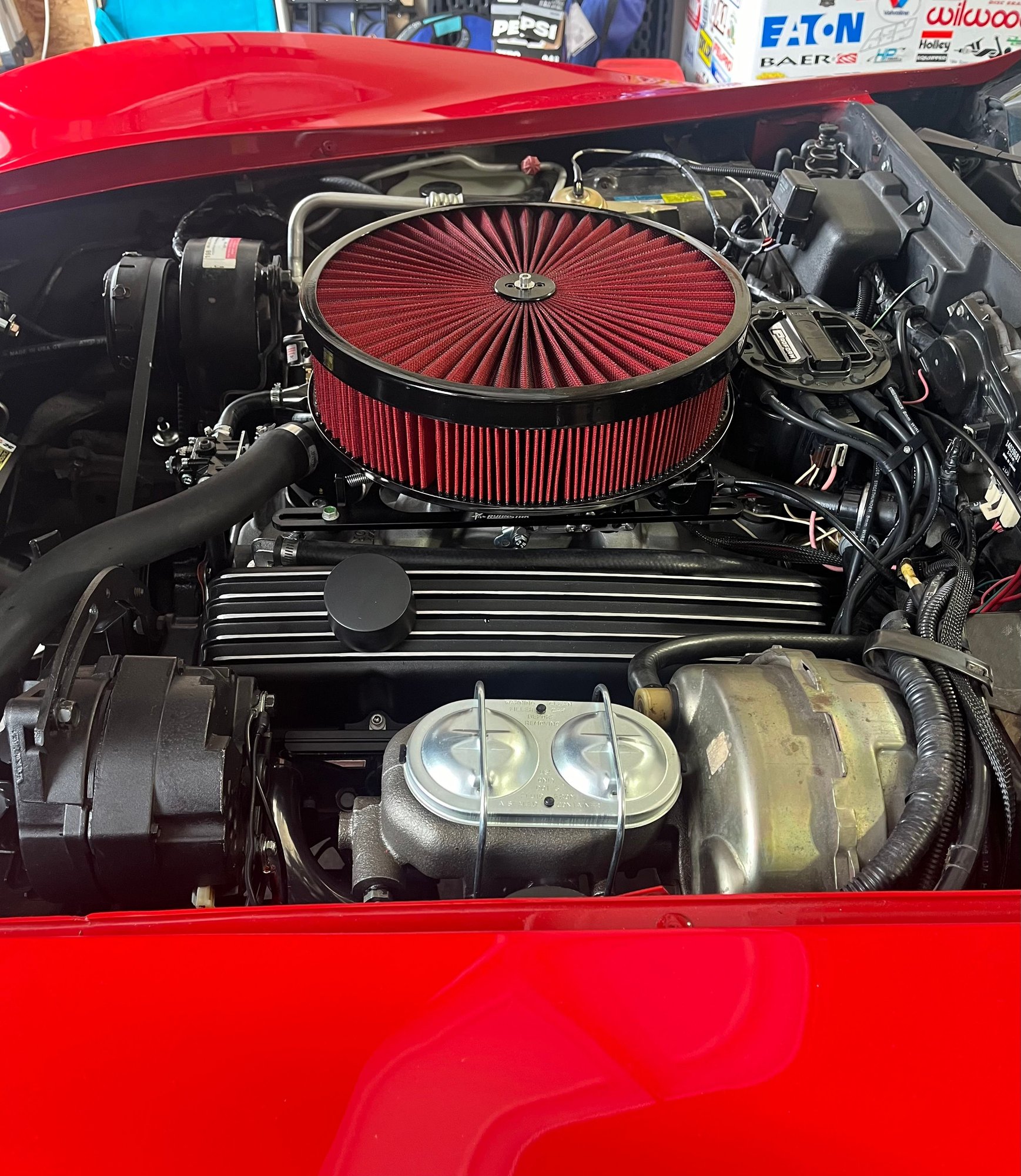

I'm just curious, what exactly is involved in pulling out the crossfire injection system and putting a carb in its place? Without going into too much detail ive done alot of work already and still cant seem to get it to run right. Most likely its going to be the ECM. With that being said i know im gonna need a carb, an intake, and a dist. I already have all those so no money being spent there. I have a known working 1406 edelbrock carb, a practically new 2101 edelbrock performer intake, and a brand new DUI dist never been out of the box. . I plan on completely taking the computer out of the equation. Im gonna replace the fuel sending unit with a 1980 model and put in a mechanical pump on block cause i dont want to mess with the electric pump. I know i will have to use a toggle switch to get the transmission to lock up for over drive and get the proper brackets for the tv cable on the carb. Does the ECM have anything to do with the AC operation? Need AC here in Tx. Am i missing anything? Will the dist drop right in and will connectors plug right on up? What about oil pressure switch for the pump? Will i need to jump something in order for pressure switch to work properly and allow car to start cause ill no longer be using electric pump? And please all im asking for is info on the carb swap. This is just a thought, not trying to be swayed on keeping the crossfire injection. Some of my reasoning for entertaing this is cause of the simplicity and easy readily available parts. This will just be a cruiser so not worried about HP or lack of. Want to try and eliminate everything and get it to a basic carb set up. No smog, cruise control, catalytic convertor, etc. And no im not gonna mutilate my car. Im gonna take off the parts , bag and tag so if i ever wanted go back i can. Any suggestions are welcome, but please keep it carb related.
