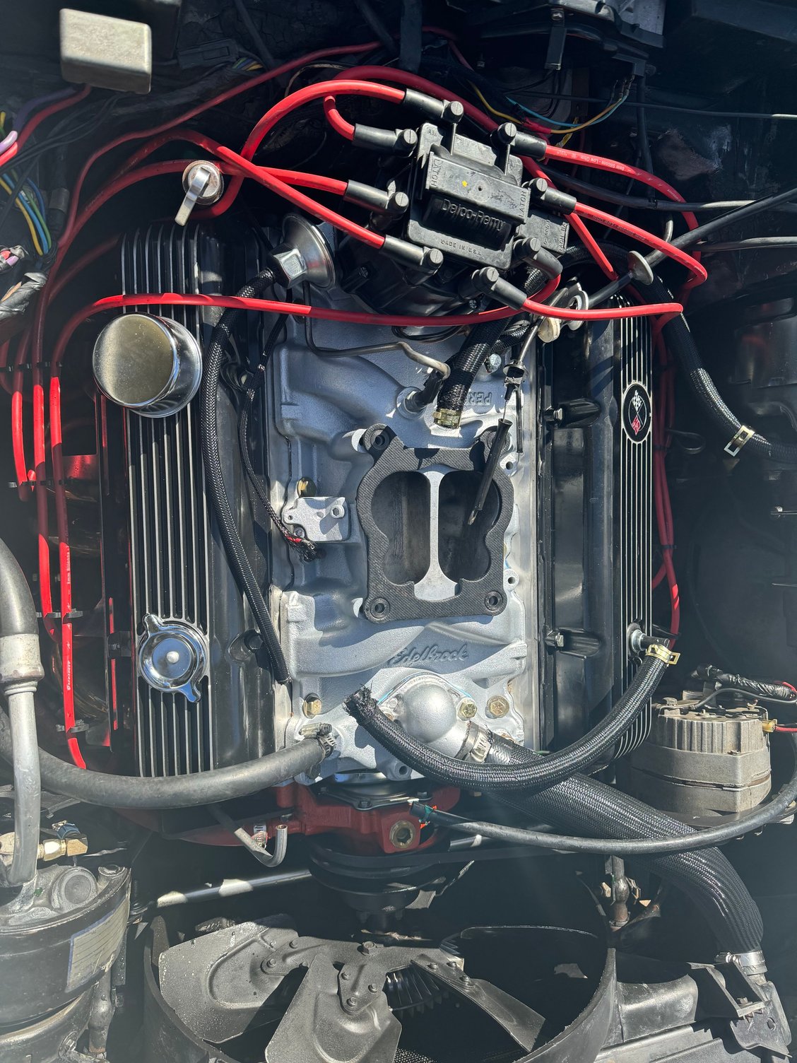

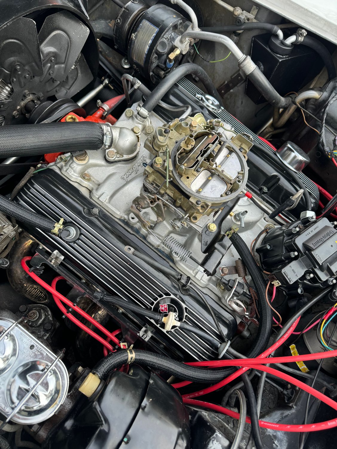

12:30 update

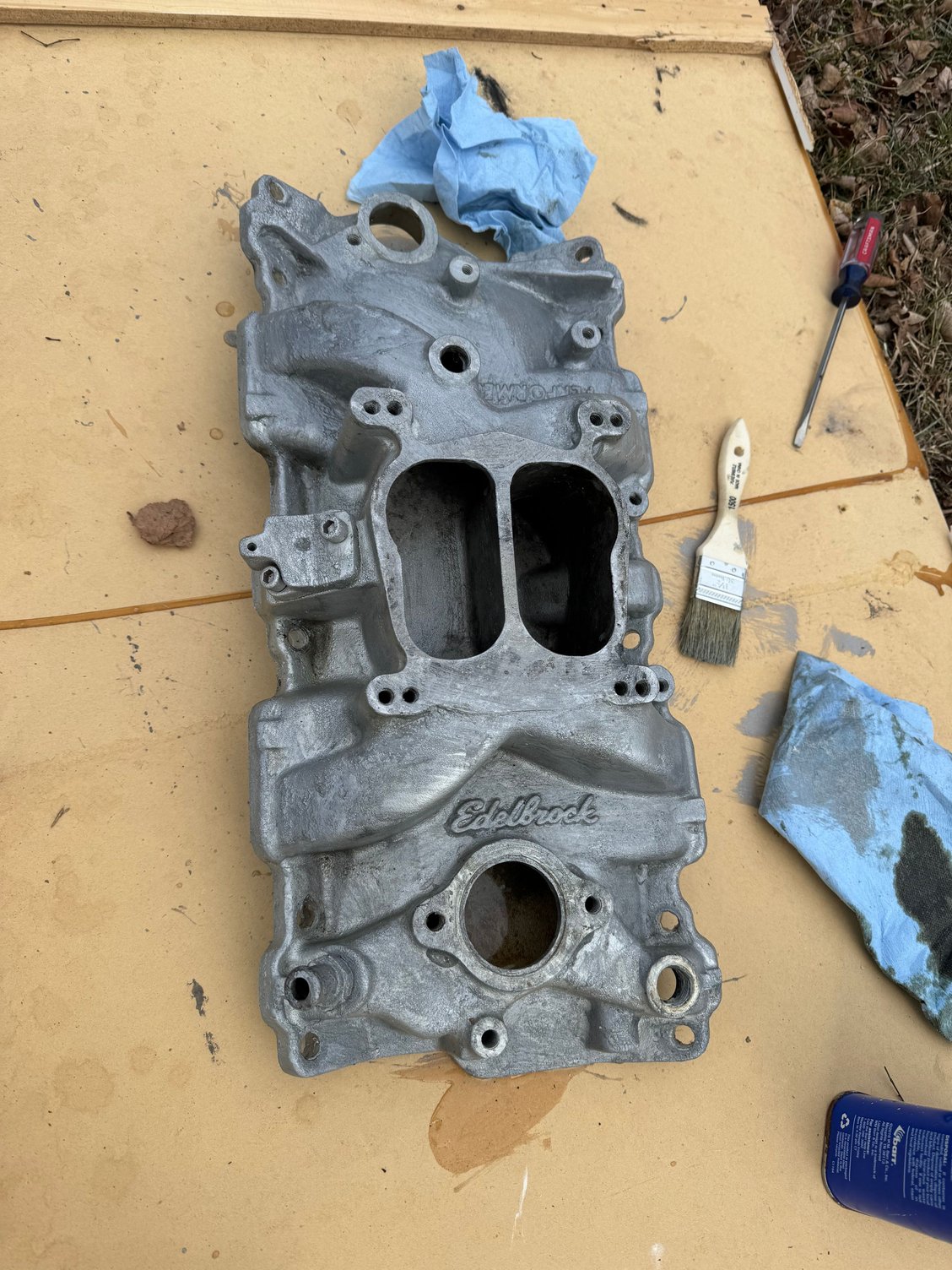

Got the manifold off and sitting covered in paint stripper, I’m not sure if I want to repaint it or just leave it raw aluminum.
Everything has gone fairly smoothly so far. I’d hope so considering this is the third time I’m taken the intake off in the last year.
As arrived
Everything disconnected from the carb
Goodbye Quadrajet
Cap removed and rotor pointed near the #1 tower. An offset 9/16” wrench is very helpful for removing the distributor.
Everything unplugged and ready to pull.
Oops, forgot the coolant temp sensor. Now she’s ready to pull.

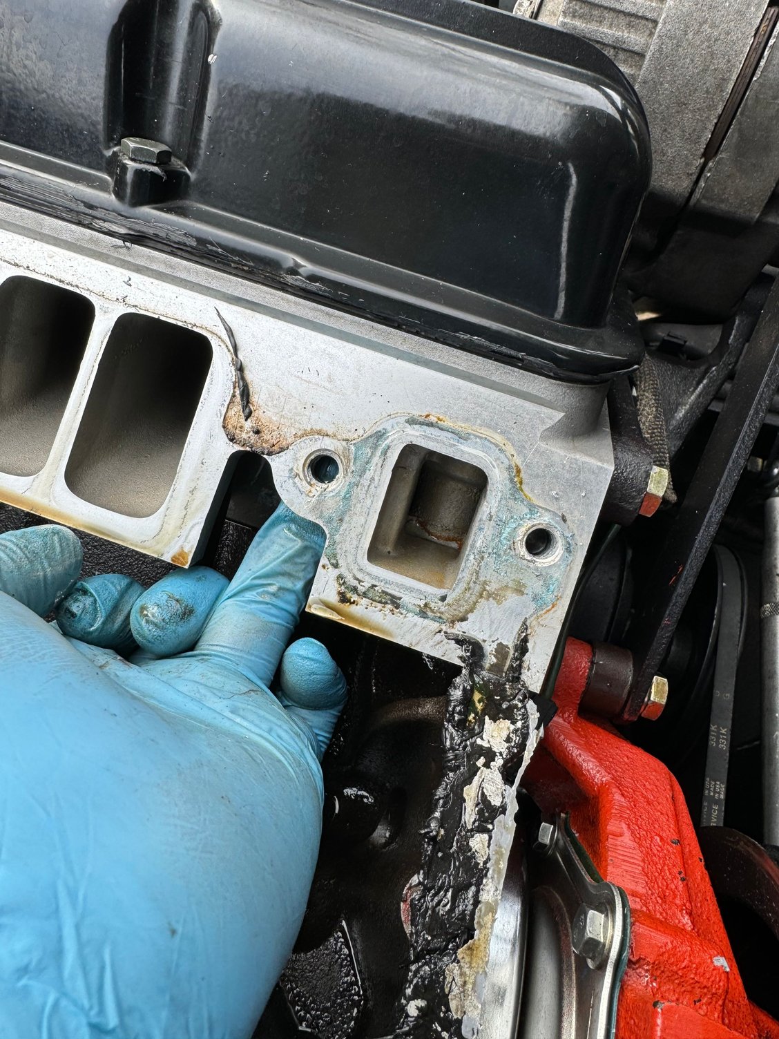

Inside the lifter valley everything looks good. You can see the previous silicone on the China wall all smudged though. The black I used when I installed the manifold, and the gray when I tried and failed to reseal it from the outside.
I saw a thread recently talking about if the bolts on the intake go into the water jacket on the four corners of the manifold. I can confirm they do not. They’re blind.
It’s a nice shade of old VHT paint and stripper mixing together.
Cleaned up with a razor blade, scotchbrite pad, and brake cleaner. Any advice on cleaning out the holes?

Since you are using RTV i would not worry too much about cleaning the holes out. you could just run a drill bit in them with your fingers if you want. seems like an awful lot of oil to be losing from the china wall and like stated above that much should be easily to track down.

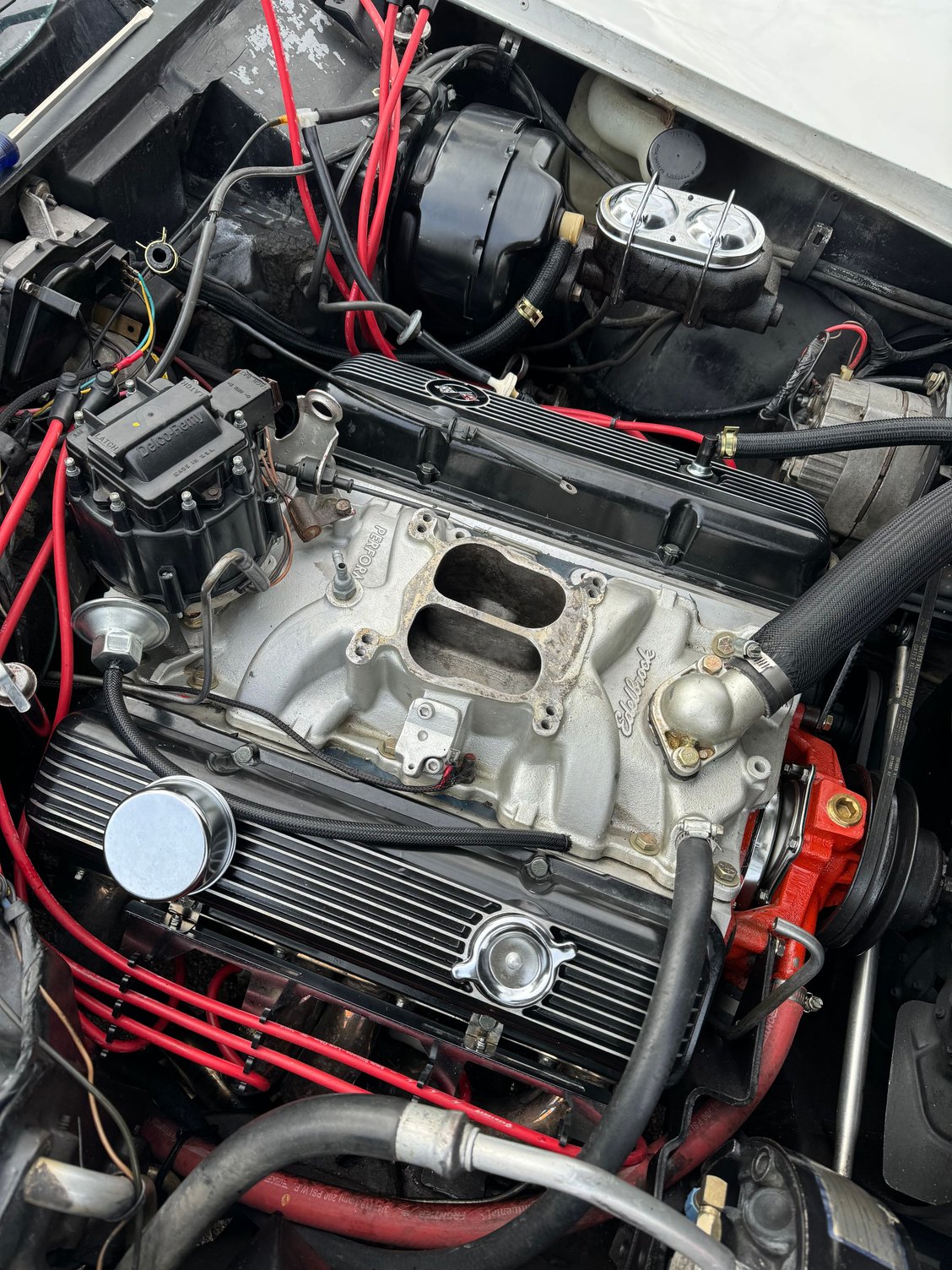

Funny that you mention welding, my beads reminded me of one.
Intake painted and gaskets trimmed around the top so you don’t have a big piece of gasket visible on the cylinder head.
Installed and torqued to 25 ft/lbs.
Nice visible bead in the front
And rear
Thats where I’m leaving it for today. I’m not trying to rush anything, just trying to give the RTV as much time as possible to dry. The rest will go on later this weekend.

The correct method is let the silicone setup first. Then torque to spec. Yes, it does look like your going a bit fast.
Gasket trimmed along the top is no where near as important as perfectly centered on the ports.

Originally Posted by Piersonpie
This photo. Clearly shows silicone on the china walls. Intake gaskets not glued in place. Sealant around Intake ports? Correct sealant around coolant ports? Certain they didn't move?
these old engines don't have dowel pins to hold alignment like newer style engines. I do think your going way to fast.
