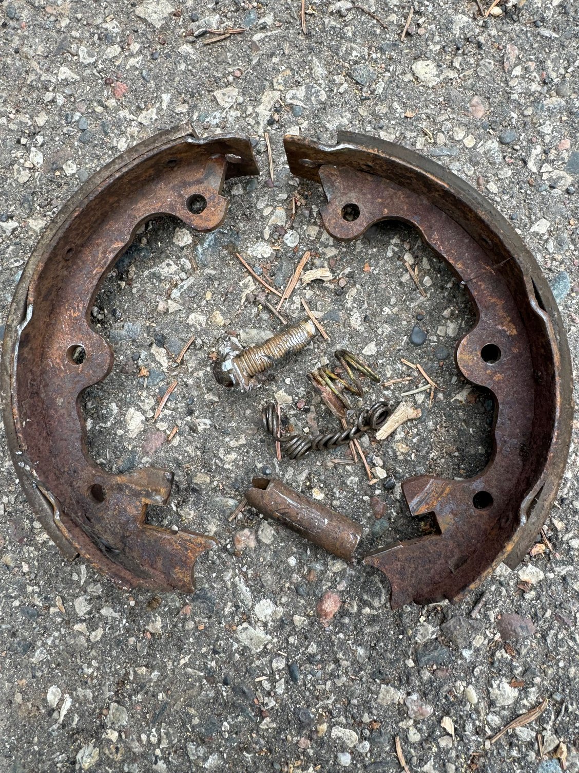

My intake fiasco of last weekend ended with getting the car started, getting ready to take a test drive, then the parking brake locking up and finding part of the adjustment bolt on the ground.
Hell of a test drive, a whole 5 feet.

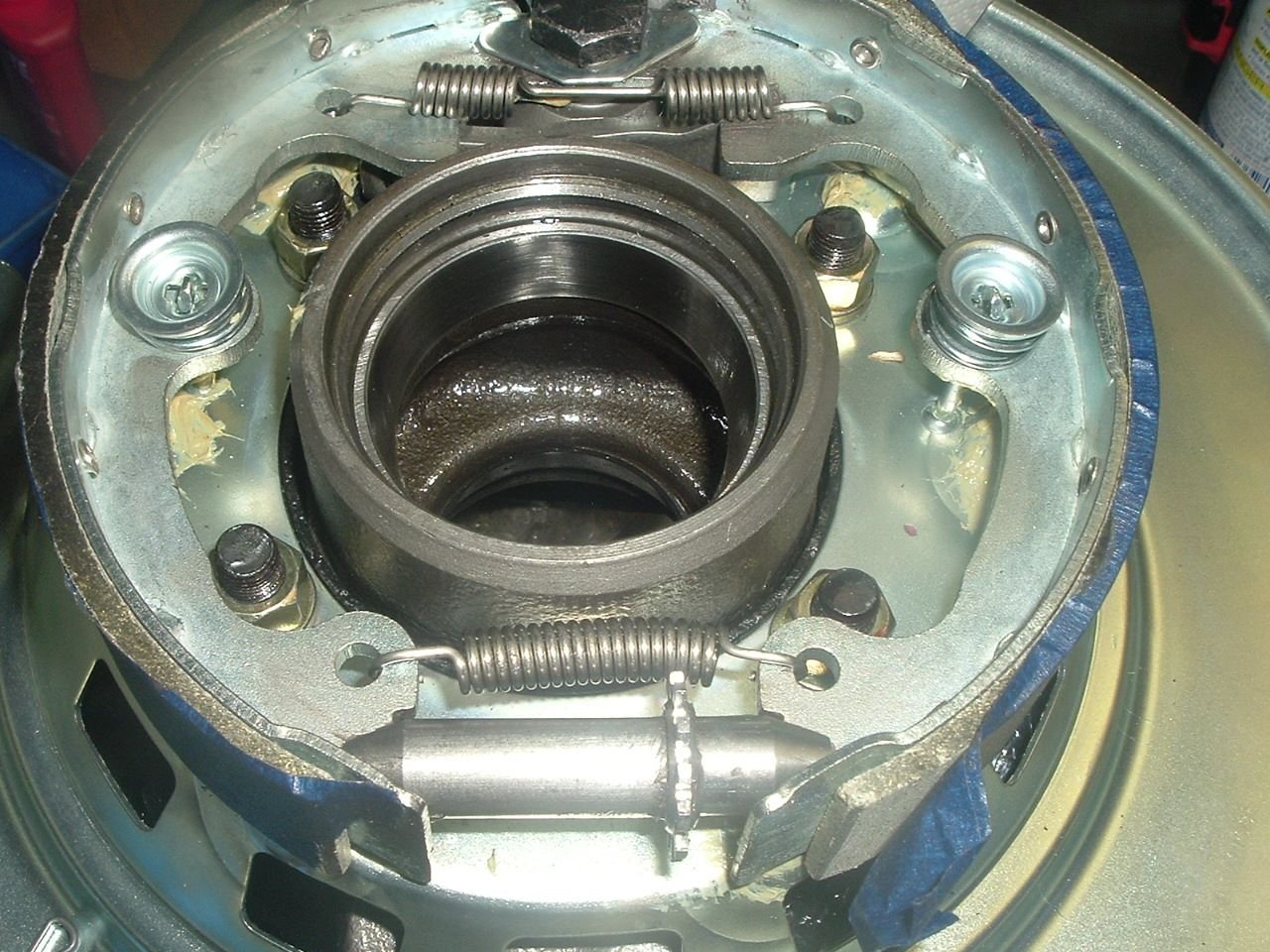

Luckily the car would reverse just fine, so I brought it back to where it sat before, and left it there. I bought the stainless rebuild kit and tore into it this weekend.
Certainly looks much better than before.

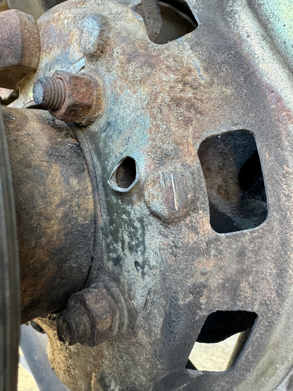

All went smoothly, marked the rotor and drilled the rivets out. The drivers side was pretty good, minus the lower spring being all twisted off and sitting on the inside of the shoes. The passenger side was a different story. This was the side that felt bound up when I tried to drive the car. When I removed the rotor everything fell off! The upper spring and one of the retainers was gone, the other side of the adjustment bolt was torn to shreds. and the lower spring looked just as good as the other side.
Luckily the rest of the underside of the car doesn’t look anywhere near as bad as this. I have no idea how the adjustment bolt managed to get itself stuck in such a way to shred itself like it did, but it managed to rip the shoe retaining pin straight out of the dust shield.
This is not ideal obviously, because I’m able to put the head of the new pin right through the hole. This would prevent it from holding the shoe, giving my car a very hard time keeping itself in place.
The solution here is to replace the dust shield, but that’s impossible to do without removing the rear spindle, opening up an entire other can of worms. My car is 48 years old, and based on what I’ve seen in the rear the bearings are most likely turning on their original grease. It’s time for a rebuild.
Looking at Vansteels website they appear to have both original wheel bearing rebuilds, and exchange units. Although their exchange units are usually cheaper than their rebuild services it seems strange that their exchange units are 200 dollars more per side. The only difference I’m able to find is that the exchange units have new parking brake hardware, which I already have.
So my questions are where should I go from here? Exchange or rebuild? Everything seems to be pointing towards rebuild, but any tips for actually removing the bearing assemblies would be appreciated. My other question is, since I would hate to have to do the same work twice, is this the perfect excuse to pull the trigger on rear coilovers?
Have you considered peening that flared hole back to flat and possibly using a thin washer/shim to give the pin a uniform hole and more surface to bear against? It's not like that pin has much force on it once everything is installed, so it certainly doesn't need to be bullet-proof.

Peen it, flatten, weld/braze, washer it, and redrill. I'd do that first if overall it feels ok. Should be relatively easy to give that a shot.

I think the short term solution is obvious. You can replace the backing plate when you have a reason to rebuild the trailing arm(s).

With a welder, perhaps the OP can do something from the front. But access to at least one of the pins is blocked by the hub.
To get back on the road, perhaps you don't need a parking brake. When you get your hubs redone, have @GTR1999, or Bair's, or whoever, replace the parking brake backing plate and hardware.

You can slip a new pin in from the back after removing all the nuts and bolt at 12 o'clock holding the backing plate on. Like others said, I would just try to flatten out that hole and use a new pin. Just rebuilt them on my 78 and replaced both pins.
