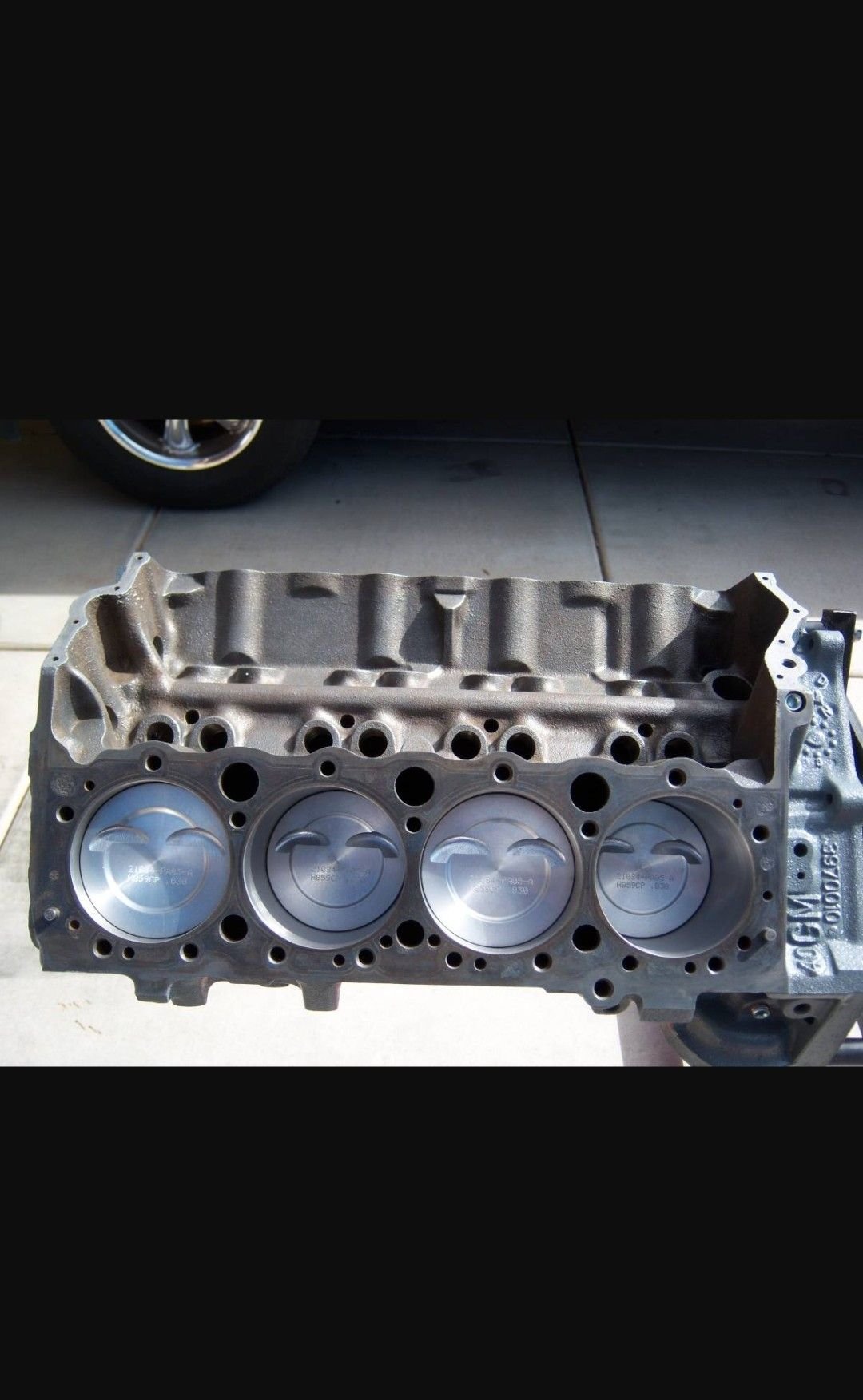

I spoke with a local retired machinist today, he has a fully machined brand new 383 short block... here are the details
383 Chevy Stroker short block. Block is 010 casting 4 bolt bored .030. All rotating assembly parts are brand new. Shortblock is complete and ready for camshaft. Parts include Speedpro pistons w/ Hastings moly rings-@.030. Summit connecting rods are full floaters w/ARP capscrews rated 550 HP. Eagle cast steel crankshaft 3.750 stroke w/ Clevite rod and main bearings standard size. Block is 4 bolt main and clearanced for stroker assembly. Fully balanced rotating assembly w/new harmonic balancer and new flexplate.
Great guy and very close to me and still does machining, i can buy that short block for $1800 which is a great deal as of course i cant get there for that money... he then told me he has another block completely machined 3970010 block .060 over with cam bearings and plugs installed he would sell me for $400, also told me he would balance the rotating assembly after i assembled it for free as he still has all his machines.
Out of town a few days but gonna go see him Wednesday
I am not looking to build the best motor I can, I'm looking to build the best motor i can for the money, I'm OK if it's not a roller block for this one.

Seems like a nice 383.
383 short block with 64cc heads makes a great torquey motor.
