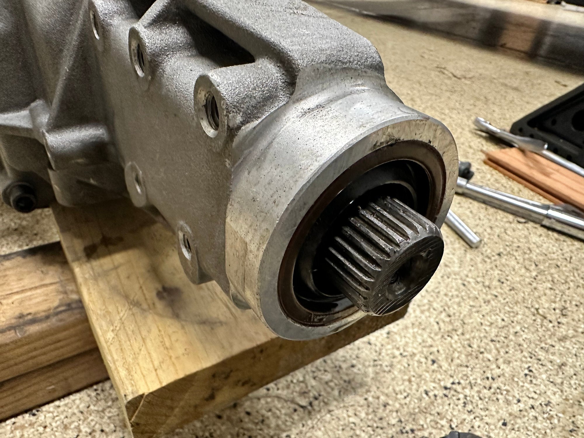

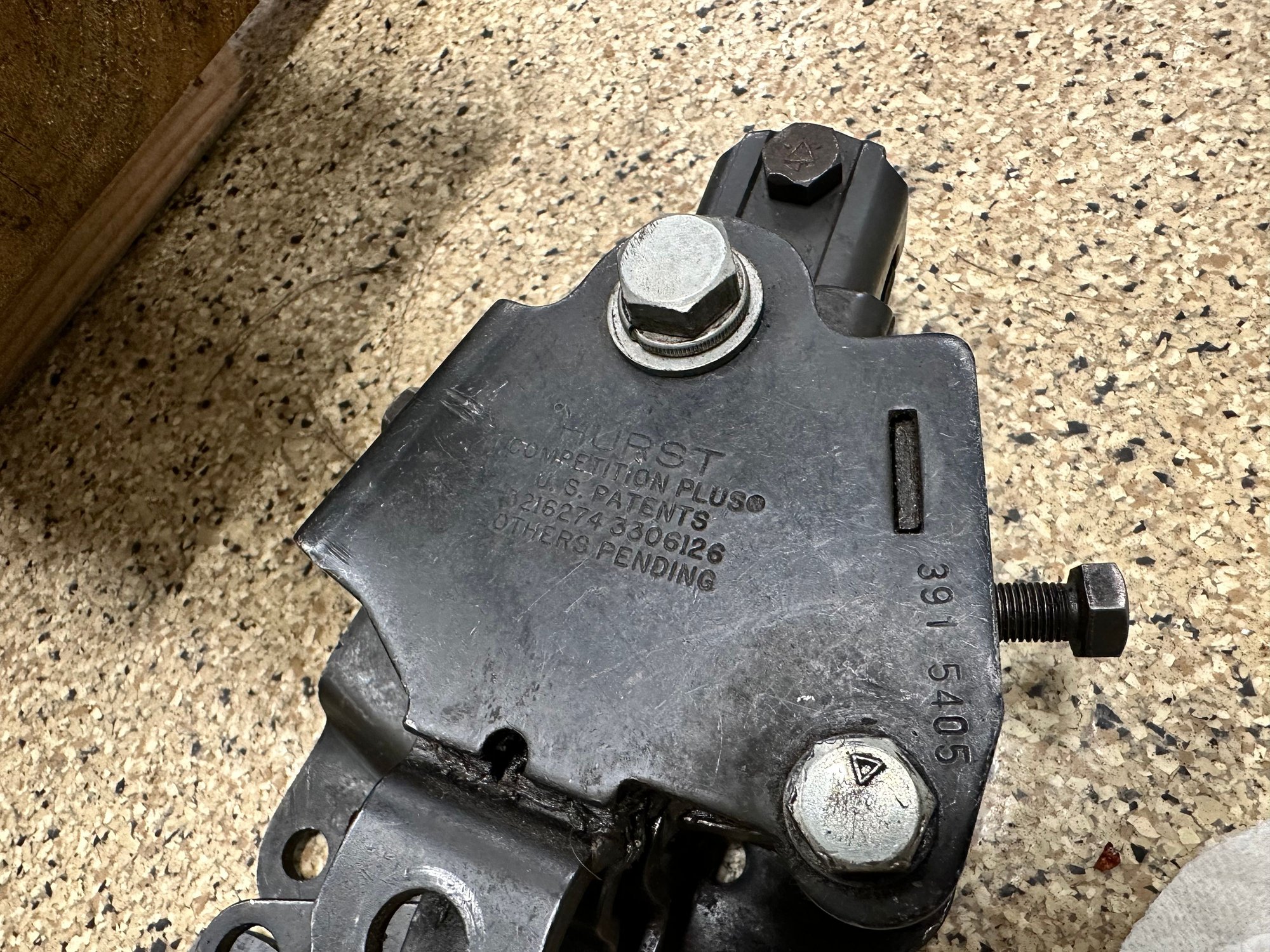

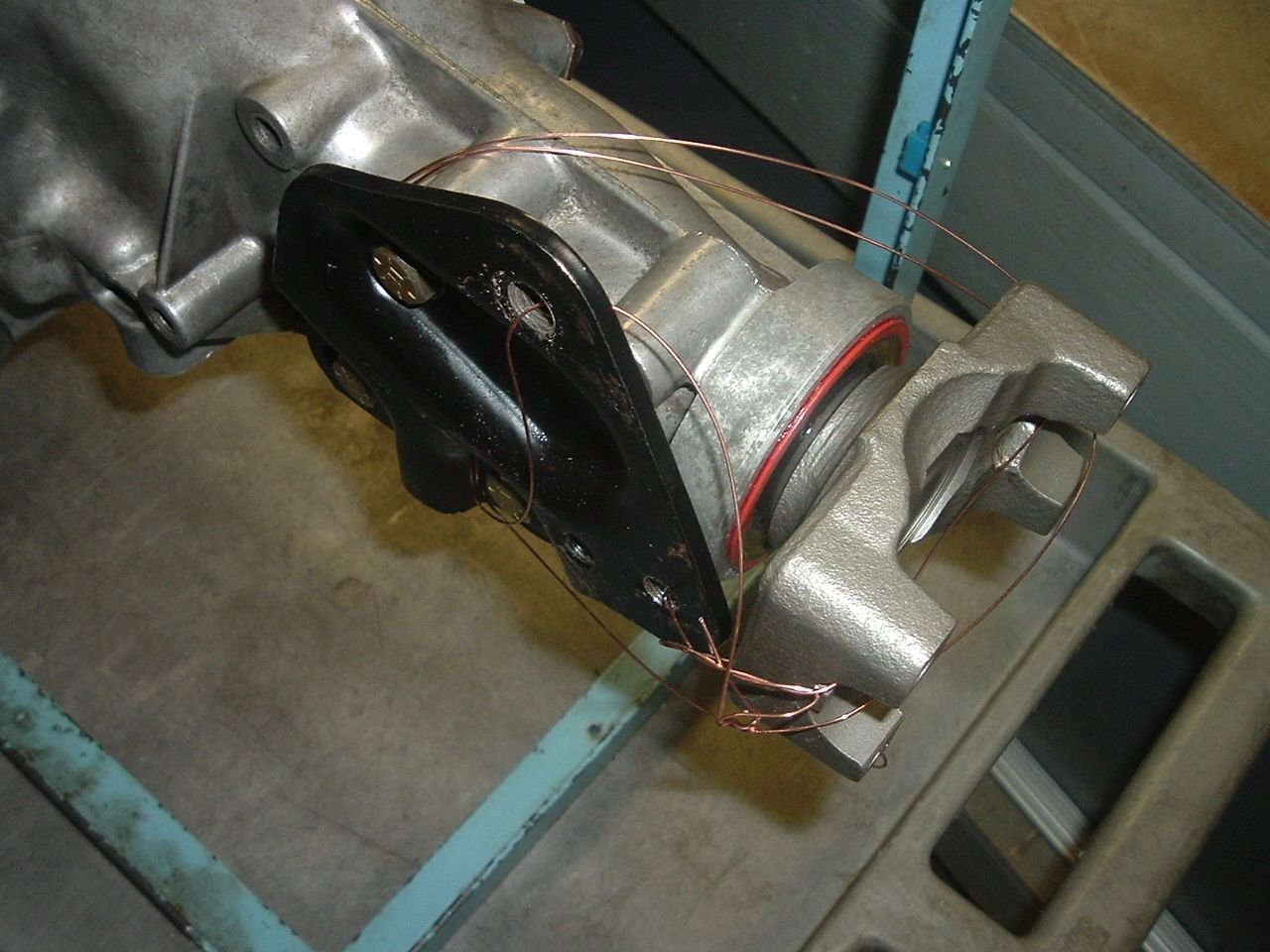

I got my hands on this Hurst shifter. It’s supposed to be for mounting to a Muncie M20 (69-70 I believe).

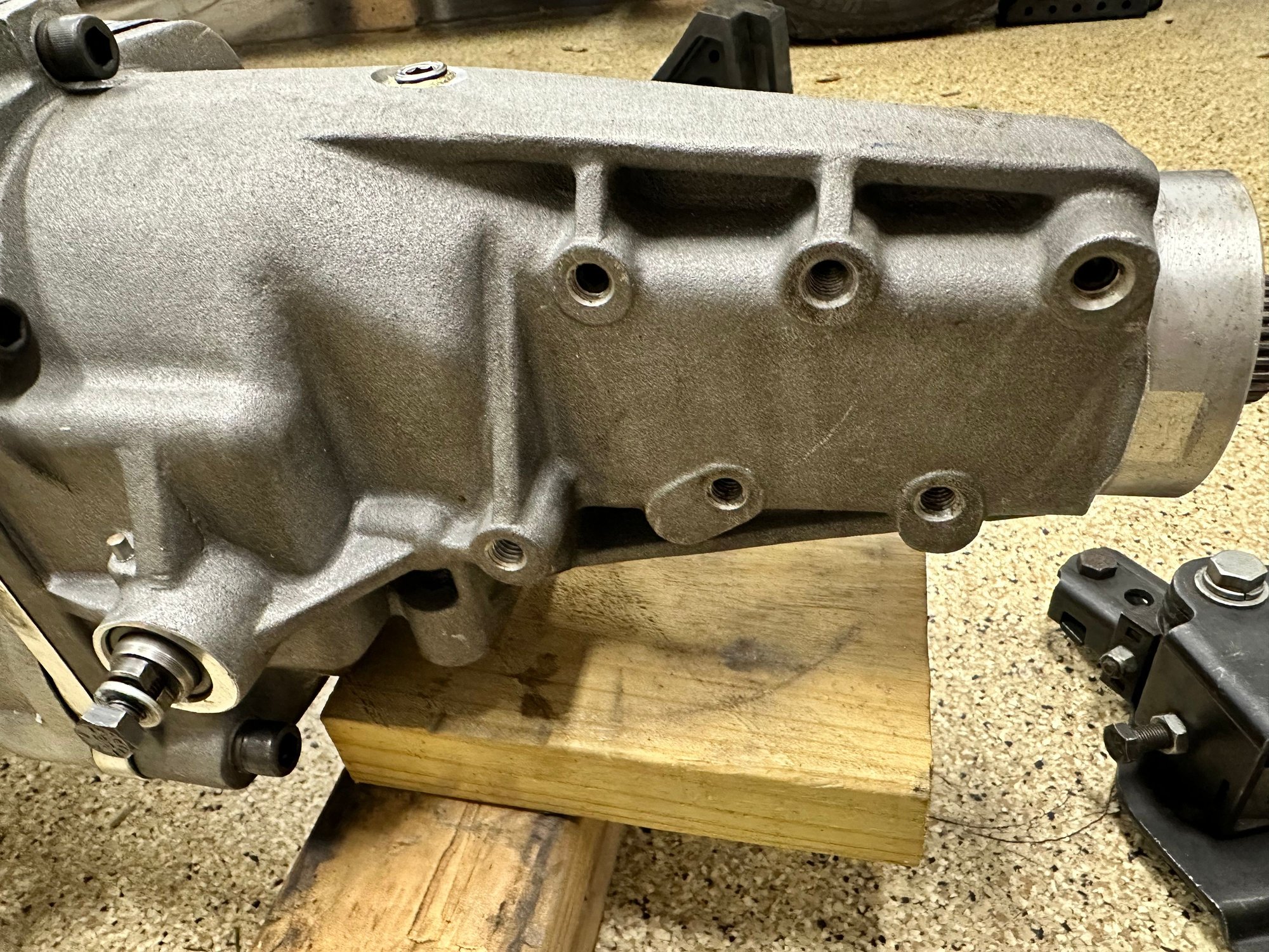

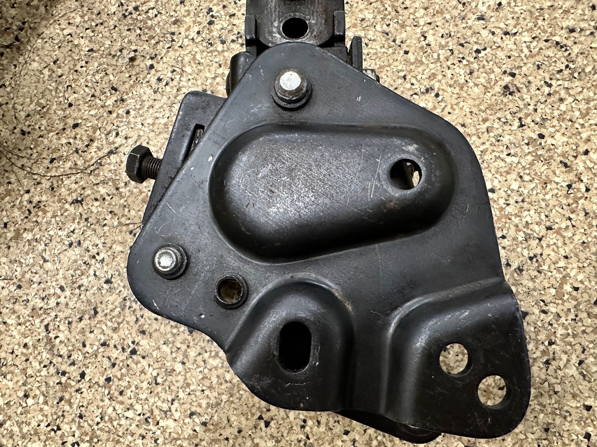

  • This only has three holes but there are five in the M20; is this yhe right mounting plate?
  • What size bolts do I use for the mount?

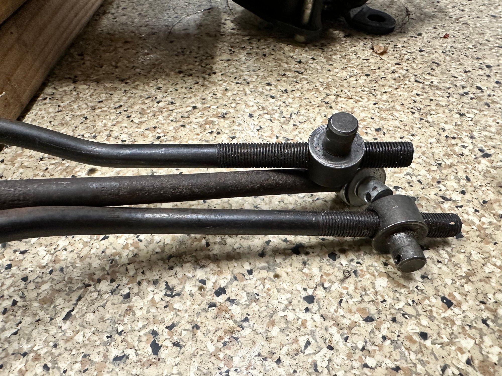

  • What are these curly clips called; what do I shop for?
  • I’ve watched a few YT vids… any recommendations?

M20 is just the option code. Is that a B&W Super T-10 perhaps? 26 spline output shaft? It certainly isn't contemporary to your car.

looks like the correct plate..it only uses 3 bolts
heres a place to get the parts youre asking about
https://www.shifterdoc.com/productca...53&viewAll=yes

you have the correct plate
mounting kit
https://www.shifterdoc.com/productca...0&idcategory=0
mounting kit
Thanks! There are instructions at the link which show which holes to use.

That does not appear to be the right shifter for a Corvette. Doesn't mean it can't work, but you'll be reinventing the wheel.
Here's the page from the Hurst catalog that gives you the right part numbers.

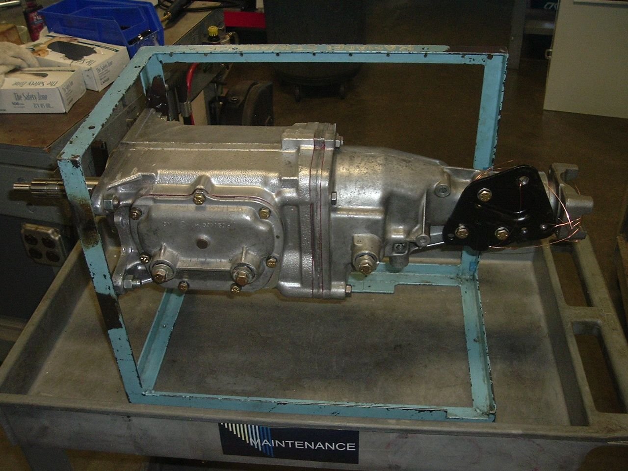

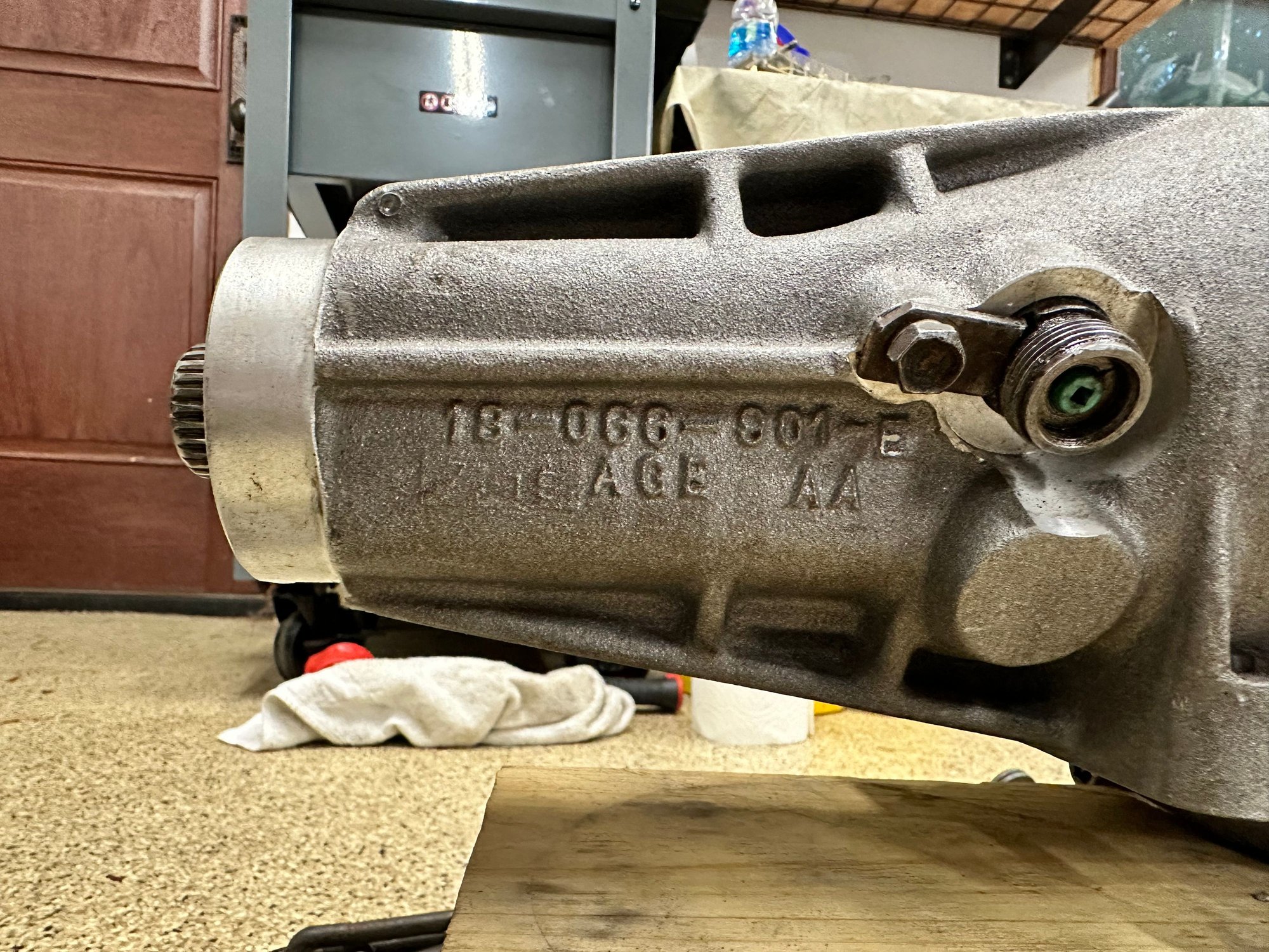

Hurst plate on a Muncie M20. The trans pictured by OP is an Auto Gear super case and tail

if it has not been modified its for a ford...the reverse lever is longer and on the horizontal...it can be swapped out for the correct one
https://www.shifterdoc.com/productca...5&idcategory=0
replacement arms for 3917992
https://www.shifterdoc.com/productca...014-53p625.htm
plus a kit like this...call them with the serial number to get teh right kit
https://www.shifterdoc.com/productca...rts-53p212.htm
