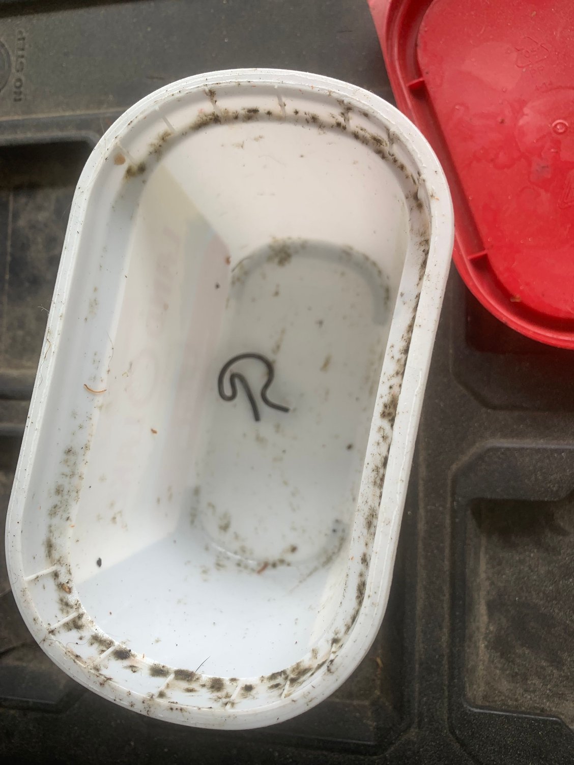

I thought I had this retainer pin/spring/clip in properly, but I found it on the concrete below my clutch arm at the bell housing.
Anyone for a depiction from the Assembly Manual on the proper way to insert?
I don’t even know what to call it.

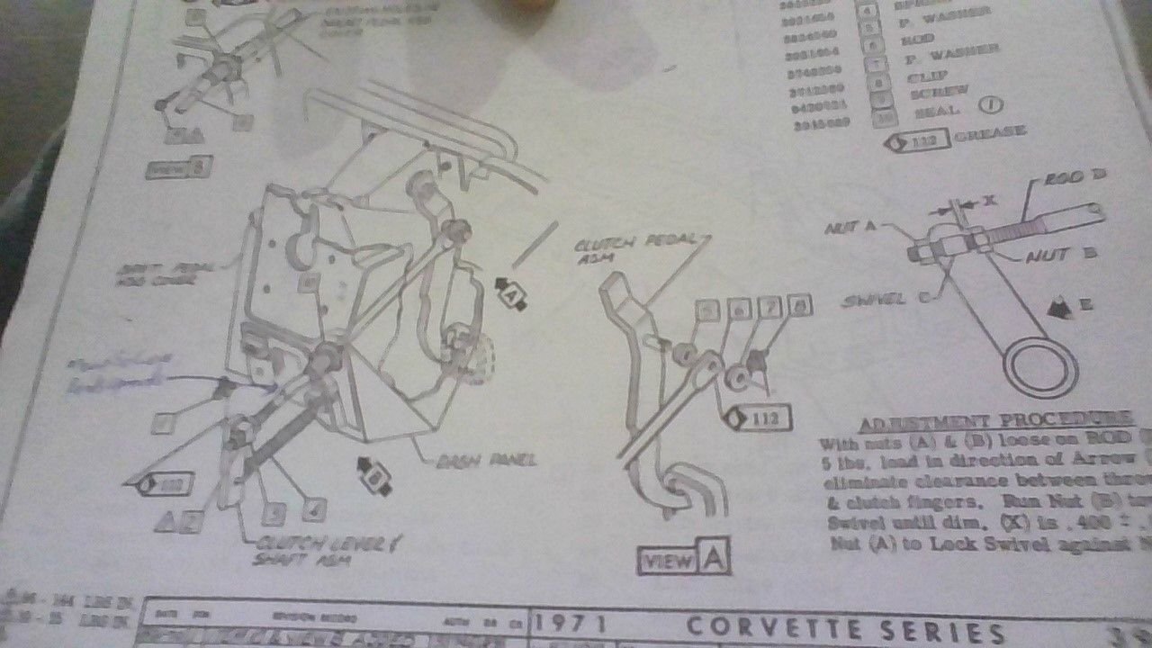

Here you go - from a 71, but should be same/similar:
Not the best photo, hope it'll work for you

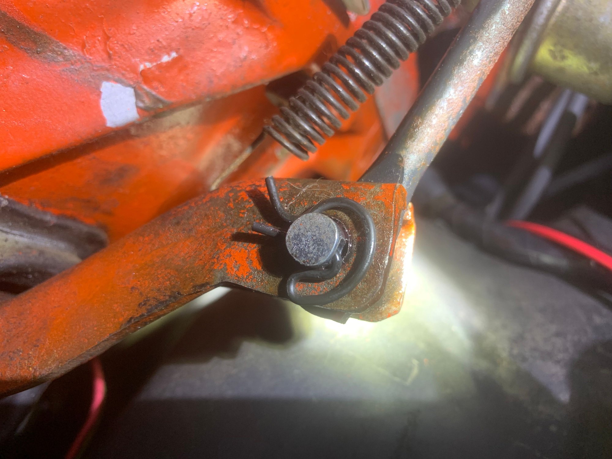

Well, I hope I got the “G” clip in the g-spot!
I felt it click when it went on this time.
Thanks for the help.

Nice pic. Yup that looks correct!
