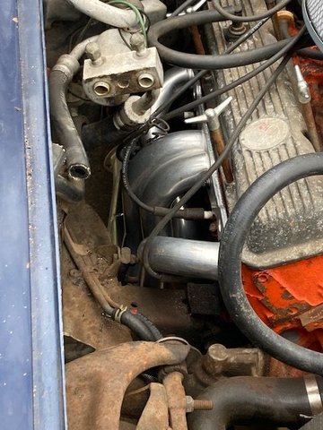

I finally had a day off where it wasn’t raining here in Virginia. It took me 5 hours to get the drivers side header installed in my ratty ‘70 Vette. The most difficult part was removing the oil dipstick tube. I was very concerned I’d break it off in the block. Penetrating oil, heat, and patience won the day. Reinstalling the oil dipstick tube was easy. After that it was like any PITA header install when you don’t have help. I also installed a new water temp sensor since it was there. I installed everything except the Z bar. I’m taking your advice and rebuilding it, since it’s out. I just ordered a rebuild kit. I just wanted to thank everyone for your help and insight

The headers definitely look good. However, I see a new set of custom plug wires in your immediate future! Don't think you can wrap plug wires around a header. Maybe an issue.

Agreed. I haven’t figured that out yet, although leaning toward 90 deg boots
