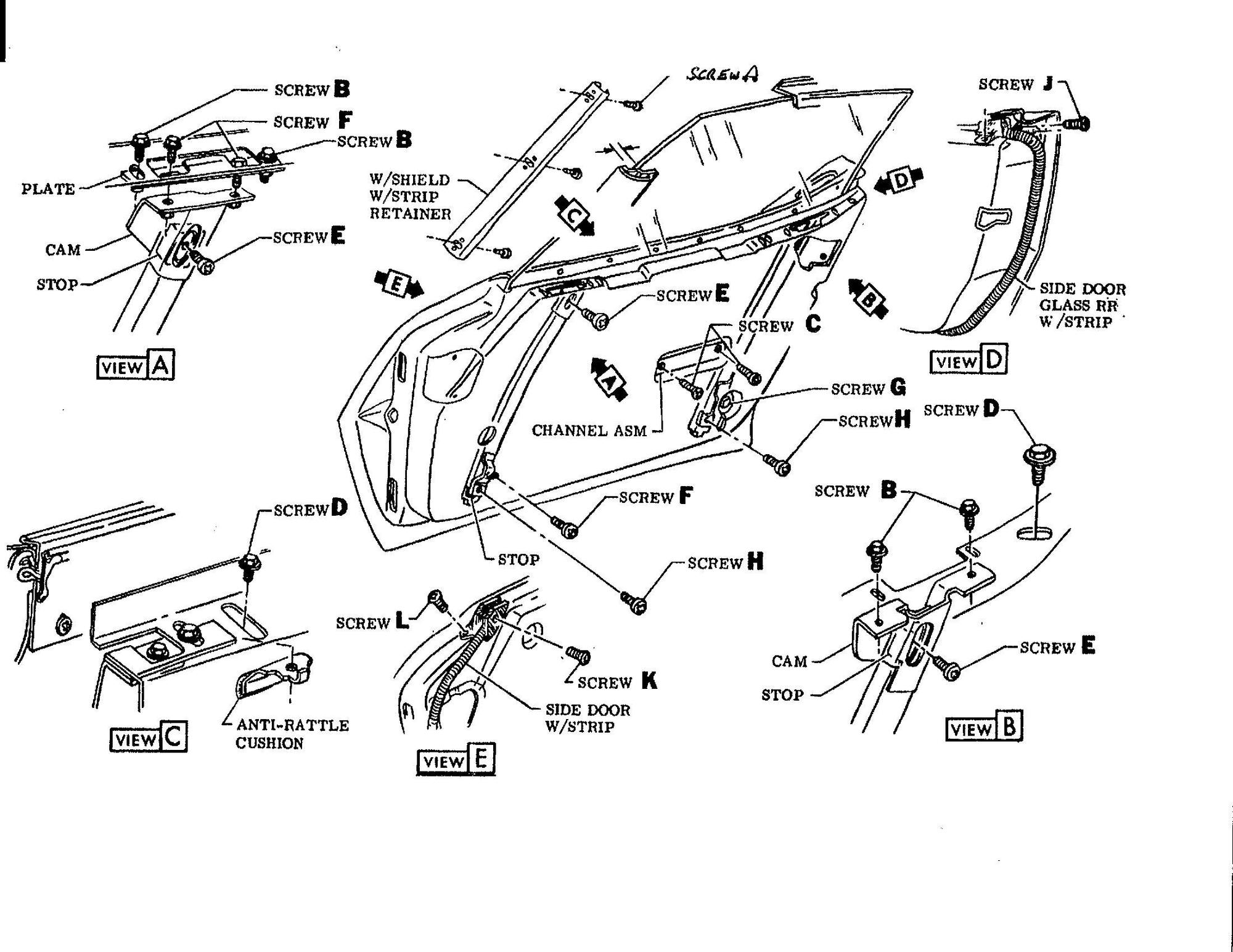

Default Does this help?

Thank You very much. The diagram/instructions will be a large help. Appreciate you taking the time to respond.
