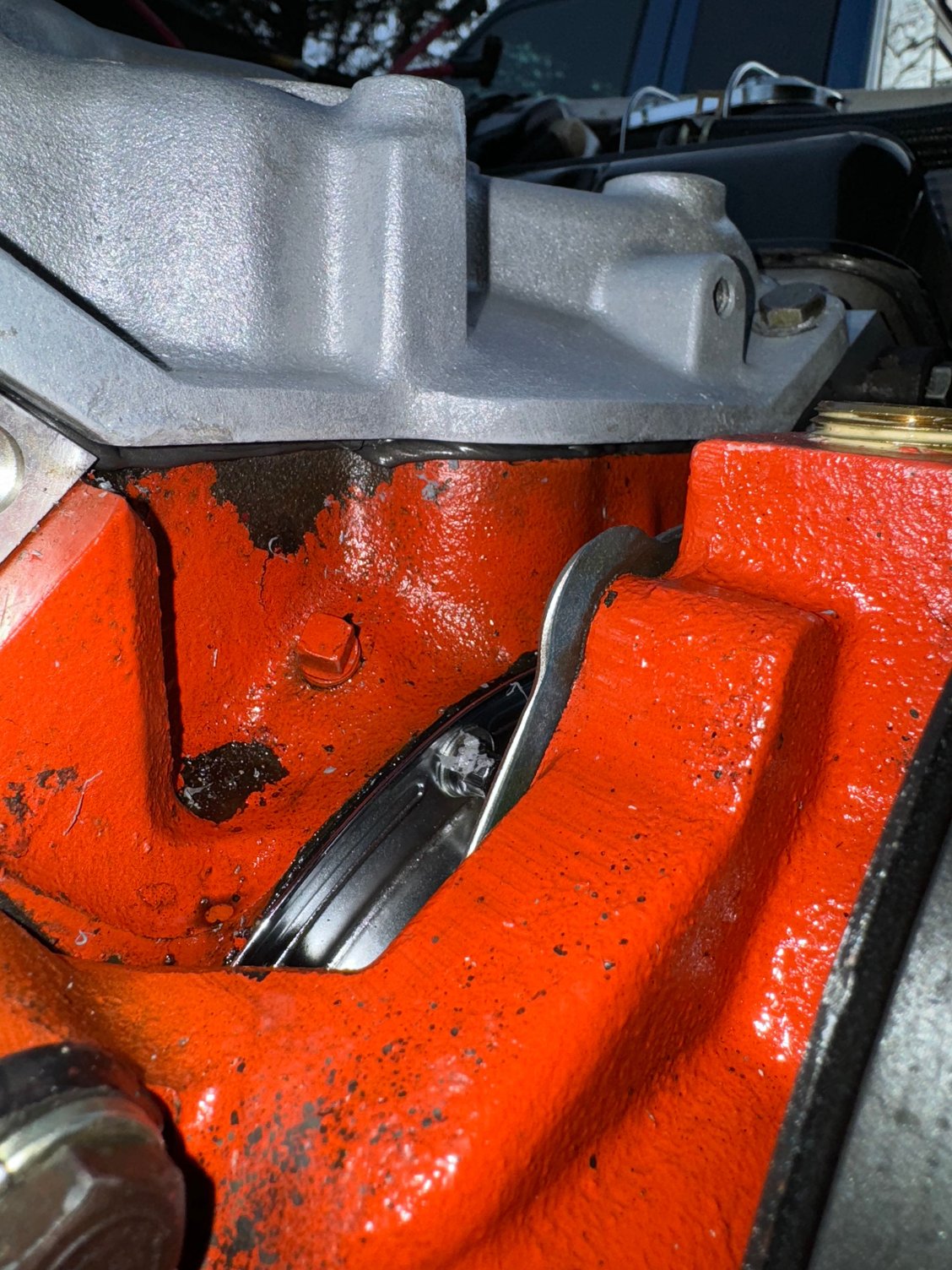

Originally Posted by augiedoggy
Sounds like you may have the seal blew on your fuel pump from either too much blowby or a bad pcv setup. Ive had it happen. Sprayed oil all over my lower engine and it even came through the side vent and all over the side of my car as fine spray. I had 2 things wrong ive since corrected... I was idling super rich and my pcv valve simply put wasnt working which lead to excessive crankcase pressure.
This.
I just went through this exact issue.
Good luck.

Nice car, you have a parking light out.
They make a dye you can add to the oil that uses a black light. Clean the mess up and see if you can find were it's coming from.
How many miles does the engine have? Bet it’s a grooved balancer and hard seal. Or a really sloppy timing chain that ate through the cover.

If you’ve checked the lifters the intake would have had to come off. Did you do the proper procedure of applying sealant to the China wall on the front of the block?
yes i did so that should be all good
Definitely could be that i think the engine has around 70k on it so its been driven once i clean it if i see oil comin from there ima do a new balencer and front seal
Thank you! And it appears i do i gotta get that fixed LOL. Yeah if i cant figure it out that’ll probably be my last resort

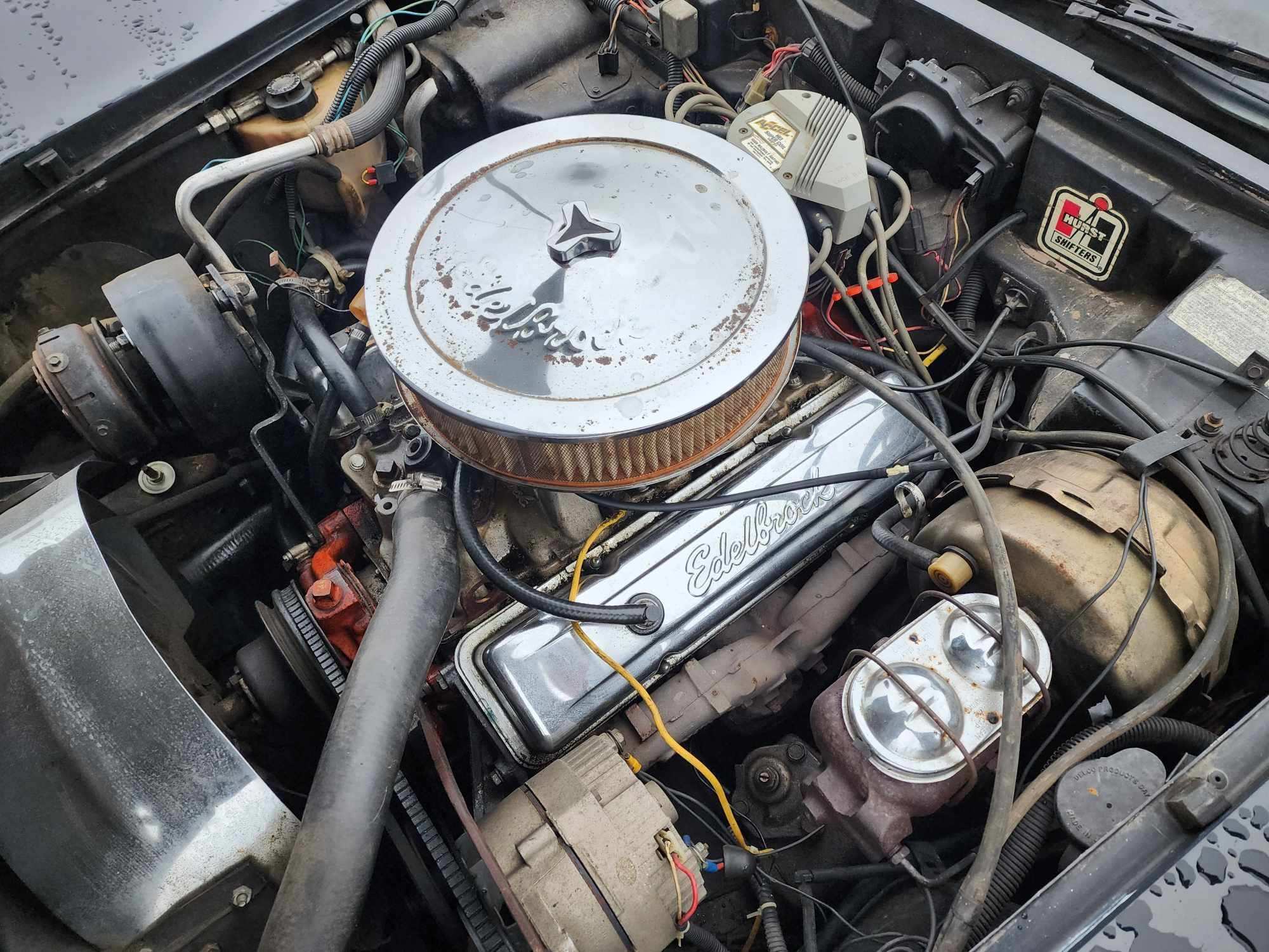

Originally Posted by Bikespace
Did you rebuild the Z-bar while it was out?
I'm impressed that you can do all of that: Sidepipes, pull the intake to inspect lifters, then reinstall without leaks, rebuild the carb, etc. etc. etc., and still not post a single clear picture of your engine compartment.
i did have to take it out and disassemble it i did a good job but i think i stretched my spring a little bit unfortunately i really gotta press my clutch down far now LOL. Thank you took me a very solid 8.5 hours of tedious work for those pipes but i got it done. Then im quite pissed about that whole lifter situation since it was all unnecessary, but yes i used all my good gaskets and some good ol sealant and it was a performer so that was easy. And my bad i dont take many pics of the bay its not the prettiest the old owner put some chrome valve covers and a cleaner that needs a new filter and both are pitting so its kinda ugly so i havent taken pics. But i will start takin more.
These are pictures of the bay from when i bought it. Tonight im gonna stop by the storage to get the battery(having some fun issues with that driving an hour home with all but probably 4 volts is real fun) so ill take some for yall.

Old Apr 9, 2024 | 11:42 AM
  #33
Piersonpie's Avatar
Piersonpie
Joined: Apr 2021
Posts: 2,714
Likes: 2,162
From: Minnesota
Glad to see it, can’t wait for more pictures.
I had my car in storage for about a year and a half only a couple months after buying it. Having only a couple pictures to go off of made it difficult to know what I was in for when I got it back out.
Take as many pictures as possible when you have the car, things like the engine bay, carburetor, suspension, wiper bay, and interior. They’re a valuable resource on the forum for other people trying to diagnose any issues you may be having, and for yourself so you know what you’re working with as you’re planning out your projects.
One thing to note from the pictures you posted. Your alternator bracket is on the wrong side of the alternator. Should be a pretty easy fix as long as the bracket isn’t too bent.
good catch! i didnt notice that ill fix it soon thank you! yeah i need to post more pics i just dont take many while i work LMAO ill start doin it more now

I know why people put the ALT bracket in front of the ALT "ear".
It allows more flexibility and range of motion when tightening the fan belt. Using a stud, nut, washer, instead of a bolt on the W.P. moves the bracket forward.
If the bracket is mounted behind the "ear", the ALT casing is almost striking the bracket.
