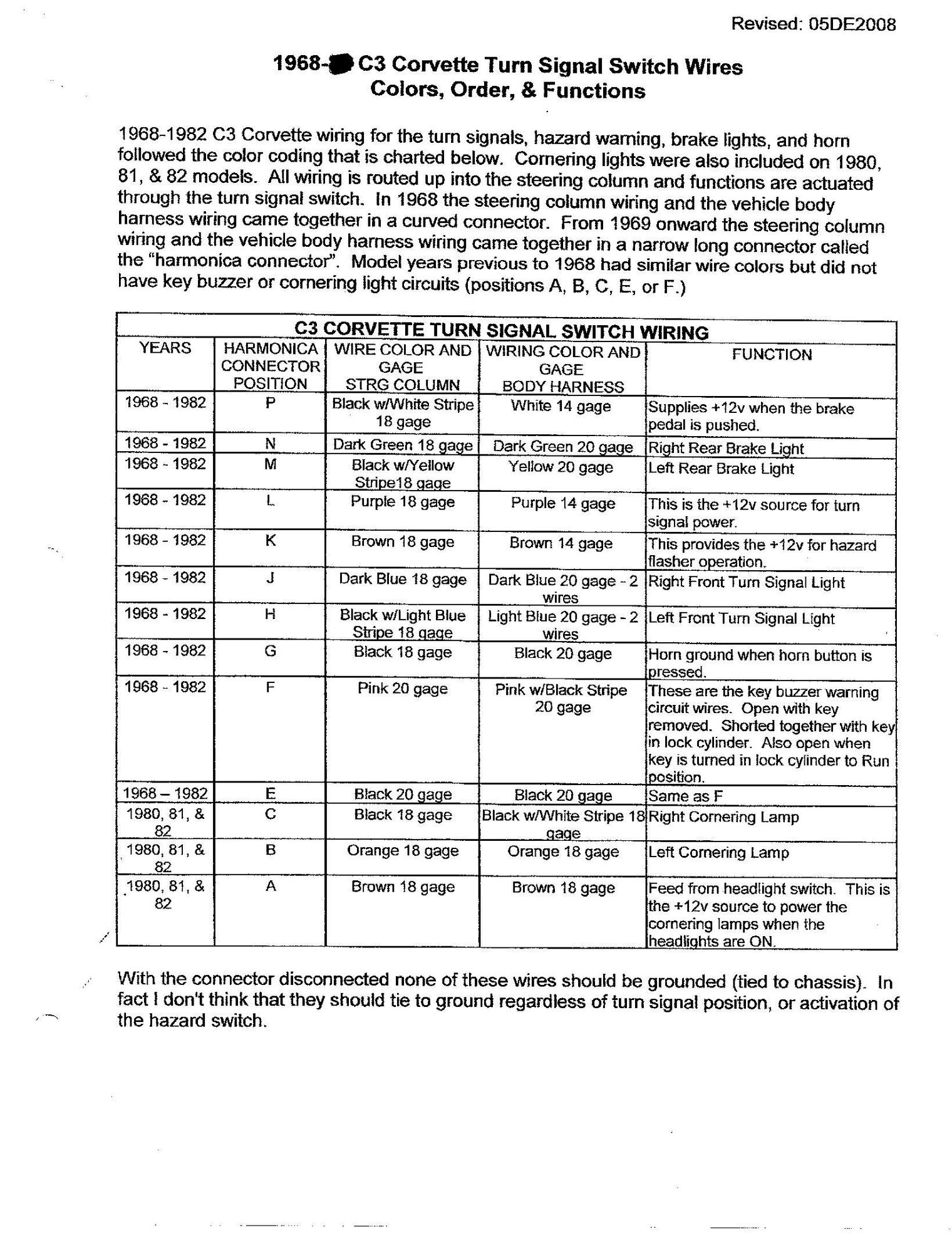

RF, RR and LR turn signals function normally, when a left turn is indicated the green arrow flashes as normal but the LF turn signal light just stays lit. Have verified the ground, bulb function and even tried a new signal lamp assembly to no avail and cannot find the turn signal wiring diagram broke out to refer to, would anyone happen to have one to refer to? My diagram ends at "turn signal switch" and blank page. Think it might be a switch? This would make sense if it did not flash but it does illuminate.

Are you asking for this?
Check the ground at the socket by running a good ground to the brass of the socket.
