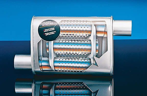

Just a little muffler tid bit here. A stock Corvette muffler has chambers or baffles, turbo mufflers on the other hand actually are packed with sound deading materials(unless it's a more expensive/newer style S-design those have perforated tubes and can include sound deading materials or sometimes not) turbo mufflers are called so because they were designed by GM to quiet the exhaust noise on turbo equipped corvairs. That material varies in different turbo mufflers, fiberglass or steel wool etc. Maybe your packing is shot. Pictures are just for a rough idea, mufflers do vary by make and model
turbo muffler
chambered
S type turbo
