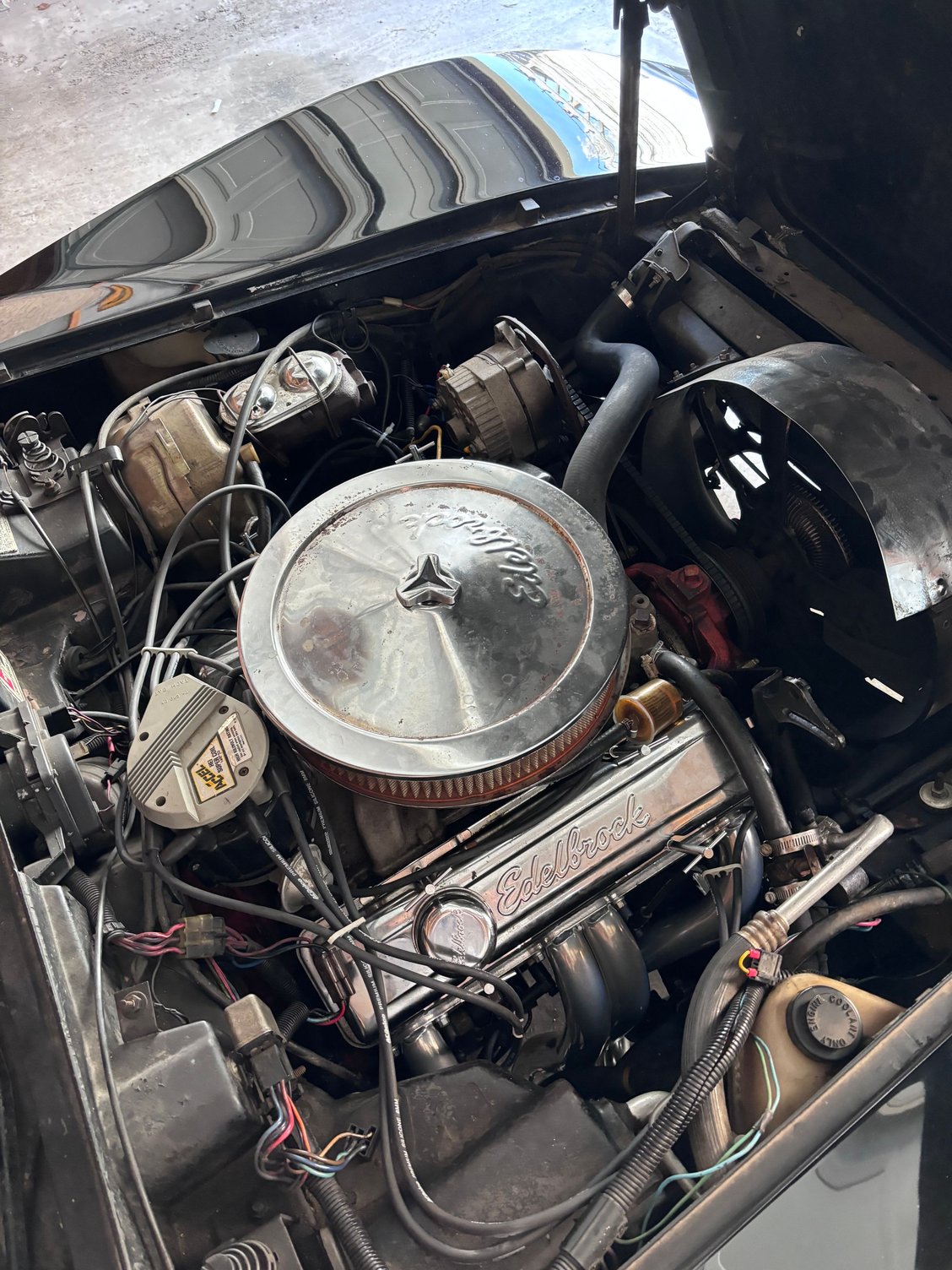

Hey guys,
here are two pics one from each side of the engine. Yes they are from different times and stuff has changed but the PCV system is the same in both. Does it look correct and like it’s set up properly? And yes i know it’s kinda crazy but i have side pipes with the least restrictive mufflers they sell so the oil doesnt have to travel far LOL. And it’s not much it was a drop or two but it also seems to be leaking out where the side pipes Slide Over the collector which leads me to believe theres a small puddle in there so its enough to really scare me here. I havent been able to measure how much ive lost since i just discovered it yesterday, but my dipstick says it isn’t much but its lower. When i did the plugs with the side pipes the old ones were a little black and the threads were a little oily. I already got a new valve so im gonna throw it in tonight. But my question here still stands could my PCV theoretically be the culprit? Or is my engine for sure really really hurt? What’s the order of operations i should do here?

Changing the pcv valve should answer your question

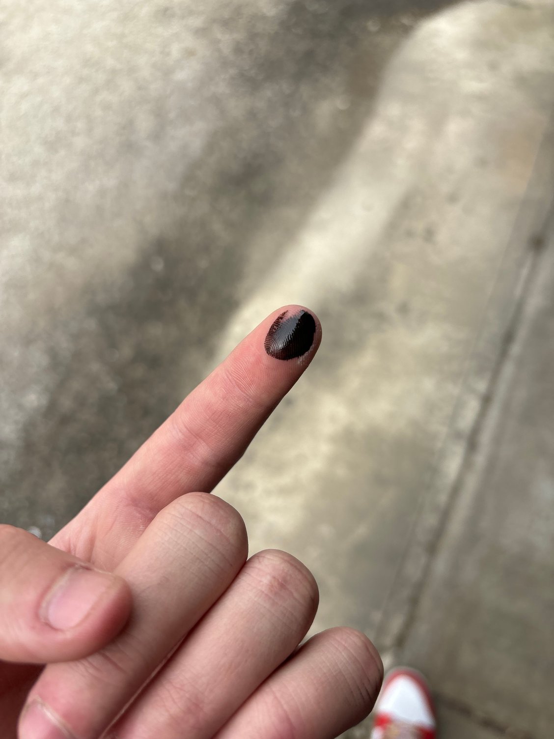

this is what it looks like on my finger doesn’t really smell like fuel and it’s quite dark.

Condensation washing out the soot?
possibly I think I’m all good changed the pcv and drove it no new oil problems

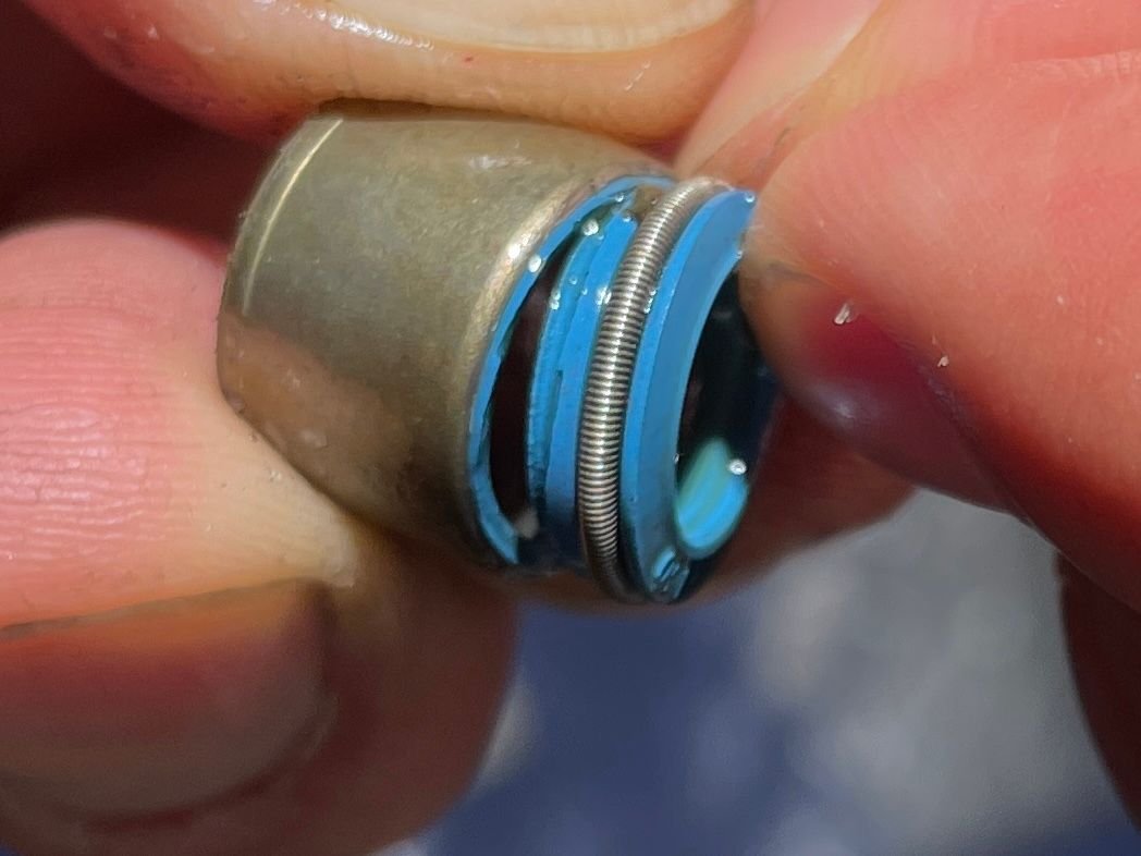

You may have a leaky exhaust valve seal. I had this problem on a rebuilt set of heads. I had oil all the way to the connection where exhaust connects to the mufflers. Did not burn blue. A slight grey like it was running rich. I was stumped at first, rebuilt heads with viton seals. My understanding is the oil leaking down the guide to the exhaust valve does not enter the combustion chamber but is blown out and not totally burned. So no noticeable blue smoke. I found two torn viton seals only on the exhaust valves. Replaced the seals. Problem solved. Still not happy with the rebuilder. Wasted a lot of time tracking this problem. You may have worn or no remaining seal on an exhaust valve.
Two of these viton seals were torn on two exhaust valves upon install. Oil in the exhaust. No blue smoke.
