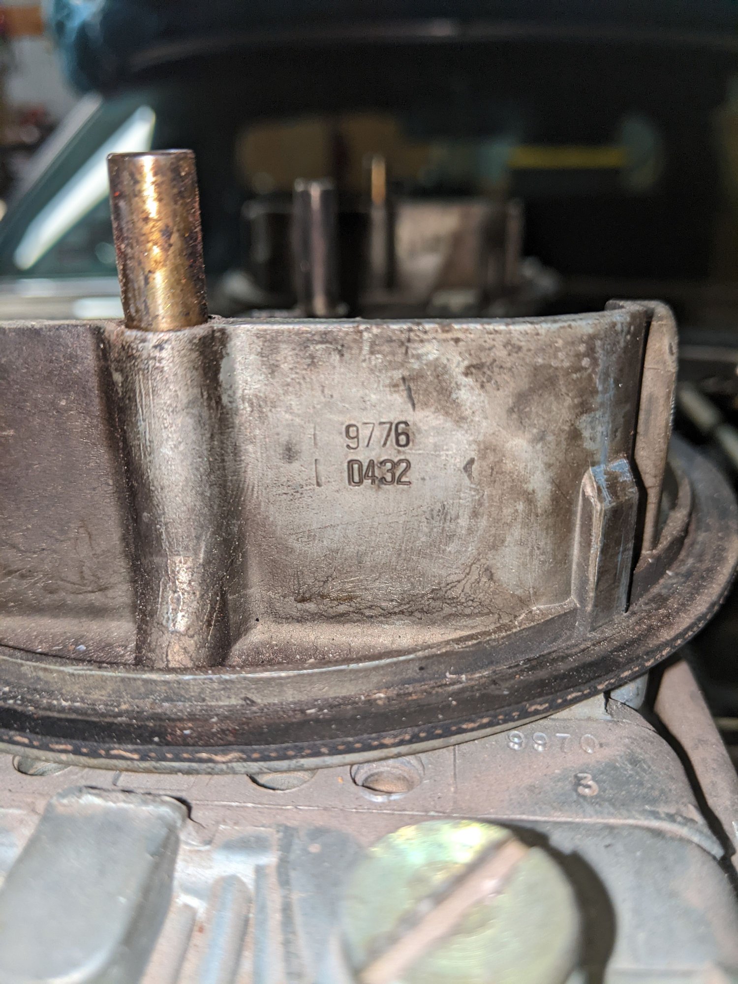

Old Apr 27, 2024 | 05:19 PM
Mdbirk's Avatar
Mdbirk
Joined: Jul 2022
Posts: 1,359
Likes: 822
From: Wisconsin
I replaced these

Old Apr 27, 2024 | 05:53 PM
HeadsU.P.'s Avatar
HeadsU.P.
Joined: Aug 2017
Posts: 8,336
Likes: 2,810
From: Cool Northern Michigan
First of all, Oh Dear.
Second of all, oh dear, that's a lot of CFM
The red umbrella type valve is a check valve. But would not, should not, could not flood the oil pan.
You have fuel spraying out the fuel bowl vent tubes.
Way too much pressure for the needle & seat to contain.
Or, you have pin hole in the bowl floats.
Or, that little "O" ring on the seat is leaking.
What size needle valve seat assembly? There are a few larger than stock options. Maybe that is the issue. The little window or port in the seat is too large for your app.
Update.
Just went back and looked. You do not have brass floats. So the pin-hole idea is out.
However, those black types of floats can get saturated. Then sink. Then the needle valve can't close. Then fuel gushes out the vent tubes.
