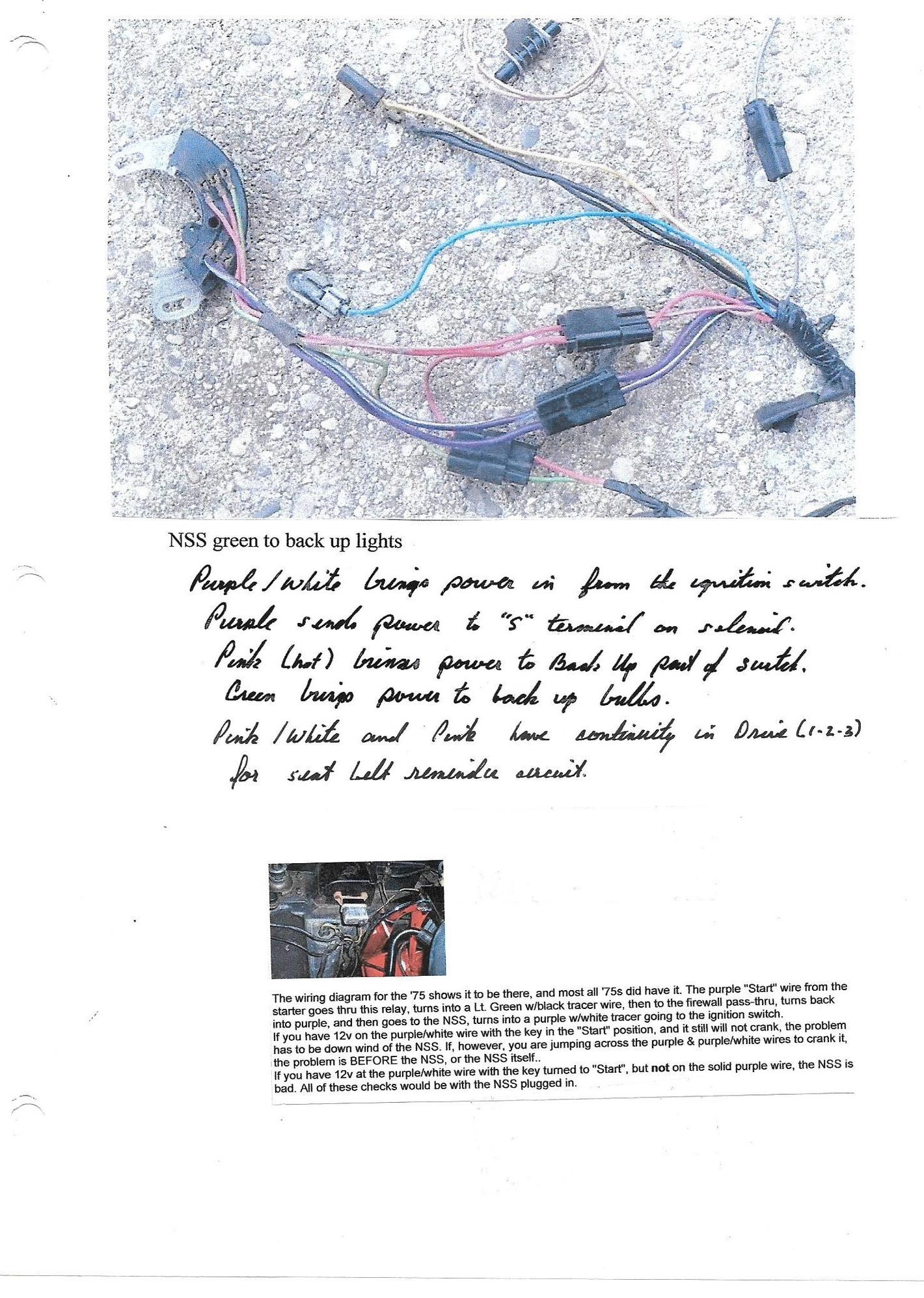

Disconnect the purple and purple white from the NSS switch.
Do the same test you did before.
Then post the results.
