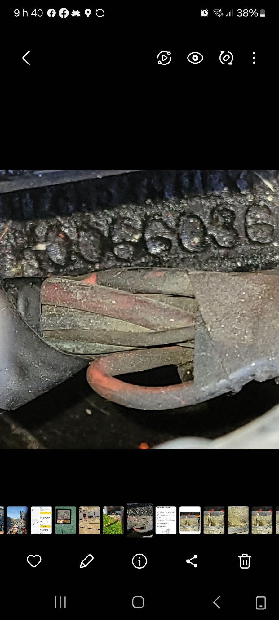

I just check and the engine is from 1989 encho mexico. No clue

Post some pictures! All the way around, with the air cleaner assembly removed. And of the front timing cover.
I think roller cams started on the C4 L98 engine in 87. I don't know when that trickled down to the hecho en Mexico engines.
Someone should be able to spot the difference in the timing cover. Hopefully.
