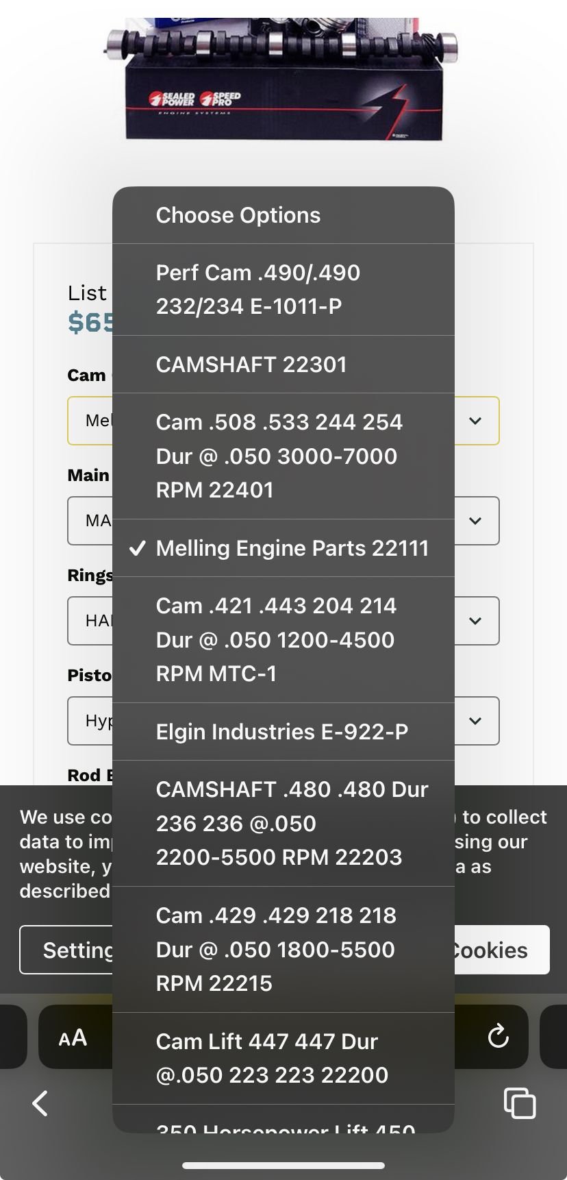

thank a lot, although to save money could I just grind out the stock heads for more airflow? I was looking at some forged rebuild kits and kinda am running out of money since I’m an 18 year old with a part time job. Also I found a possible kit but I’m completely lost since there’s a million cam options. Also 500hp is WAY above my expectations, I was thinking like 300-400 at most, I know if I have more I’ll probably drive the car like a maniac. Given my hp goal, do you still think all forged is a good idea? Would a stock crank suffice? I have so many questions about what stock parts can be reused and what I should get new so and info is welcomed.
in this image it lays out all the cam options but when I go to select one, almost all say .050, does that mean it’s oversized and I’d have to bore out the cam journeys and get bigger bearings? I don’t really want to do that so if that’s what that means I’ll probably stay away from them.

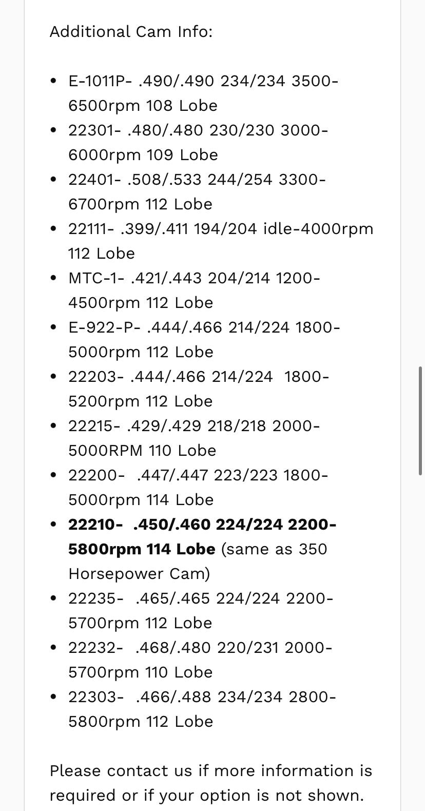

In regards to your statement about the cams being .050" that is the amount of valve lift where they start and finish measuring the duration of the cam (opening and closing events). its a pretty much universal guideline that most all cam grinders use to make it easier to compare camshafts to one another. it has nothing to do with the cam being "oversized" and machine work needed to make it fit.
