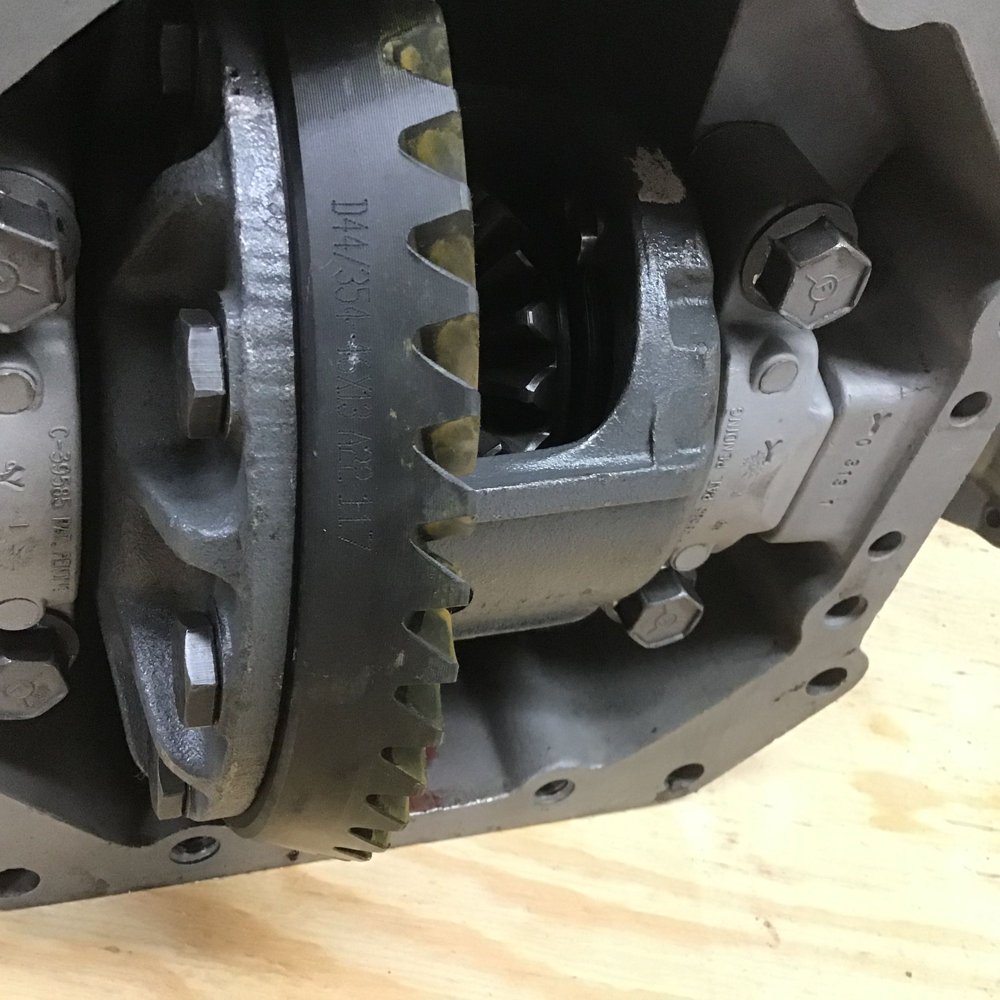

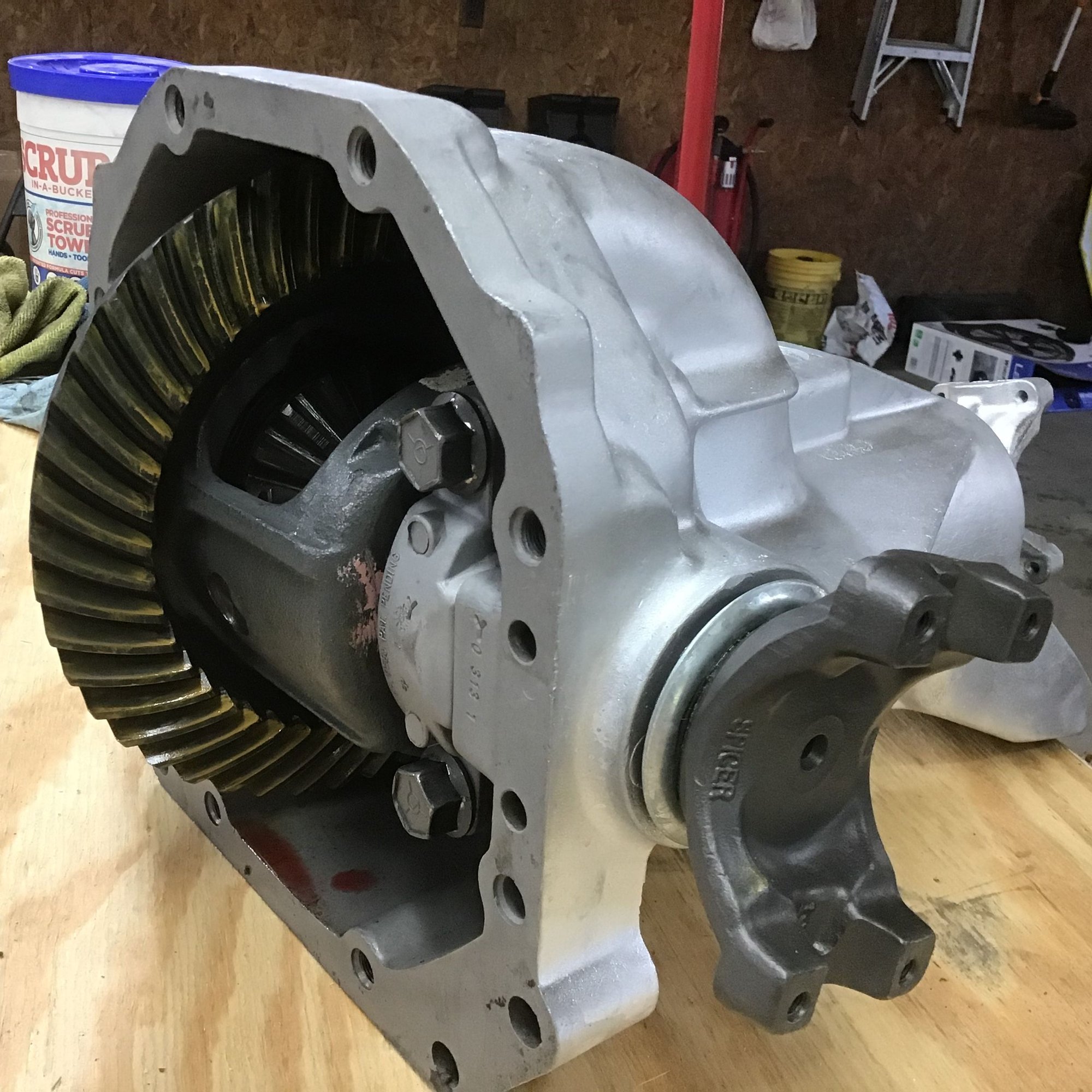

I live in a small town in SC, and don’t have a lot of shops here or close by that I know of that could or works on corvettes,so after a few months of trying to find someone,although have never messed with rear ends and although I wouldn’t say I’m a mechanic I do and have worked cars a little the last say 40 years,so,I am comfortable working on them,so,I already have a new aluminum differential in a box with 3.54 gears,has 2.87 now,so that shouldn’t be to hard,just a swap,but plan on replacing trailing arms also,which is where things might get complicated,so what to expect if I do it,oh and I don’t have a lift,so will be on jack stands,what kind of special tools would I need? Any issues getting old bearings out of trailing arms.

I don't see a spring pack in that diff, so I assume Duntov is trying to copy Gary's work. If I were you I'd check every clearance in the unit before I installed it.
The Dana didn't use the spring pack like the Eaton or earlier DANA. I agree 100% checking things though especially given the past history of the rebuilder.
