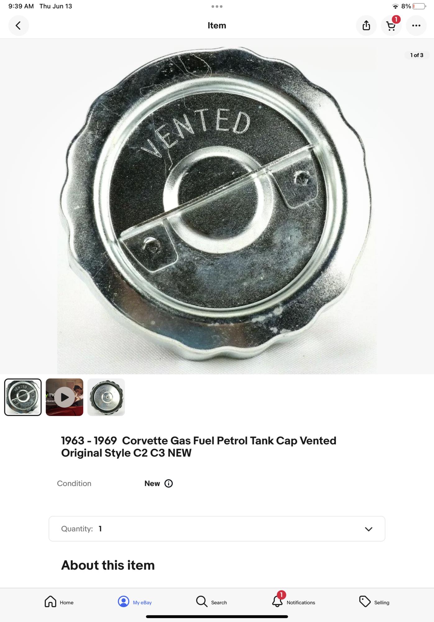

Took the car to a show that was about a 1/2hr drive away. Idle did drop to about 500rpm but didn’t see the fuel pressure drop and it wasn’t threatening to stall. When I got parked I cracked the fuel cap and saw no issue with it venting.
The new cap is doing its job. I think that the old cap not venting was at least part of the problem.

The Non-functioning vent in your gas cap would cause too big of a vacuum in the tank for the pump to pull against.

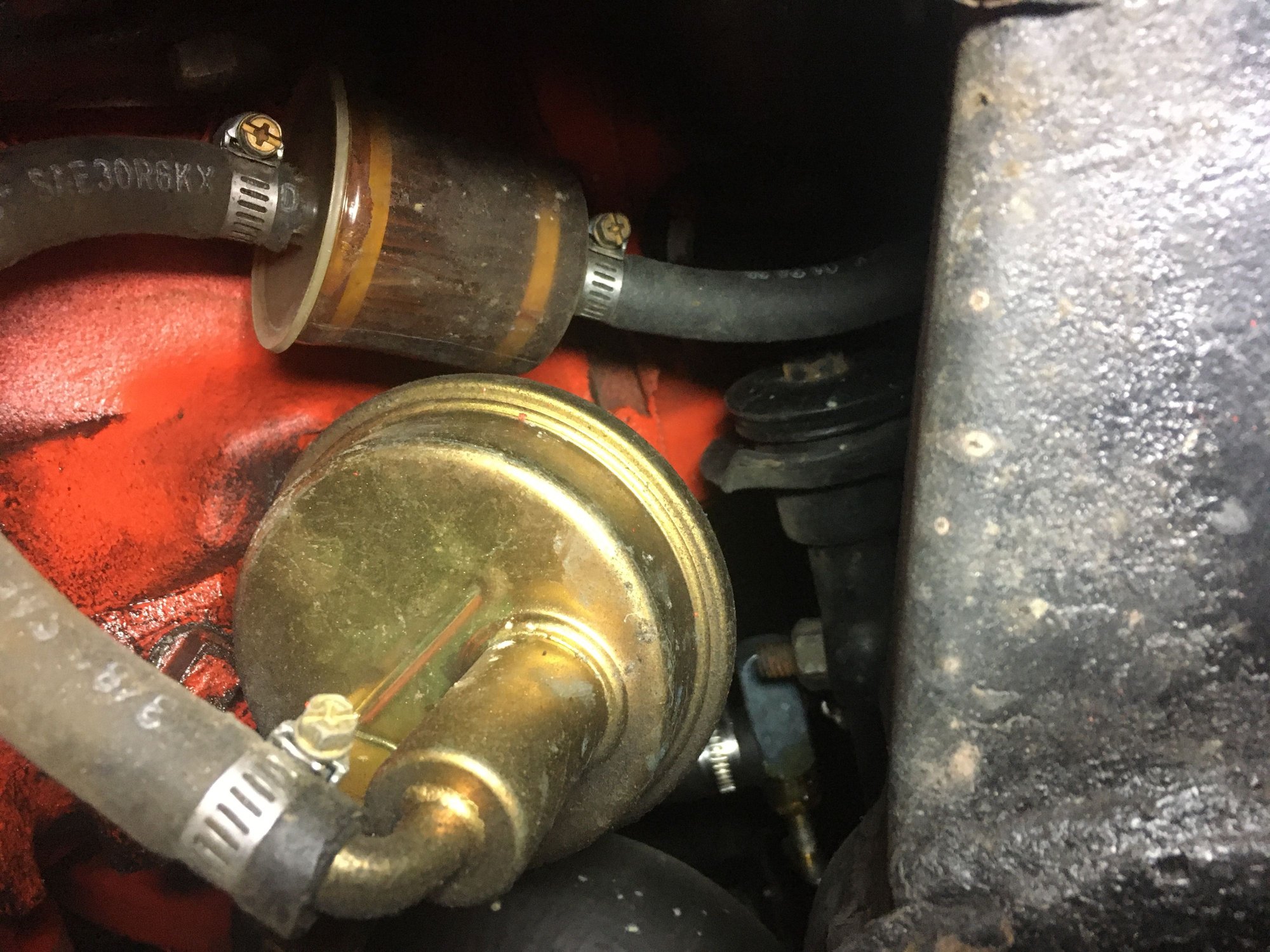

I removed the NAPA can filter (10 micron) that was installed inline just before the fuel pump. Note I know they are supposed to go after the pump but my car has the 3 two barrel tri-power set up and they dont have that filter after the pump rather 3 small filters in each carb inlet. Not thrilled with that and don’t want to mess with them. The car came to me with a plastic filter before the pump that was filthy so I elected to replace it but with a metal can because of its proximity to the exhaust manifold. This was to be temporary until I knew all the crap had been run out of the system.

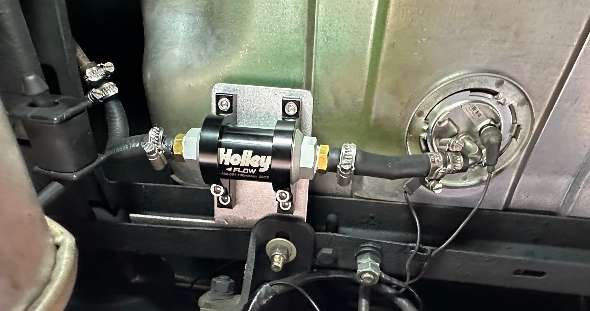

Ok so theres no filter there now like the factory had it. I did mount a “pre”-filter made for this purpose by Holley back by the tank. That filter is a 100 micron, is freer flowing and is designed to be installed “before” the pump. I had also installed an Autometer fuel pressure gauge on the the steering column to monitor the pressure before I changed the filters. Note the fuel pressure gauge is electronic with a sensor mounted on the line, it is not a mechanical gauge.
I’m happy to say this all but cured the problem.

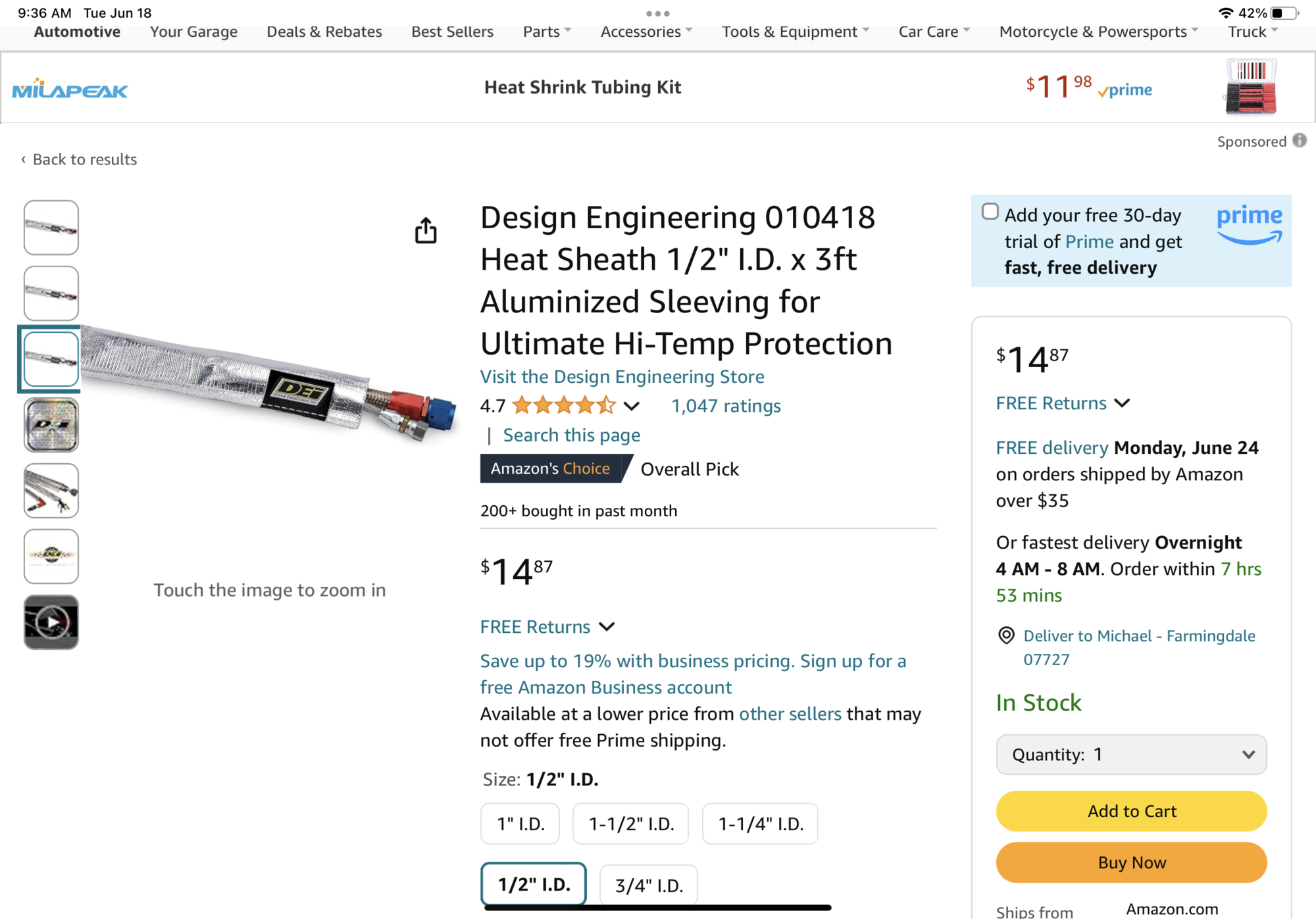

I am considering buying a thermal fuel line wrap for the where it runs thru the engine bay.

This what was there when I brought the car home and was replaced with a metal can filter. Safer but still wrong…

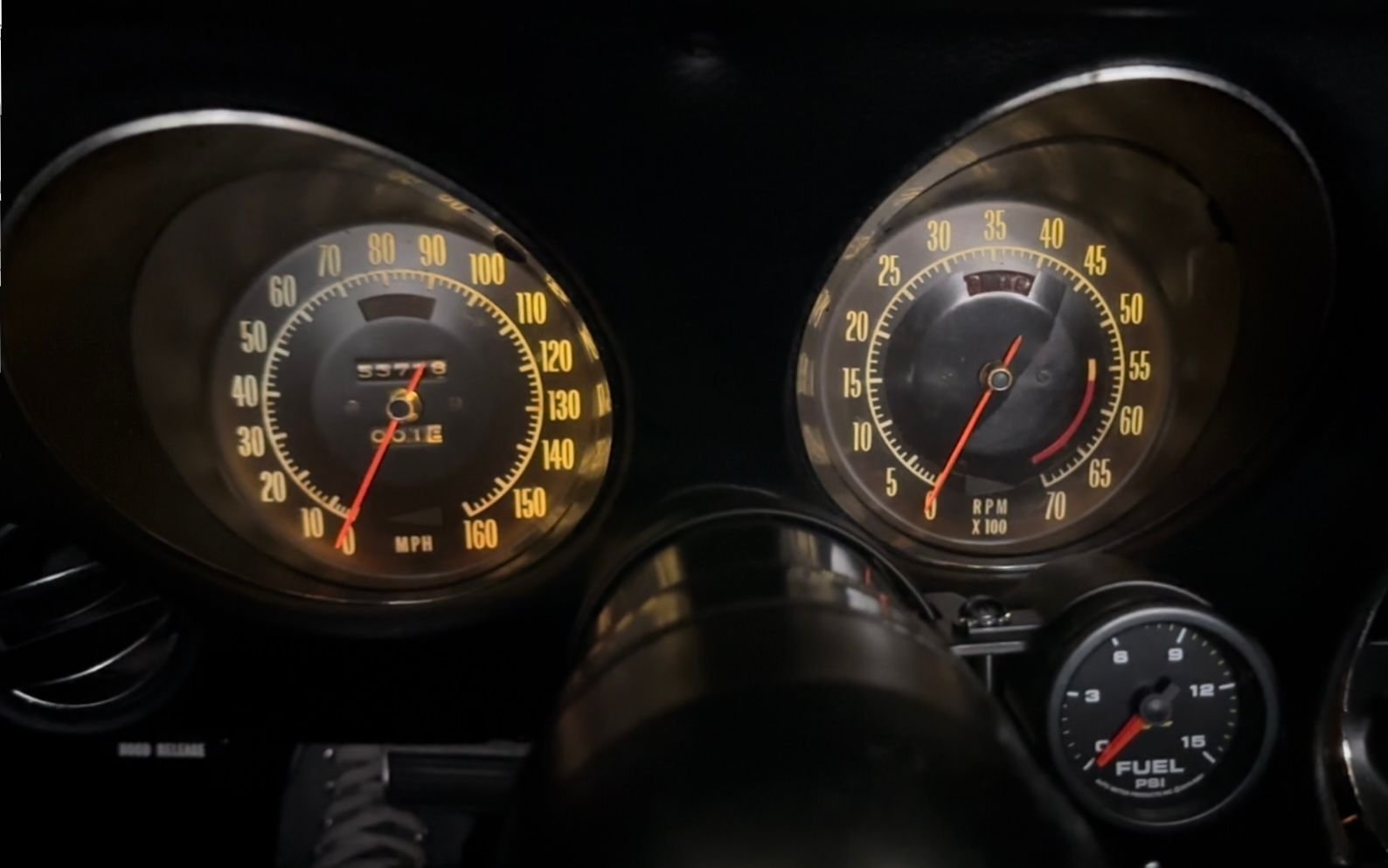

This is the fuel pressure gage installed…

The cap on the car wasn’t venting so I replaced it. Did it help? Well it didn’t gasp for air when removed like the old cap did but merely changing the cap did’t seem to help the idle issue.

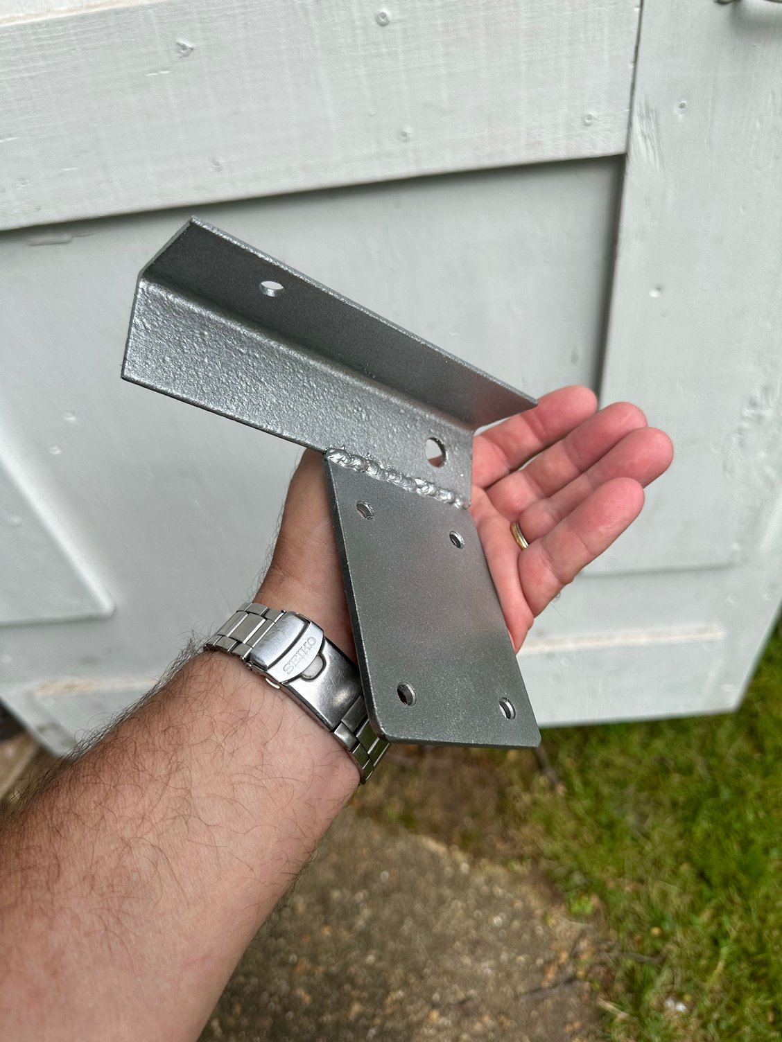

I fabricated a bracket to mount the new fuel filter that utilized existing bolt locations in the rear frame.
The filter installed…
This is the thermal wrap I’m considering using for the lines in the engine bay…

that thermal wrap should help...I run a line out to the front of the radiator and have a passive fuel cooler out there. I want to install a small one with a fan eventually to keep the fuel cooled efficiently. I have a similiar setup with a fuel shutoff at the tank in front of the rear filter so I can remove it to empty the filter and another in the front after the the pump so I can keep the fuel front syphoning out the of the bowls when I clean the front filter

You were probably drawing too much vacuum on the supply side of the pump, and bam it went to vapor.
You got rid of two restrictions there, the 10 micron filter, and the no vent cap, good move.
You still have a 100 micron filter there, but that is not considered a vacuum restriction.
10 micron filters go on the pressure side of the pump.
I like your elec fuel psi gauge setup. Nice!

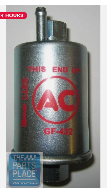

I like this AC Delco GF-90 screw-on version for single fuel line cars:
It looks fairly correct mounted vertically in front of the water pump.
Some of the the Q-Jet cars and some of the AC cars used this one including the 390HP 427 cars. GF-432 or similar, with a vapor vent: in the same spot.
