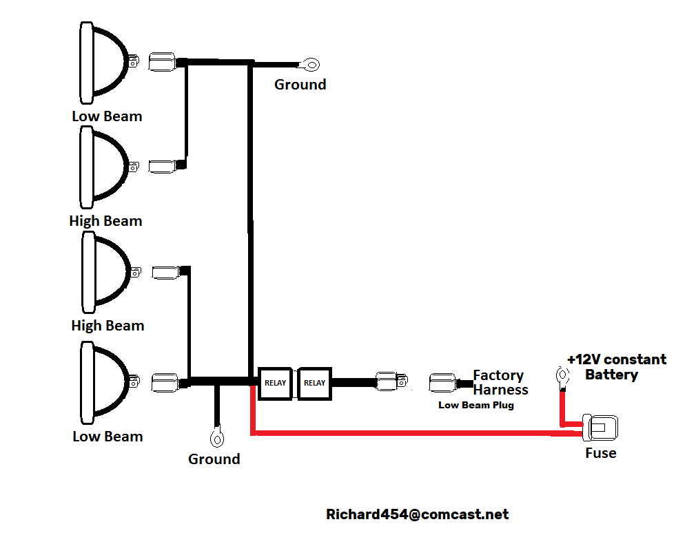

Here's an overview harness done right- fused AT the source of power-battery. Using this - the headlight/dimmer will see less than 1/8 A (.125A ) of current.

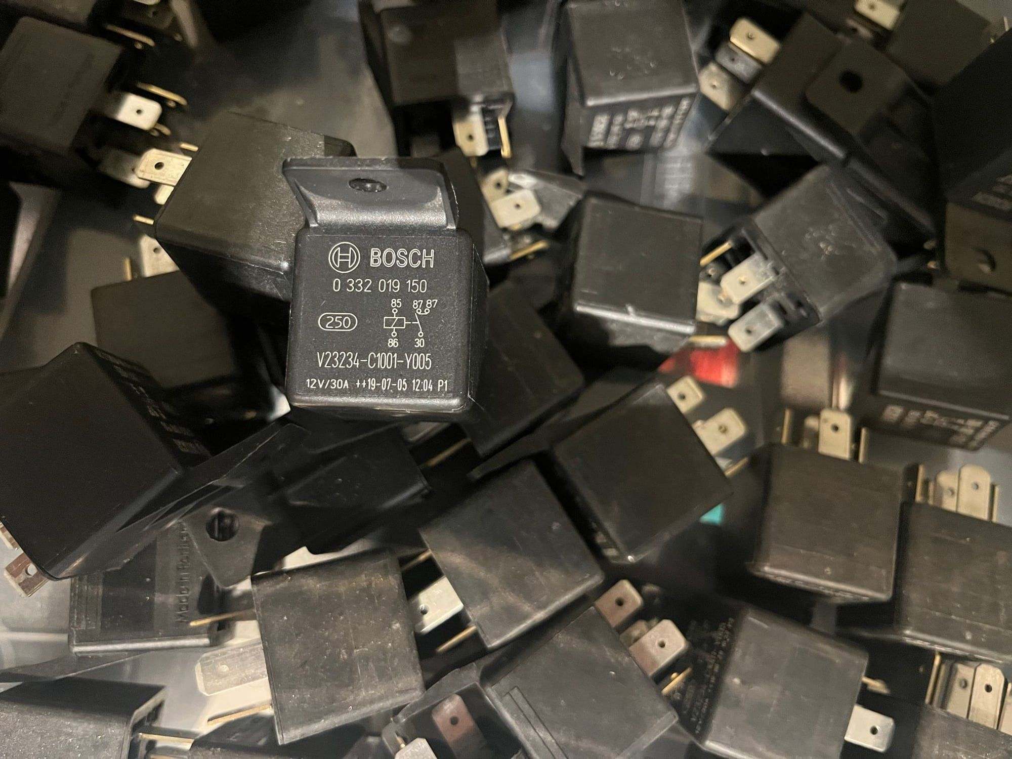

A really clean way to do it- less wires spliced by using a Bosch "Fog light" relay-
It has two switched output terminals rather than the common relay with one.NC and the other one NO
0 332 019 150
Summit Racing has them for $4- made in Portugal- and MUCH better than the Chinese junk out there
https://www.summitracing.com/parts/bch-0332019150?
here's the relay-

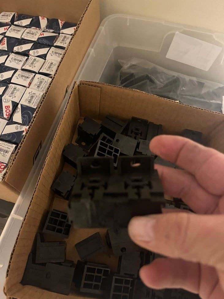

A relay holder- made by Bosch- won't melt like the Chinese cheap stuff-

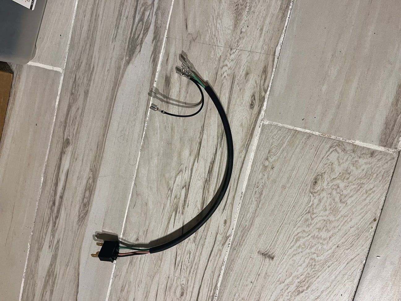

I use a male connector- so you don't have to cut up the harness-

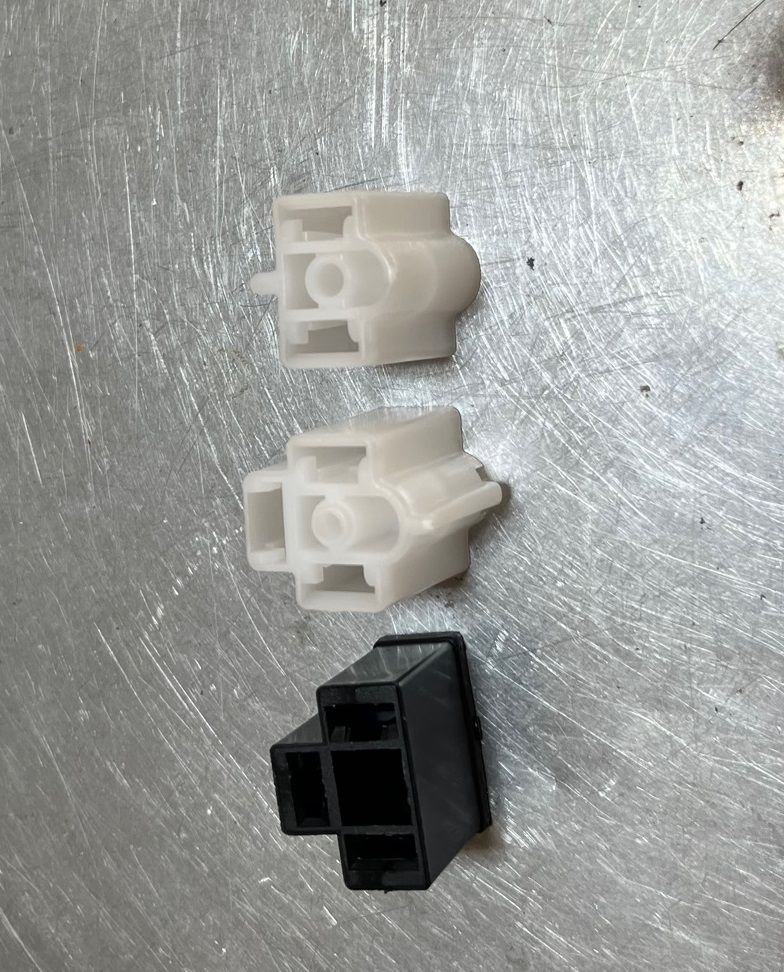

And for the connection- there's different types- cheap Chinese black one or the Delphi which handles the fiberoptics 68-71
2 wire- high beam Delphi 6288472 3 wire high beam Delphi 6288471
