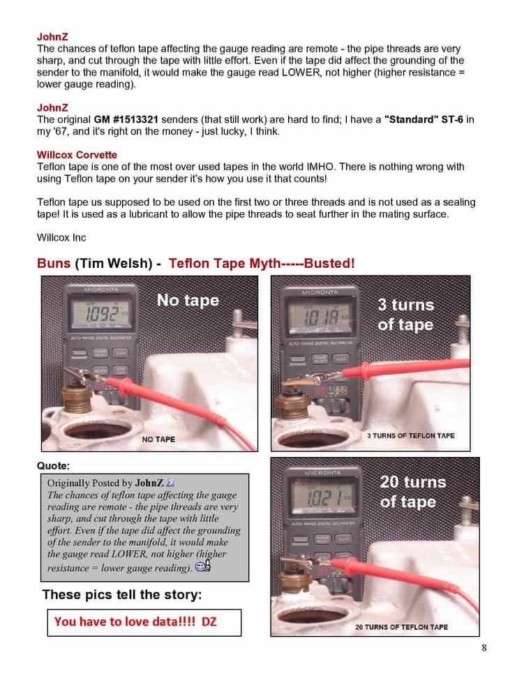

Do not put teflon tape on the threads.

Maybe that's the issue. I'll try to correct it tomorrow and see if it makes a difference.

Use of tape
Old May 21, 2024 | 07:43 AM
Bikespace's Avatar
Bikespace
Joined: Mar 2017
Posts: 11,953
Likes: 4,509
Originally Posted by BKarol
Use of tape
Nice find! I'm saving this one...
Isn't there something the OP can do with the resistor on the back of the gauge? I have not found a spec sheet for any one-wire senders being sold now, so there's really no telling if the replacement sender is correct, or has the same issue.
