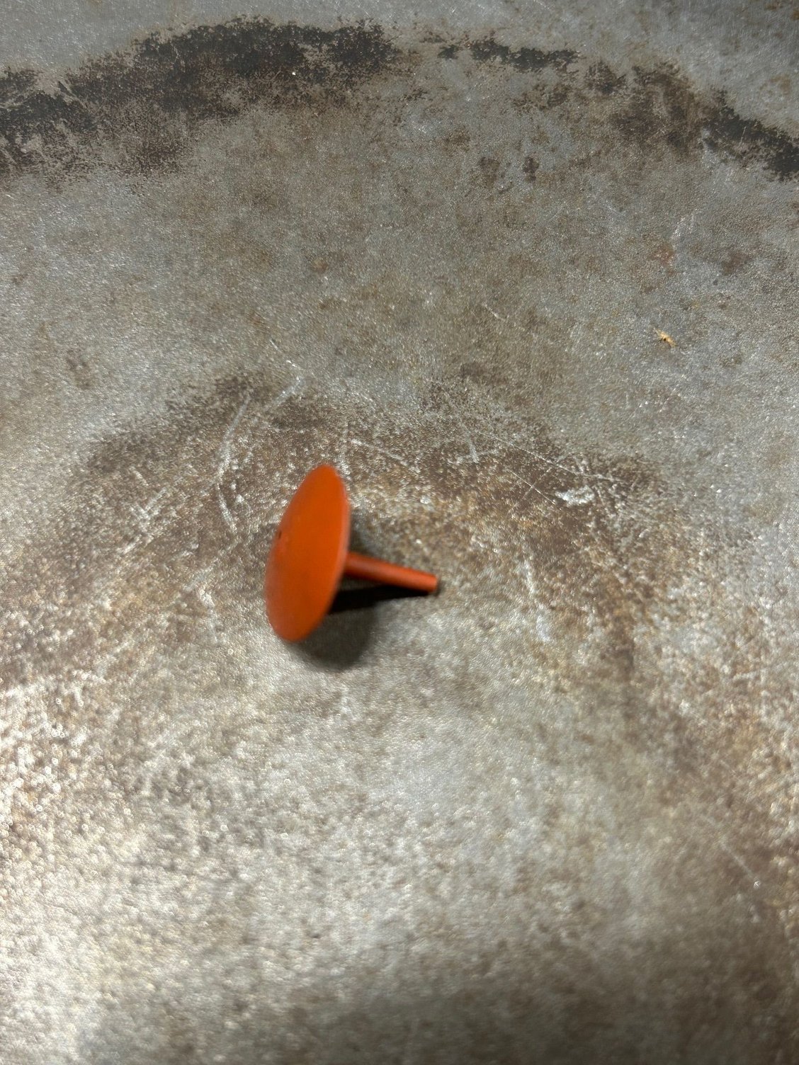

I ordered a Holley 4555 rebuild kit from Zip and rebuilt the carb on my 1970 LT-1. I had the following part left over. What is it used on?
Thank you!
James

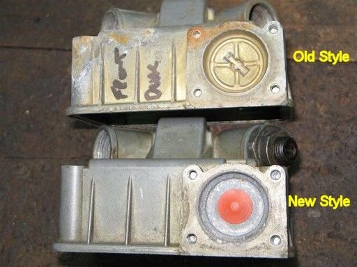

The part you have left over is the front accelerator pump check valve used on a newer Holley. Old Holleys use a steel ball. There is a measurement/adjustment for the travel of that ball. If the travel is too great, you could get a hesitation in the accelerator pump circuit.
I was chasing a hesitation in throttle response, and that was one of the things I checked. Mine had too much travel. A slight tap on the retainer closed up the gap.
It didn't fix my hesitation.

Barry,
Thank you for the help! Yes, I have the old style and I checked the travel of the ball.
