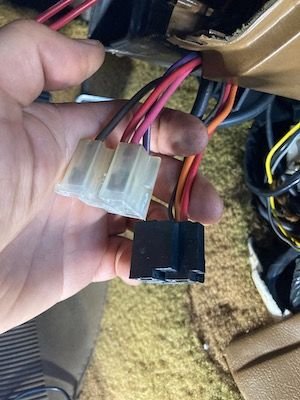

I think I just got seriously skooled. I took apart the console and unplugged the neutral safety switch. Checked both purple wires on the connector heading under the dash for short with ground. One wire showed no conductivity and the other showed 0.2 Ohms - so full connection with ground. I disconnected the plugs to the ignition switch (there are two) and the purple wire showed conductivity with one of the purple wires in the plug to the neutral safety switch and no conductivity with ground. So I traced the purple wire with conductivity to ground all the way to the solenoid terminal on the starter. So the solenoid terminal on the starter is a ground? I didn't know this....
Can someone tell me what are the wires in the second plug in the ignition switch? There are three wires red, orange and black. The orange and black appear to be connected.

Wiring diagrams below. You have opened a can of worms now.
Before you break anything, Did you check for voltage sag when cranking the engine? Dirty contacts, or failing cables, will cause the voltage to dip.

Yep worms everywhere. Multi colored worms and vacuum hose worms. I thought I had found a massive short, but it was just the solenoid coil to ground. Almost everything I have learned has had severe pain associated with it.
