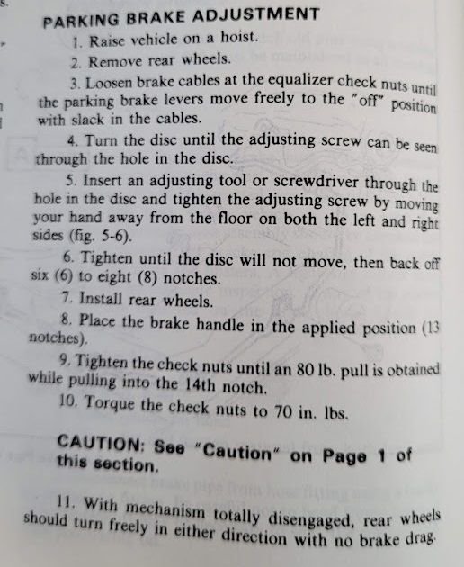

OP: There's a specific procedure for setting the parking brakes in the shop manual. Did you follow it? I use a fish/luggage scale and some 550 cord to do the 9th step. There's also a separate procedure for burnishing the new pads on the road.
