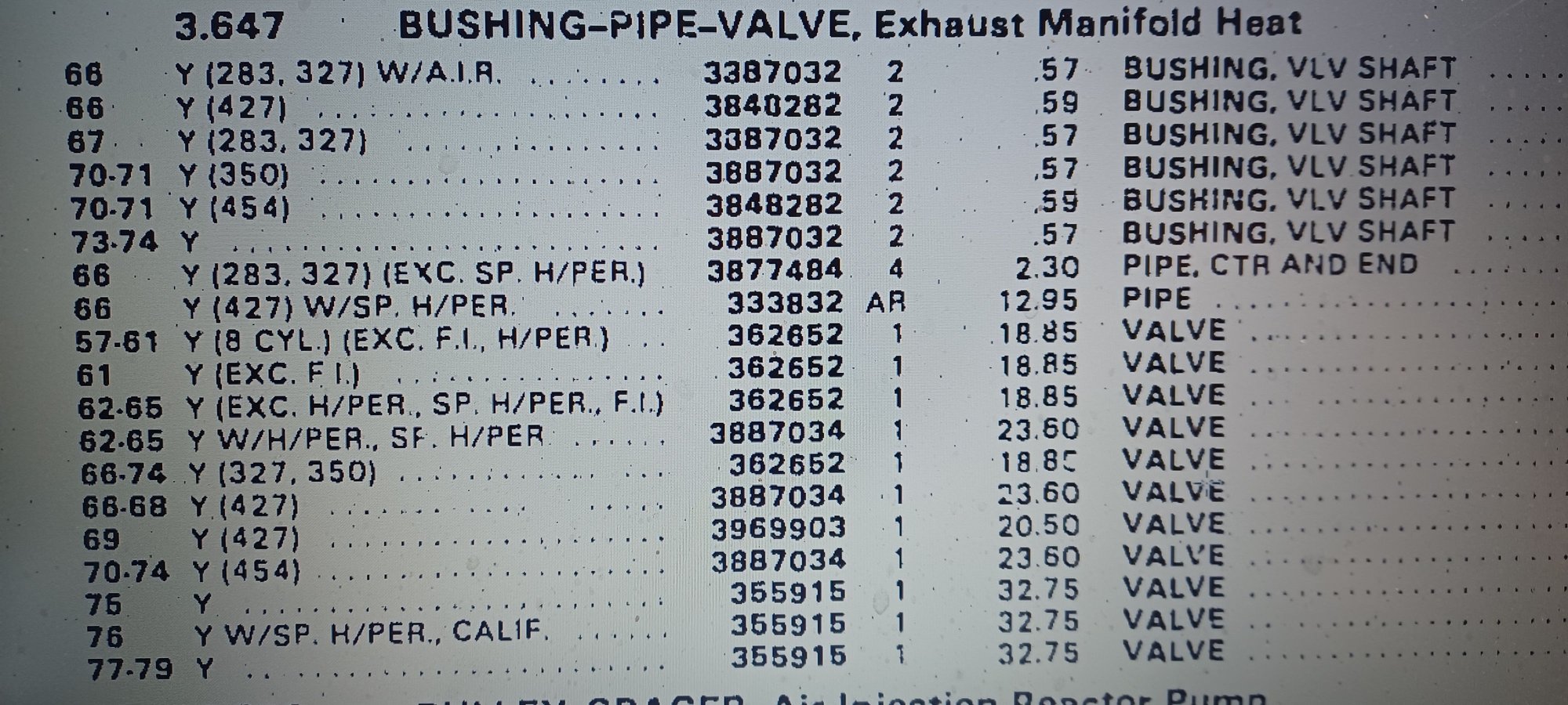

15-6844 is this heat riser valve for a 75-79 vette?

I don't know where you found that number...
My parts catalog comes up with #355915 75-79

GM part #355915. gm 355915 exhaust manifold valve

Part number recommended seems correct.
