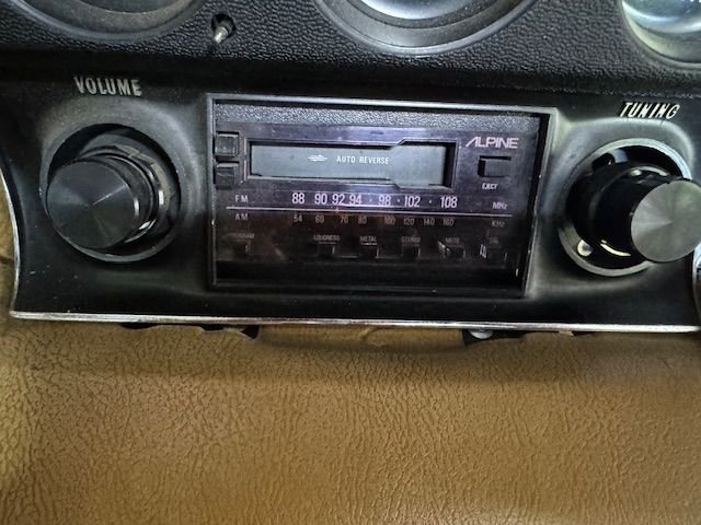

I have seen a few older posts and need some epoxy/gorilla glue experience. I am replacing my radio, and the front of the lower console just below the gauge cluster/radio was not fitting right. See the picture. After getting it out I could see the front lip was cracked and held on by the rivets/vinyl to the front reinforcement bracket.
1968-1976 Corvette Shifter Console Front Reinforcement (zip-corvette.com)
Inspecting the rest of the console, I see a crack/partial split along the console's length front to back on passenger side.
Do I have any options with epoxy? Would it hold?

Al Knoch might turn up better search results I think Ctmmccloskey misspelled it. Most of the stuff others like corvette america sells is his stuff as well. I bought my Al knoch door panels from corvette america on ebay for $400 new shipped for the pair vs buying them direct for close to $600 at the time.
honestly the pictice shows what just might be a console thats missing the 2 nuts that hold it tight againt the dash bezel... Mine looked exactly the same as someone replaced my radio and didnt replace and tighten those retainer nuts that bolt on to 2 threaded posts coming from the bottom of the bezel. Keep in mind the reproduction stuff rarely fits as well as the real panels. I used 2 large washers to help distribute the hold after reassembling. I did glue a crack in the console body as well which is completely unnoticed since the vinyl covering was fine. My door panels on the other hand were a lost cause.

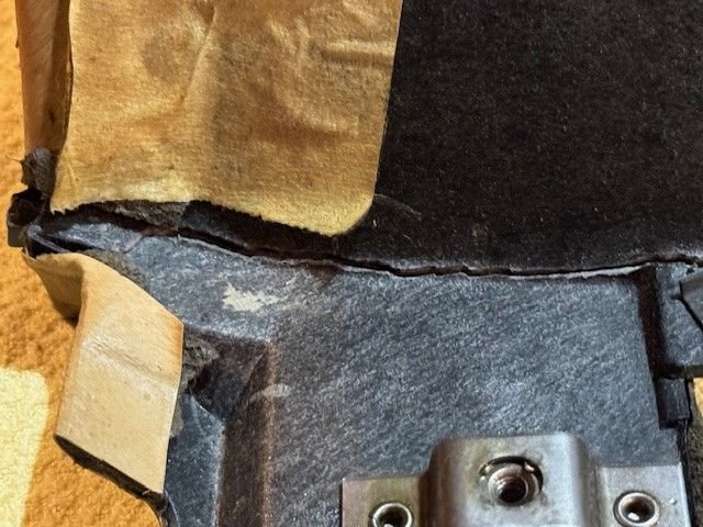

Gentlemen, very helpful. Here are two more pics and the bracket I linked above was riveted to the console and the two nuts you mention were not there when I took it apart. I think the previous "stereo installer" tried a bubba fix. You can also see the piece that is broken off because of the rivet job. You think it is beyond any kind of plastic repair?
The other photo is the crack on the passenger side. Likely from stress and the above bubba fix.
This is the front lip of the console with the bracket riveted. Screws to gauge cluster missing.
This is the crack along the side of the console.

Thank you augiedoggy for correcting my Misspelling of Al Knoch's name! I apologize for my error. I also use some fender washers on the hardware up front as well as it spreads the force and makes it seem more secure.
The crack you show in the last picture can be fixed without too much trouble. A good quality two part epoxy like JB Weld could fix it for you. You might consider putting epoxy in the crack and then put some fiberglass tape over it and apply some resin to harden the fiberglass. Even window screen material could be used under a layer of JB Weld to really beef up the repair.
If I were doing it I would probably Hot Air weld and re-enforce the area with the stainless steel screen material they make for fixing big cracks. It all depends on what type of plastic it is made of. My Air welding kit has probably 20 different types of plastic welding rods for the various types of plastic. It has helped me fix some expensive parts and bumpers on the newer cars and even my Pond liner!

That material they used looks different than a lot of plastic so I would clean and then sand the plastic down before using Epoxy. There are hundreds of options when it comes to glue, I have a collection of repair kits that come with white Micro-balloons and some crazy glue to harden it.

I decided to order a new console from Zip.
I called Eastwood and they did not think the welder would be that effective in this case. The plastic overall is quite brittle. After further diagnosis, the front lip was broken because whoever put in the other stereo removed the two studs from the bottom of the gauge cluster. They also put the bracket in backwards and when pulled so that the side mount screws would fit, it broke the lip.
