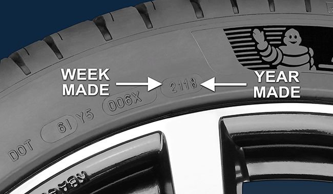

How old are the tires? Perhaps a belt separation?

No idea about the tire age, I’ve read that before, I might swap the front tires and see if the problem moves

sunflower 1972's Avatar
sunflower 1972
Joined: Sep 2016
Posts: 2,213
Likes: 970
From: Wauconda IL

Ill looking at that this morning along with swapping the front tires to see if it moves.

I do something I call Laying of the Hands. Jack up the car and feel the tire for bulges, separation etc. If you feel a thump while driving, you will feel it upon inspection. If the tires are anywhere near 10 years old, get rid of them. Jerry
