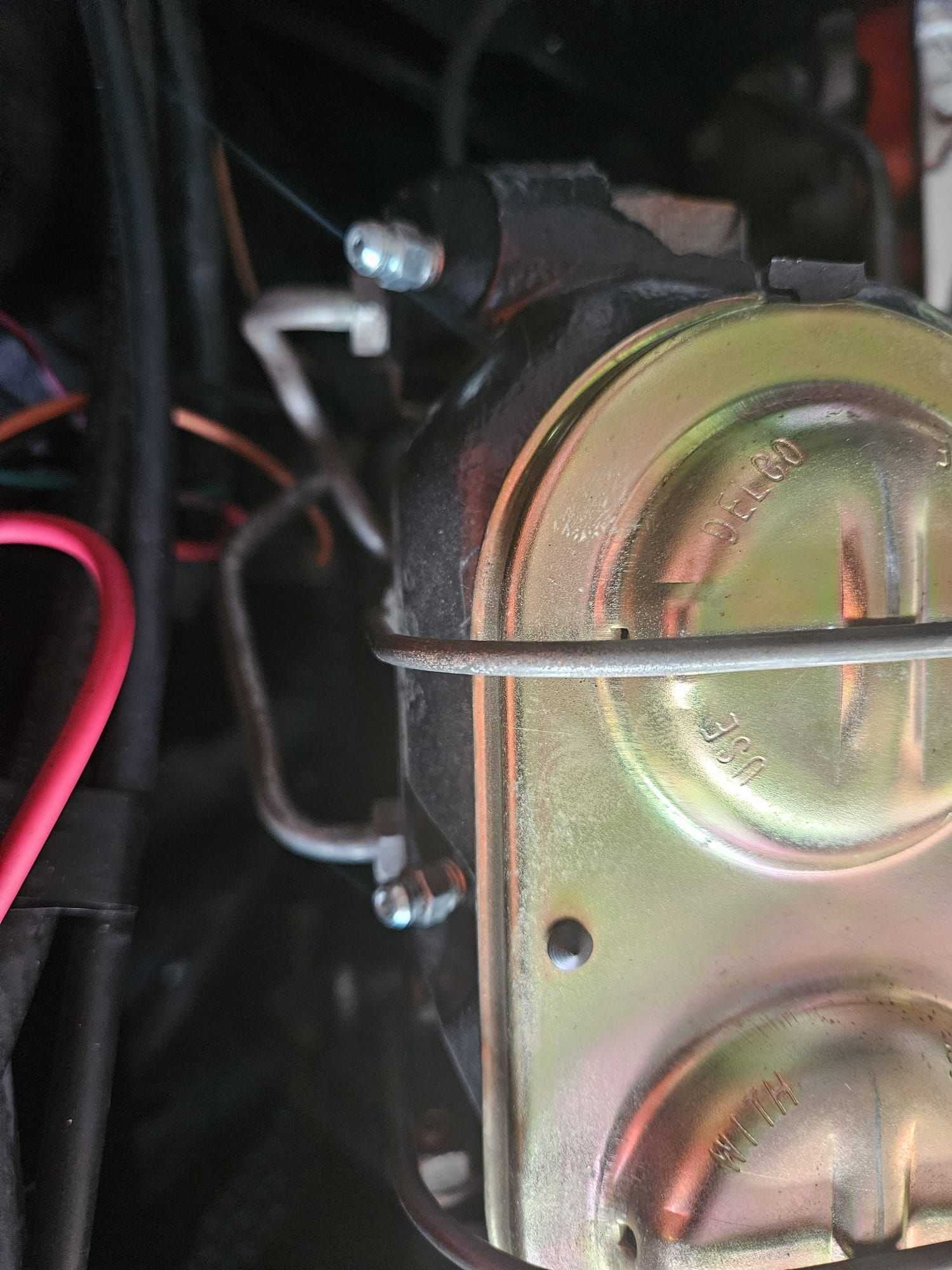

Here are the fittings I was thinking of. So these are bleeders?
Old Jun 28, 2024 | 07:57 PM

Originally Posted by SteveG75
Those aren’t grease fittings. They are bleeders. If you inject grease, you will be rebuilding that master cylinder.
I guess my real question here is. Is what I am facing right now worth putting it in the shop which would amount to the rest of the summer, or is it not serious enough that it can wait until winter service???
Yes, those are bleeders to purge the air from the master. Many replacements did away with them, but Corvettes had them from the factory.

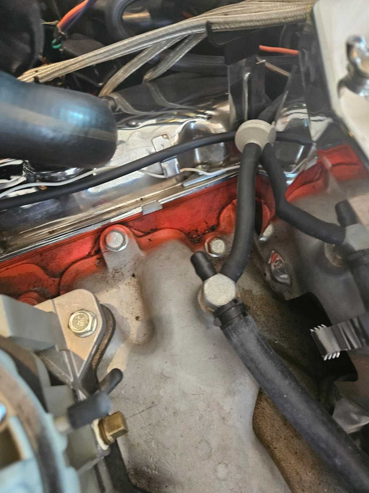

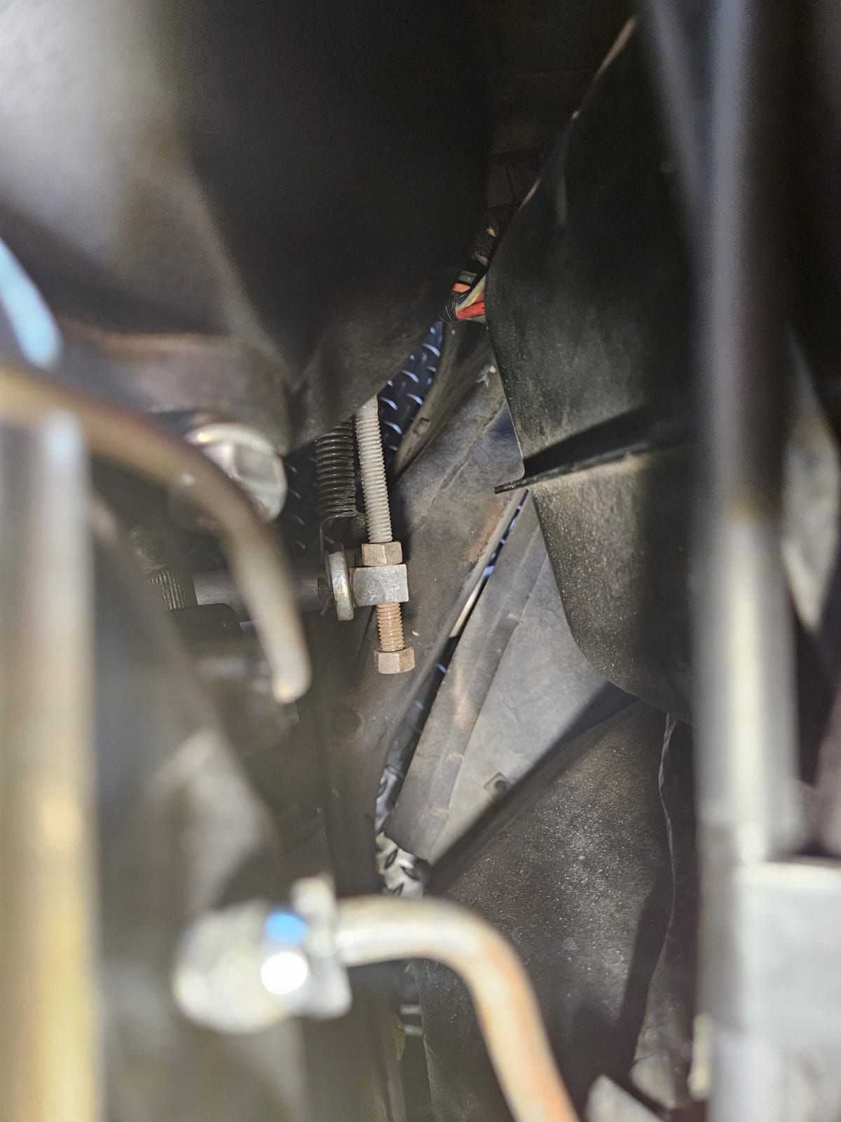

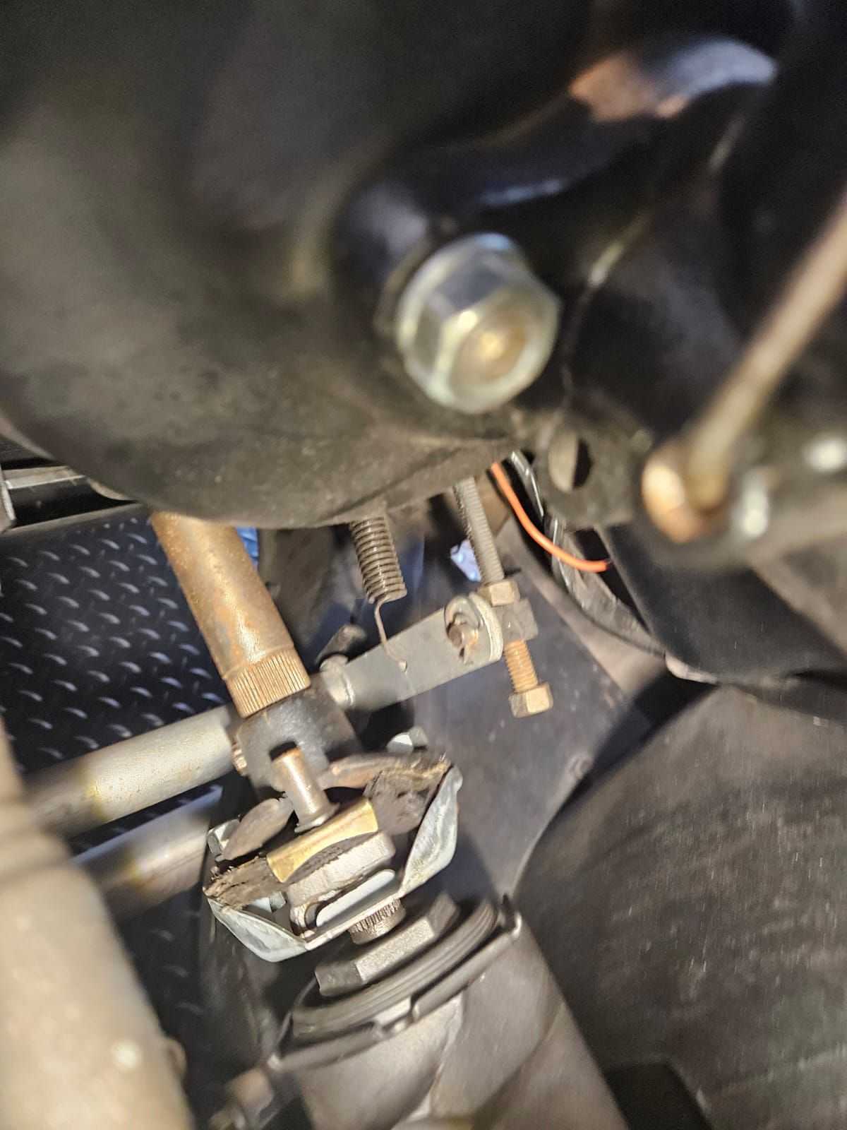

Here are pictures of the vacuum path to the brakes - it does hook to the engine. And some pics of the brake mechanisim from the pedal -

Not sure how I would separate them unless I disconnected it. Is that what you are thinking??
